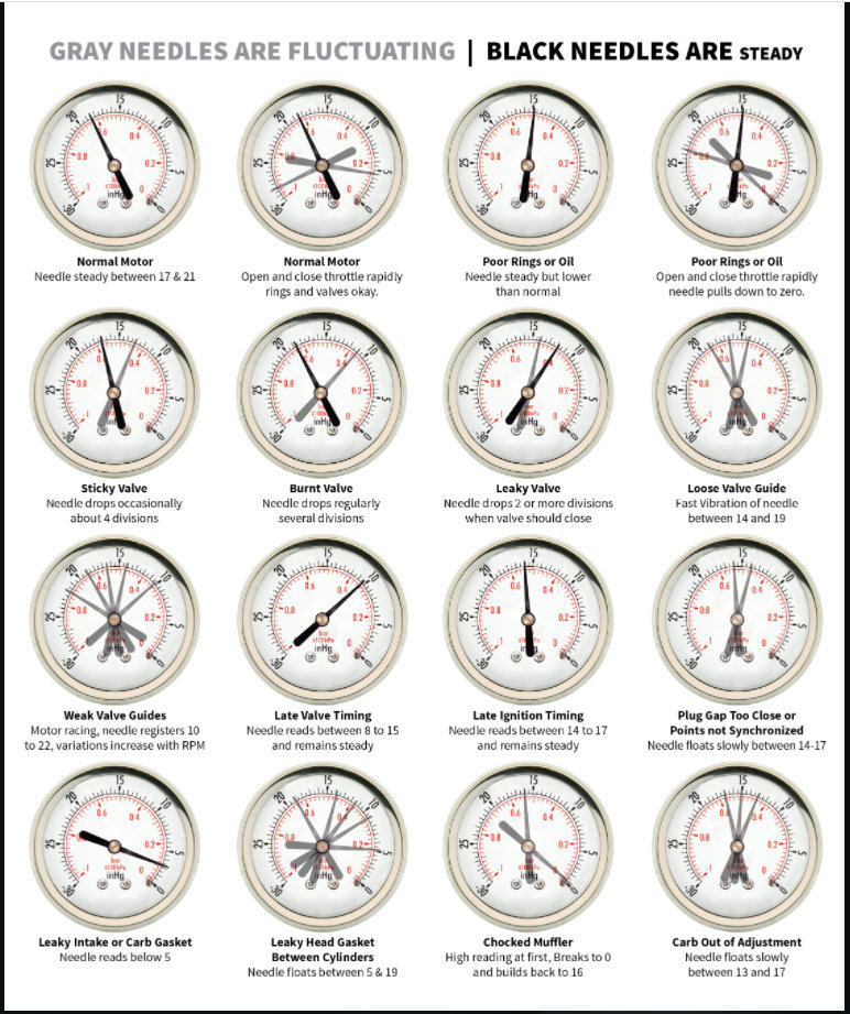

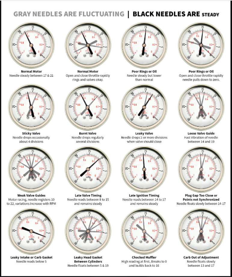

We will then need to make sure we check the engine vacuum as well. Below is a chart that will help with figuring out if the intake valves are an issue.
Let us know what you find with this and we can go from there. Thanks
