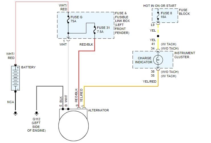

My tachometer went out and the car wont charge. I put a new alternator and battery in and the car still wont charge. I suspect there is a short in the wiring but cannot find it.

The first thing I want you to check are fuses. I have attached a wiring schematic for the entire charging system. First, check fuses 8, 31, and the G which is a 75 amp fuse right from the battery. Locations are indicated on the schematic.

If all fuses are good, I need you to check the ground on the left side of the engine. It is a black wire which runs to the engine from the alternator. See schematic for G112.
_____________________
If the ground shows good, then we need to confirm the alternator truly isn't working. It may be charging the battery but an electrical draw after the engine is off drains the battery.

This is going to sound really elementary, but always start at the battery. Make sure the battery terminals are clean and tight. Also, check for evidence of corrosion or damage on main battery grounds.
Let me know what you find.
