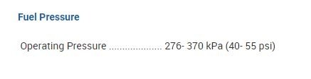

To run, you need fuel pressure, spark, and compression. I attached some guides for you to view to check these systems to determine the area of failure.
I attached the fuel pressure specs below. You can rent a tester at a parts store for the test.
