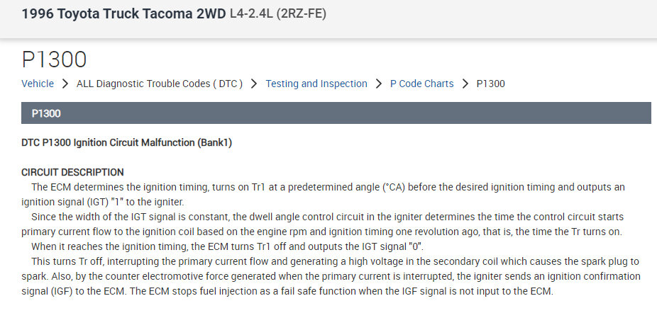

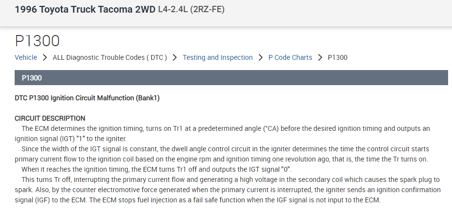

I got a P1300 code after cranking.

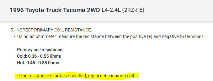

1. Referring to my first post, the primary resistance of coil reads 0.9 ohms (specs call for 0.45 to 0.65 ohms). Is this enough difference to replace coil. Already replaced once.
2. I am getting about 12 volts at both the negative and positive terminals of the coil with key on. Is this normal?
3. Since I have voltage at coil with key on and no spark at plug when cranking does that denote the problem lies between coil and plugs?
Thanks for your time, it is greatly appreciated.
Feb 22, 2024 at 1:04 AM
  • 110,244 POSTS

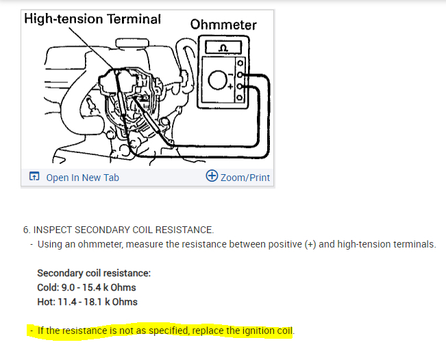

The resistance cold should be between 0.36 and 0.55 ohms. When it is hot, it can reach up to 0.85 ohms. That is close if you are checking it hot (which I doubt since it won't run).
The 0.90 resistance is high and could prevent it from working. It wouldn't hurt to replace it and see if that makes a difference. I say that because it is beyond the specs and likely will need to be replaced soon if it hasn't already failed.
As far as the power question, if the key is on, yes, both sides will have power. Power enters through the positive and exits at the negative. The ignition system is what controls spark by providing and on/off ground.
I would replace the coil based on the resistance. Let's see if that resolves the issue.
See pics below for testing resistance.

I misread primary resistance for a hot coil which is not the case. You are right resistance cold (under 122F) max is 0.55 ohms. so, getting 0.9ohms is even high for a hot coil. What is confusing to me is I have gotten 2 new Delphi coils. The original coil and two new ones all show primary resistance of 0.9 ohms. I will go to a local auto store and try a different brand.
The image you sent is for checking secondary resistance. I checked it and it was within specs.

I'm not sure what to say about the coils. I checked two manuals, and both are the same. As far as the crankshaft position sensor, were you able to confirm if there is an RPM signal? If there is one, it should be working.

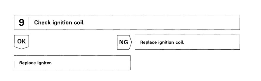

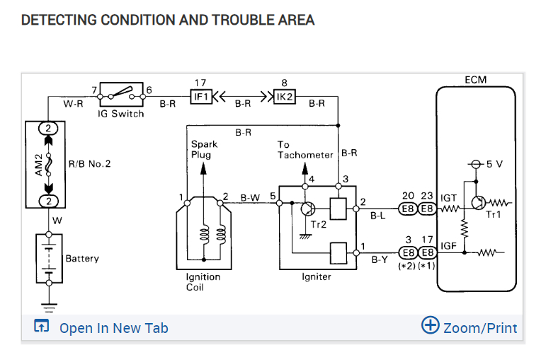

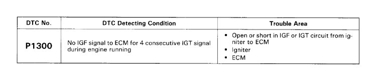

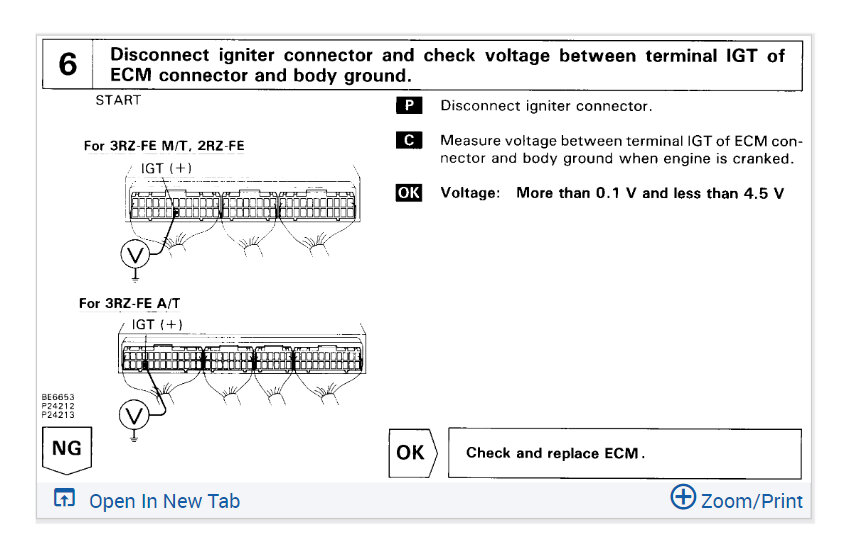

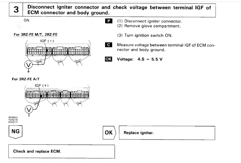

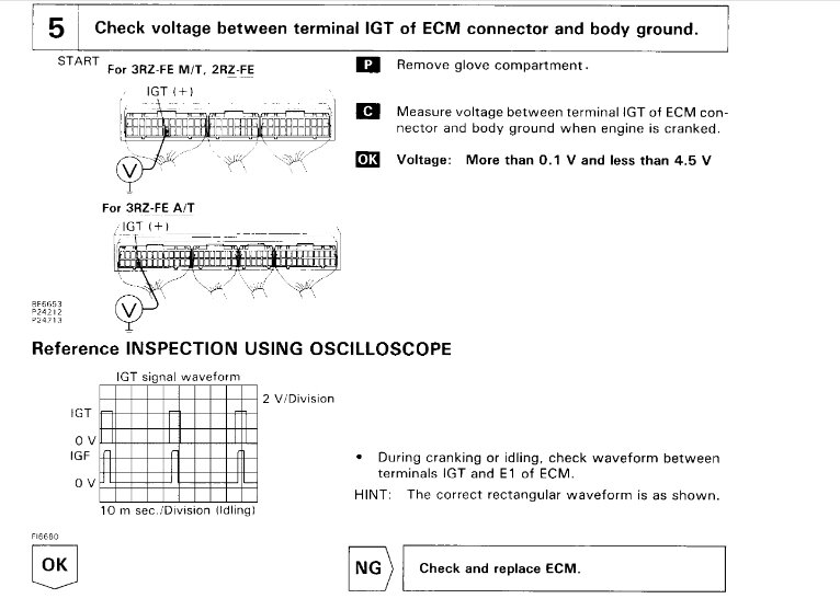

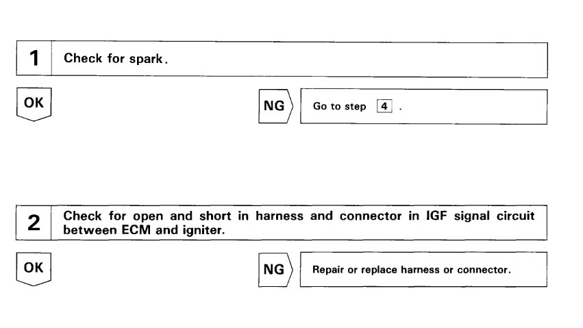

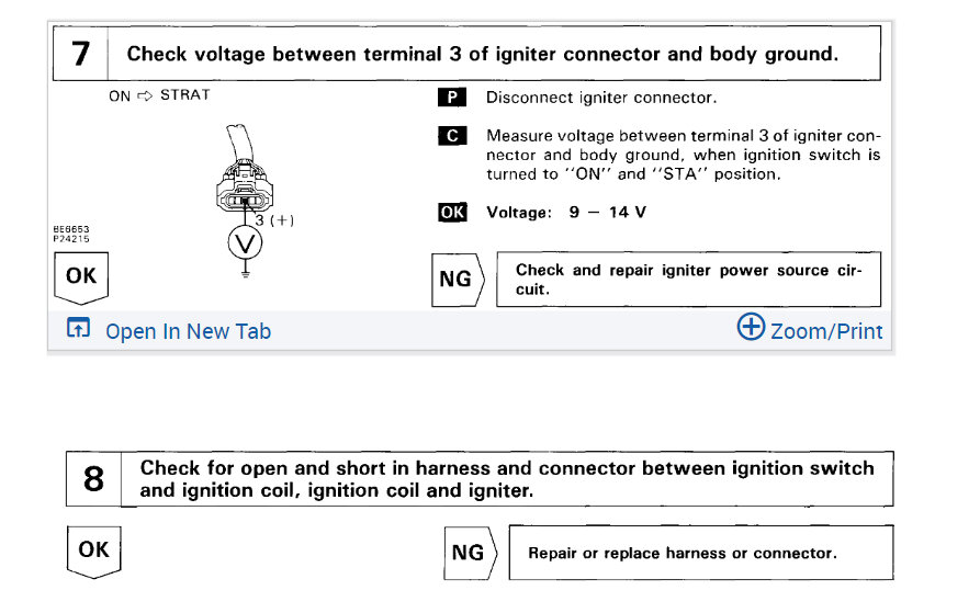

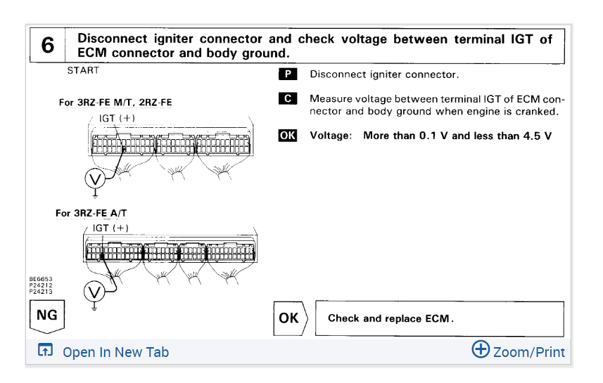

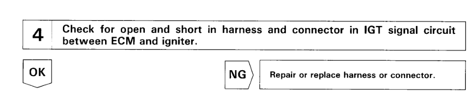

Do me a favor. I attached diagnostics below specific to the P1300 code you have. Take a look through them and let me know if you are comfortable performing them.
Feb 23, 2024 at 12:39 PM

Hello Joe,
I got lucky and found no continuity between the igniter connector and 2 wires running to it. Fixed connection and is running fine.
That Toyota manual must be a misprint stating the primary coil resistance is maximum .65 ohms. I reinstalled the original Toyota coil and it works fine with a resistance of .90 ohms.
