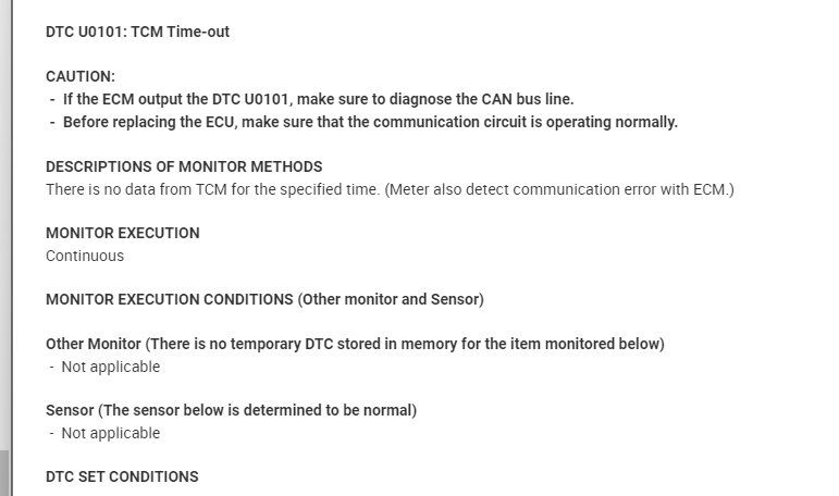

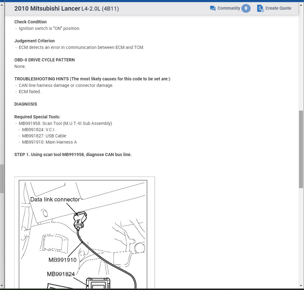

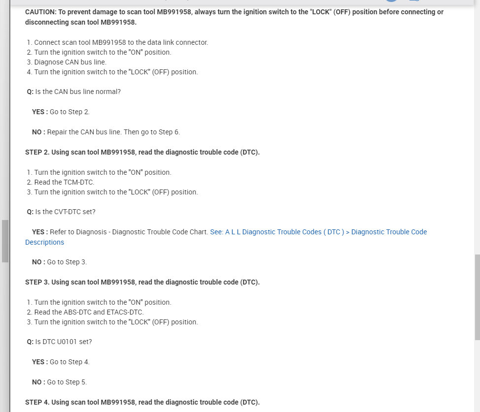

The Fuel pressure was at 44,45 and yes, I have checked the spark plugs grounded as you indicated, and spark looks good. The plugs are new, and the tips do look like they have tried to ignite the Fuel and air mixture because when I pull them out after trying to start It, they look a little smoked. I can take a rag and clean that little smoked off of them and they are new again. I haven't got a good scan tool, but I did ready the codes and it Is giving me P1590 and U0101.
May 18, 2022 at 5:07 AM

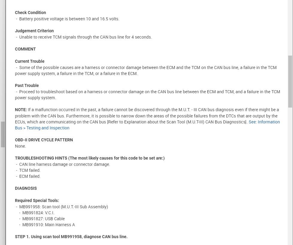

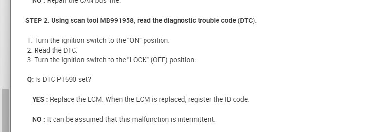

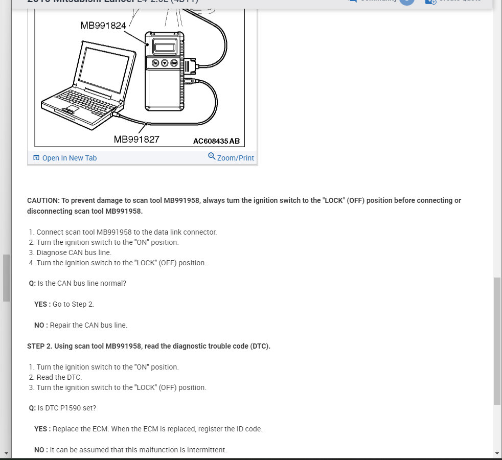

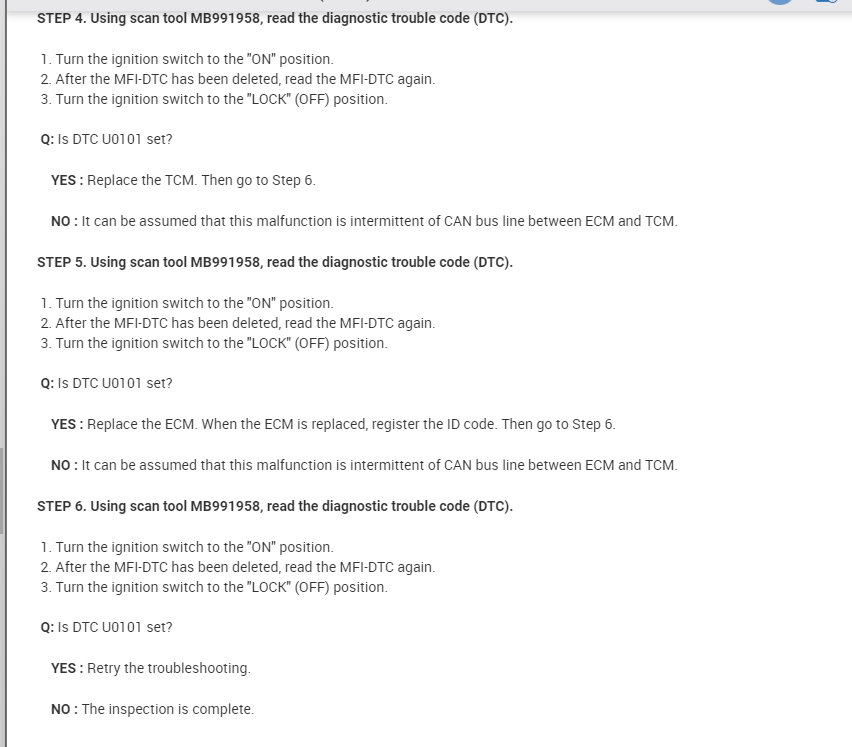

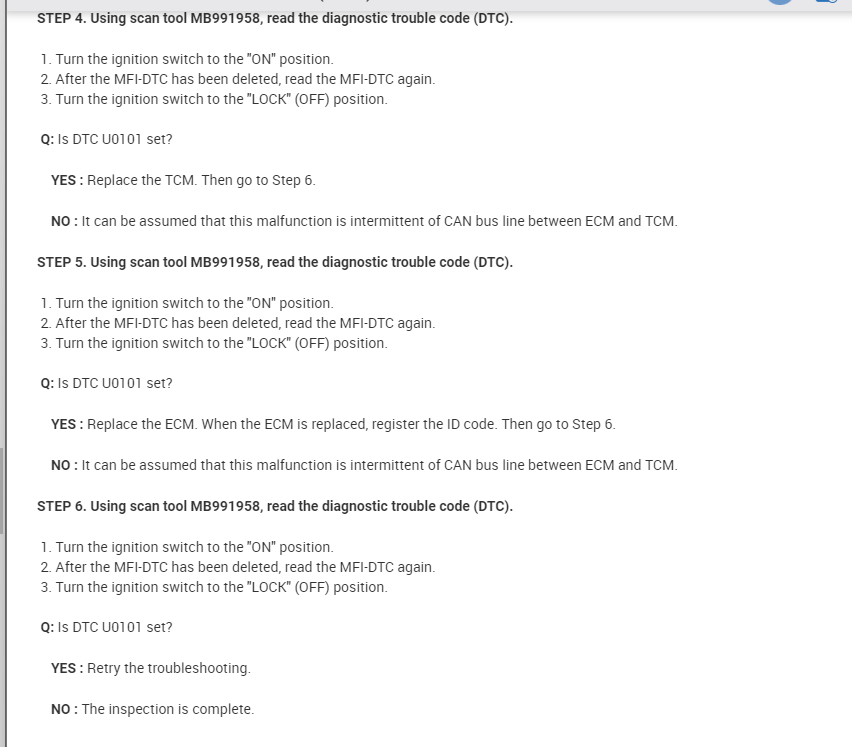

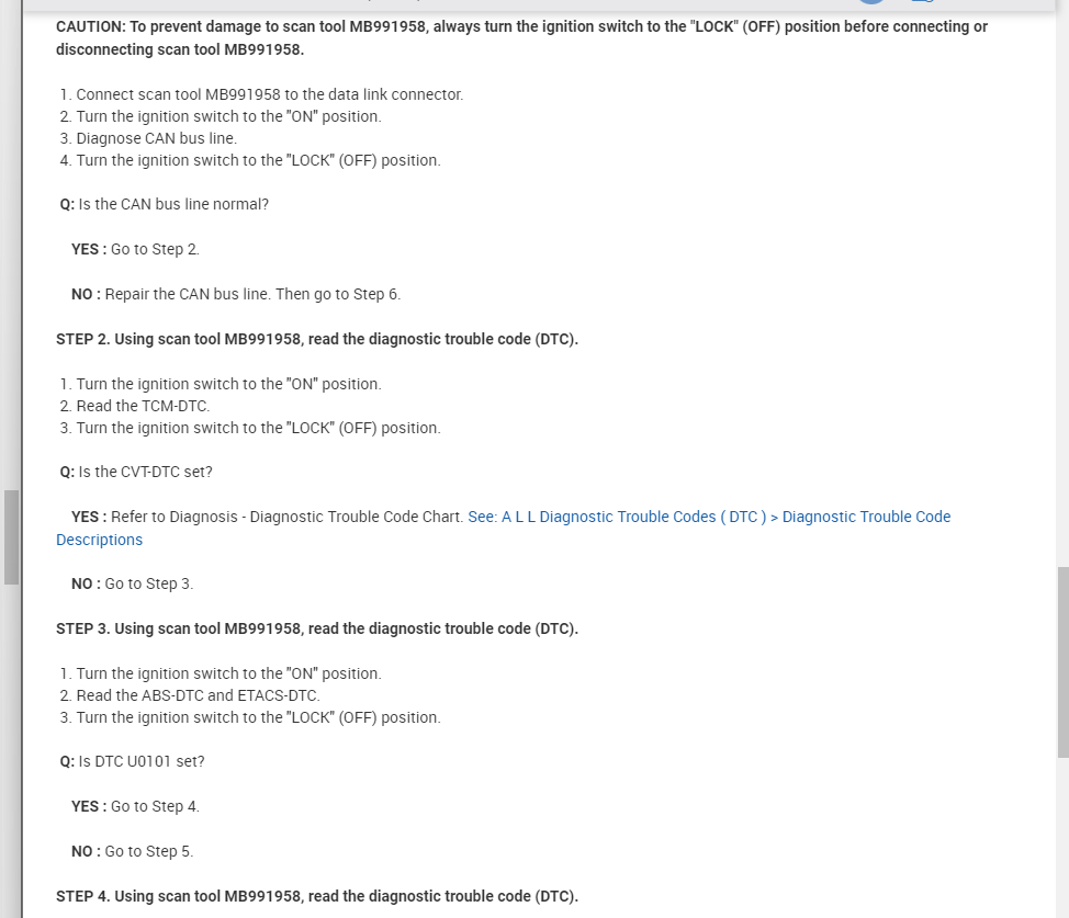

Okay. That info helps but backs up what Boris was suggesting. It sounds like you may have a wiring or EMC issue.
I am attaching the testing for the P1590. Basically, that is telling you that the PCM and TCM are not able to communicate.
I would expect this would result in a no crank no start and not a crank no start but that could be the case as well.
