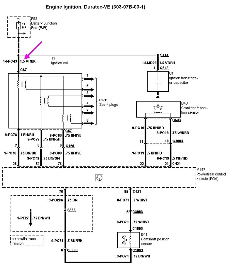

So my car will crank but will not turn over. I have changed the following: cam and crank shaft sensor, fuel pump, starter, spark plugs and PCM relay. I don’t know why it will not start. I have a low voltage on my coil pack plug. I don't know what’s goin on.

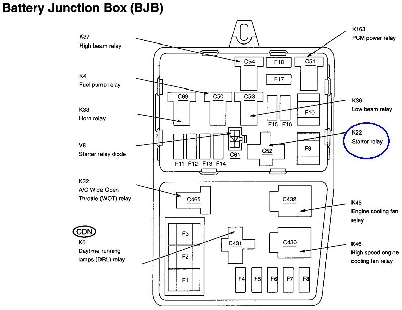

If this is a starter problem, can you hear or feel if the starter relay is clicking when a helper turns the ignition switch to "crank"? The entire system can be broken into four parts, each with a test point in the starter relay's socket. A test light works best for these tests, but a digital voltmeter can be okay too.

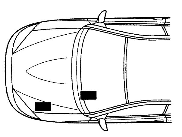

Also, for almost everything I look up, I have to choose between "before" or "after" a build date of May 24, 1999. Ford is famous for making major changes in the middle of model years. I think they did that just to confuse us. So I post the right diagrams for you, look on the back of the driver's door opening, or on the back of the driver's door, for the ID sticker. It will list the "date of manufacture" near the top of that sticker.
If the engine doesn't turn over, (crank), we'll need to look at the starter system. In the meantime, I put together diagrams related to the ignition coil pack you referred to. You checked the plug for the ignition coil pack, but there's four wires going to it. Which ones did you test, and what did you find?

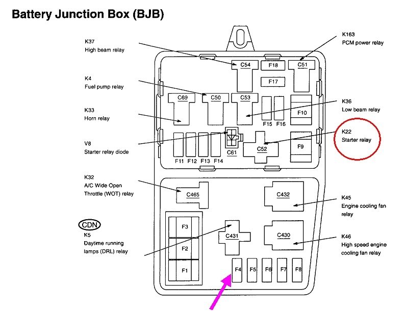

This first diagram shows the ignition coil pack and the four small wires going to it. You need to check for 12 volts on the violet wire, but it won't be there unless the engine is rotating, (cranking or running). That means you have to do the test while a helper is cranking the engine. If the 12 volts is missing, check fuse # 4 in the fuse box by the battery.

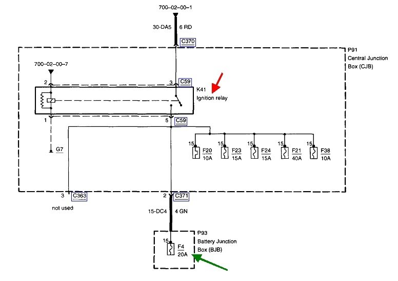

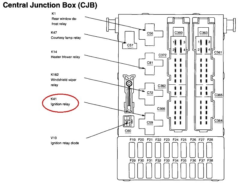

The third diagram shows fuse # 4 at the bottom. It is fed through the Ignition Relay, shown with my red arrow. That relay is in the inside fuse box, shown in the fourth drawing. You can try swapping it with one of the others like it, but they don't fail very often. It's much more common to have a sensor fail, then the Engine Computer won't know when to turn on the Ignition Relay. This is where reading the diagnostic fault codes will tell us if we need to be diagnosing a sensor circuit.
