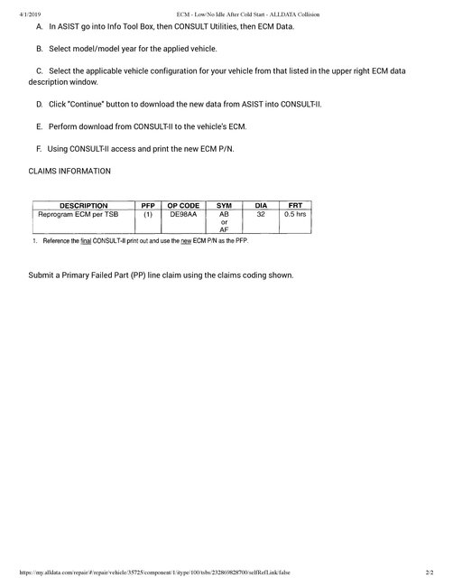

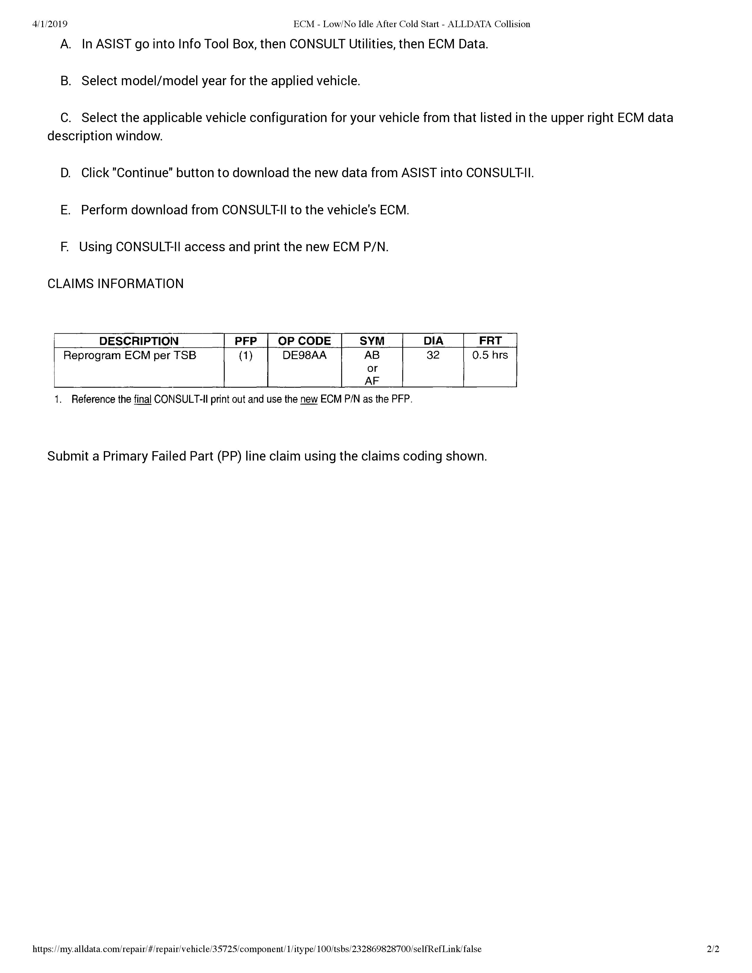

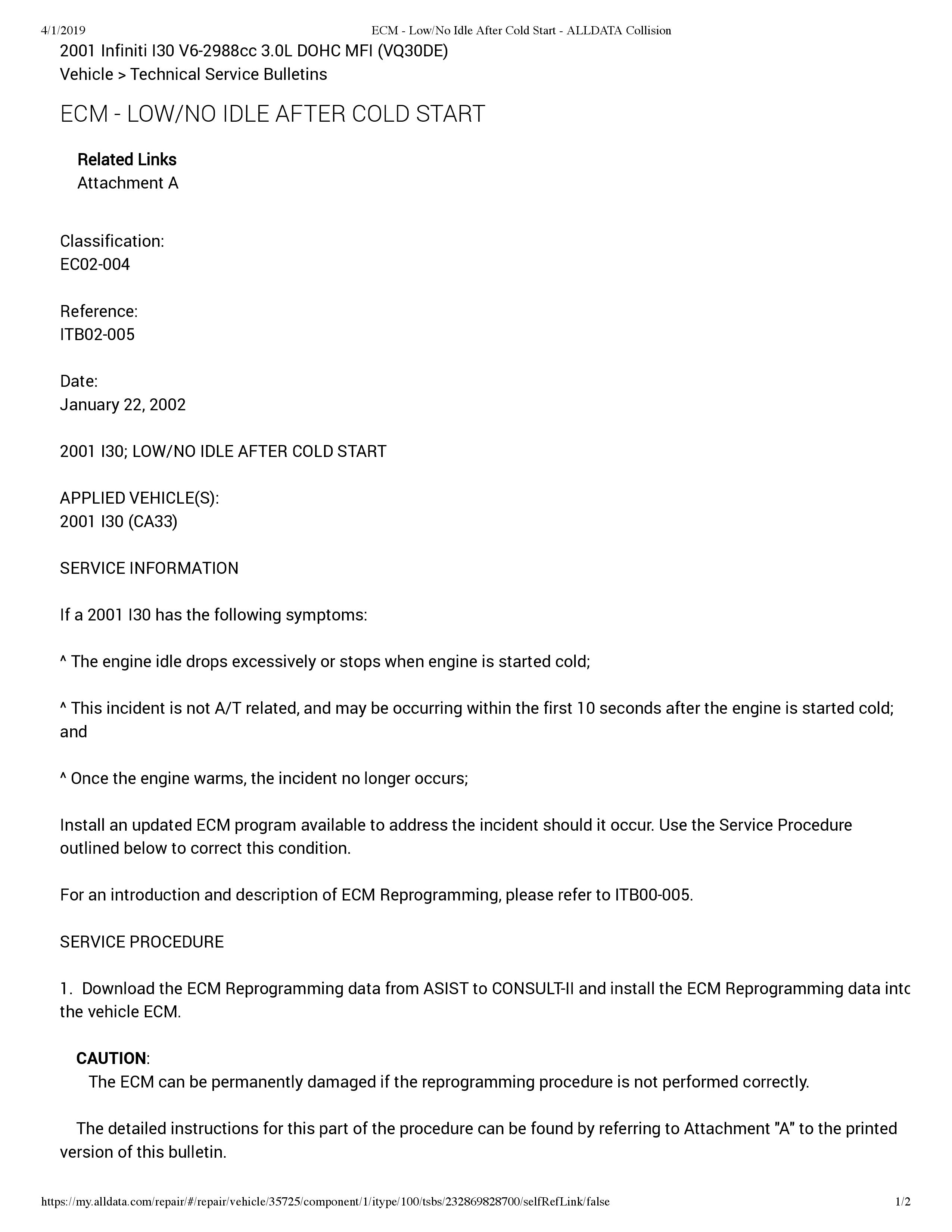

I have found a TSB (technical service bulletin) that may be applicable to your vehicle.
Have a read through and see if that sounds like a good match.
The fix would be to go to an infinity dealer and get the ECM (engine control module) reprogrammed with the latest software.
I would call first, give them your VIN and they should be able to tell you if this TSB is valid and applicable to your car.
It's a good place to start to avoid chasing an issue which is potentially software related.

If there is an issue with the idle when you try and pull away the vehicle may hesitate.
This could be explained by the TSB i sent you.
With no fault codes the reprogramming would be a good start.
Try calling your closest infinity dealer and asking if they have had vehicles with a similar fault whether the TSB is applicable and a good place to start.
