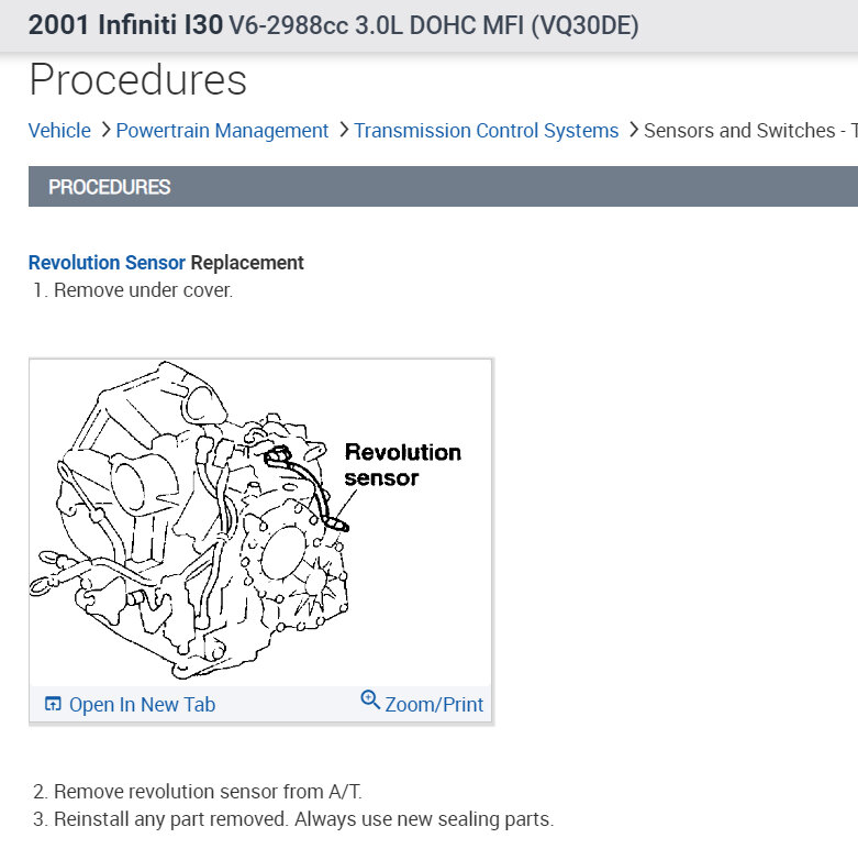

This sounds like the turbine sensor is going out, but we should run the codes to see what comes up.
Here is the location of the sensor just in case you need it. Check out the images (below). Please let us know what happens.
