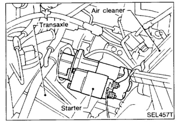

car wont start put in a new battery but lites don't dim and all I get is a click when I try to start it .
Nov 8, 2009 at 1:15 AM
  • 54,840 POSTS
This sounds like the starter has gone out but to be sure lets testing first, here is a guide that will show you how.
The test is at the bottom.
Here is a diagram on where the starter is on your car.
Please run this test and get back to us so we can continue helping you.

Yes you can try hitting it with a hammer while the key is in the start position.Also you can see if the small trigger wire has power at the starter while the key is in the start position.

Thankyou for your advice. The starter was smoked. Now I'm trying to find out why the security light is always flashing except when the doors are locked-then solid red
