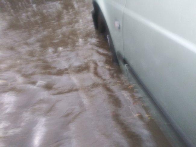

The other day we had a bad rain storm and I drove throw some water and did not think it was that deep, so right away it shuts off the car. so push it out as fast as I can towed the car home and started draining the water out of every where I could of. now I can get it to turn over for like two seconds then shuts off right away.

How deep was the water that you drove through? It didn't get sucked into your vehicle's engine through the air intake did it? Please get back to us with the answers and we can go from there.

Yes it did, you can see in the picture how deep it was. After i drain all the water out of the turbo in the air cooler and exhaust out of the i change the plugs. I check to see if the fuel pump was working it was not vary strong so I run a hot wire to the fuel pump it seem stronger.then I pull the injector out and turned the car over. it seem to me like they are working.the only thing that does not work right that i know of is my key fob. It does not not open the trunk or unlock the doors.

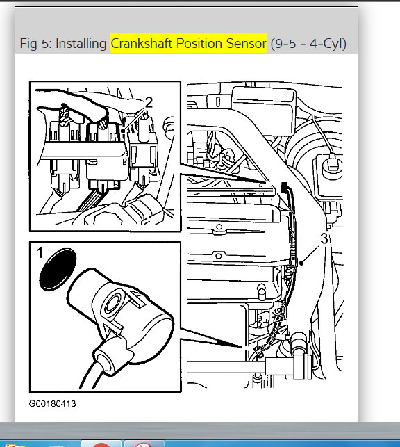

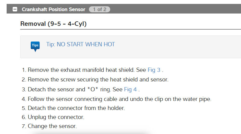

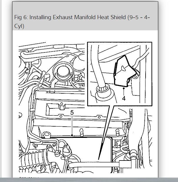

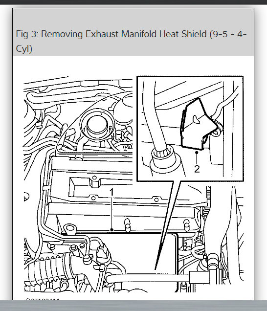

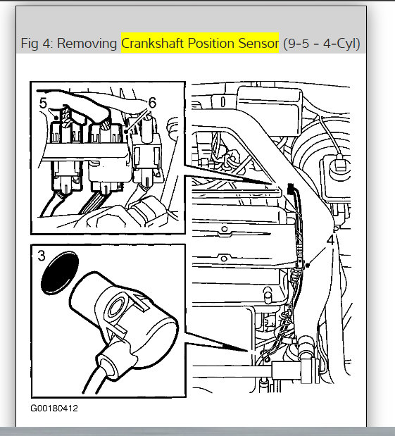

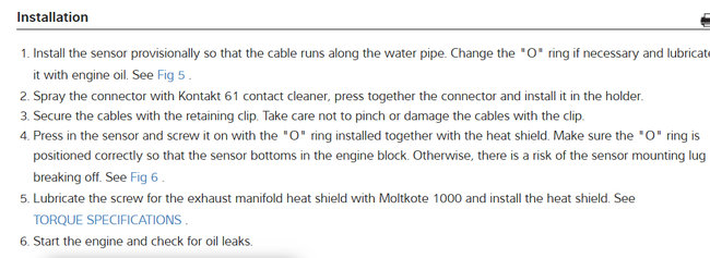

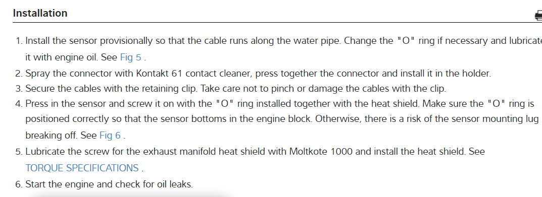

Okay, that's good. This could be a problem with your vehicle's Crankshaft Position Sensor (CKP). Your vehicle's Power-train Control Module (PCM) or "computer" uses the CKP signal to keep track of where the engine is in it's 4 stroke cycle and takes the information and fires the ignition and fuel injectors off of it. In the diagrams down below I have included instructions for the removal and installation of your vehicle's CKP. Please go through this guide and get back to us with what you are able to find out.

Okay, i will replace it. but would it show up on my scan tool?
Jul 20, 2019 at 1:46 AM
SCGRANTURISMO
  • 4,897 POSTS
Hello again,
There are a few DTC's for them, but a lot of the time they won't trigger a DTC to set. Here are a couple of links for you to go to below:
