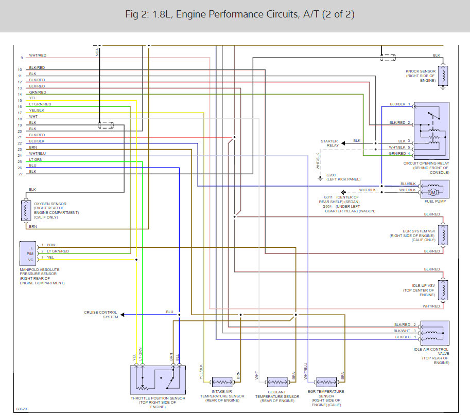

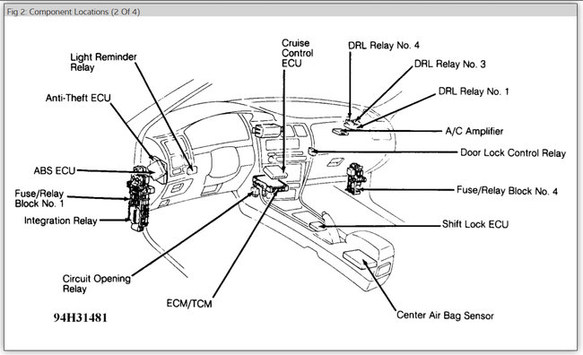

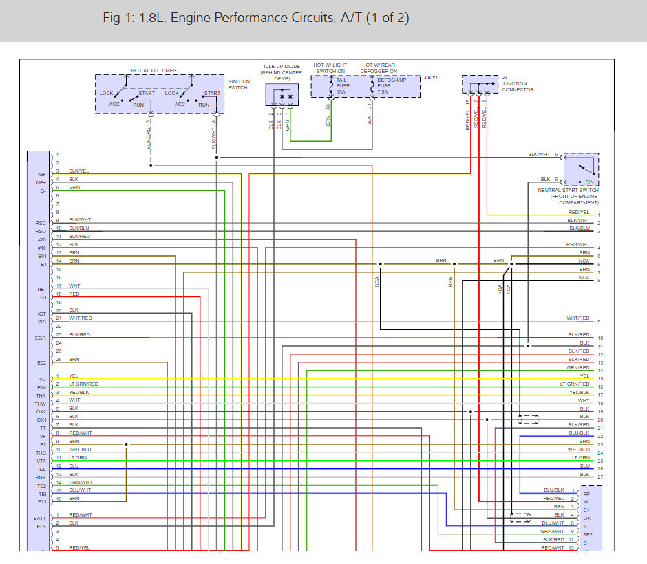

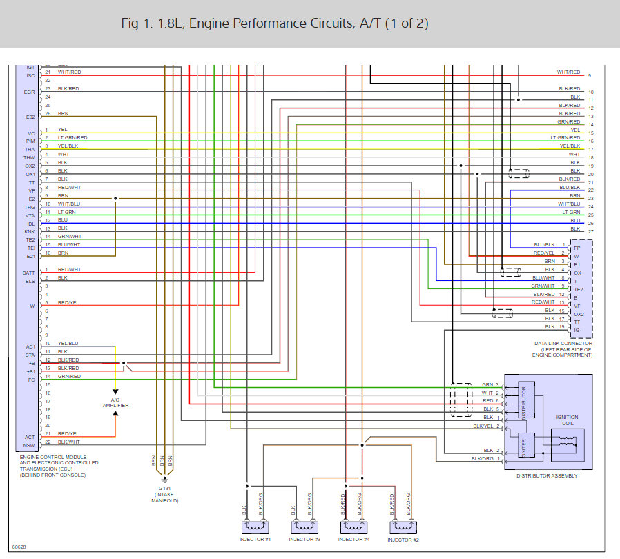

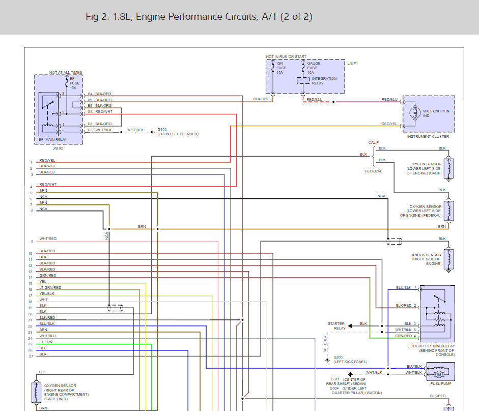

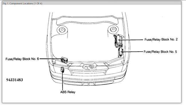

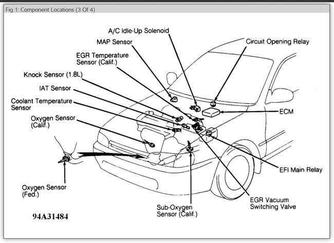

The car listed above (a-fe) quit running suddenly while being driven normally. Cranks but will not start. No spark, no fuel, strong battery. NO MIL light (check engine) and no codes stored. MIL light does not illuminate. Bulb is good. Mechanic said there was power to ECM but no output. Said it needed new ECM but could not warrant it. She cannot afford $1,300.00 replacement cost. No obvious damage to ECM or wiring. I can replace, but first I would like to verify that the ECM has failed. I have it out and have access to the connectors. It is not my car so I do not want to waste her money if it is not the ECM. Any ideas? Thanks.
Thursday, January 21st, 2021 AT 2:49 PM (Merged)
KEN L
  • MASTER CERTIFIED MECHANIC
  • 48,363 POSTS
You can get a used ECM for about a $100.00 I would go that way instead. The only way to check if the ECU is bad is to do a wiring check which I can give you instructions on if you respond back.
+1
GUNSUP1
Thanks Ken, I have ordered a used one. The mechanics she took it to are reliable and warned her that something else like a sensor shorted out may have caused the ECM to fail. That is why they could not warrant it. This is a 1993 OBD1. I do not see that happening but then again I have never had an ECM go bad. I know a lot of folks blame them but I find it is usually something simpler. Is there anything I should test before trying the used one? Also, where can I find a diagram for the connectors? I would like to jumper the power in to the MIL lamp out to confirm the mil lamp is working. The ECM is 89661-02090 engine is a 7A-FE. Thanks.

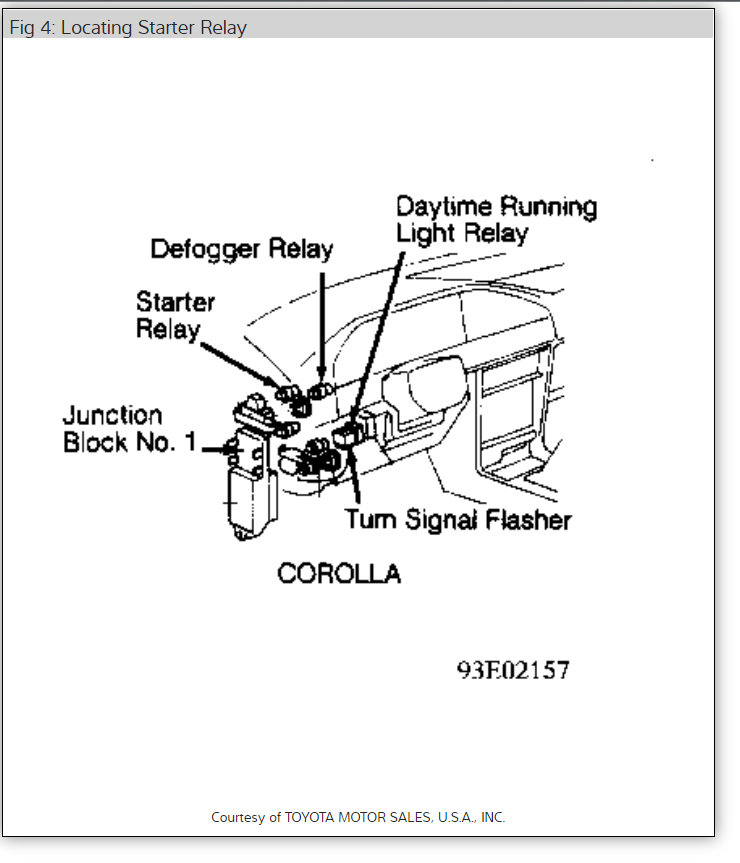

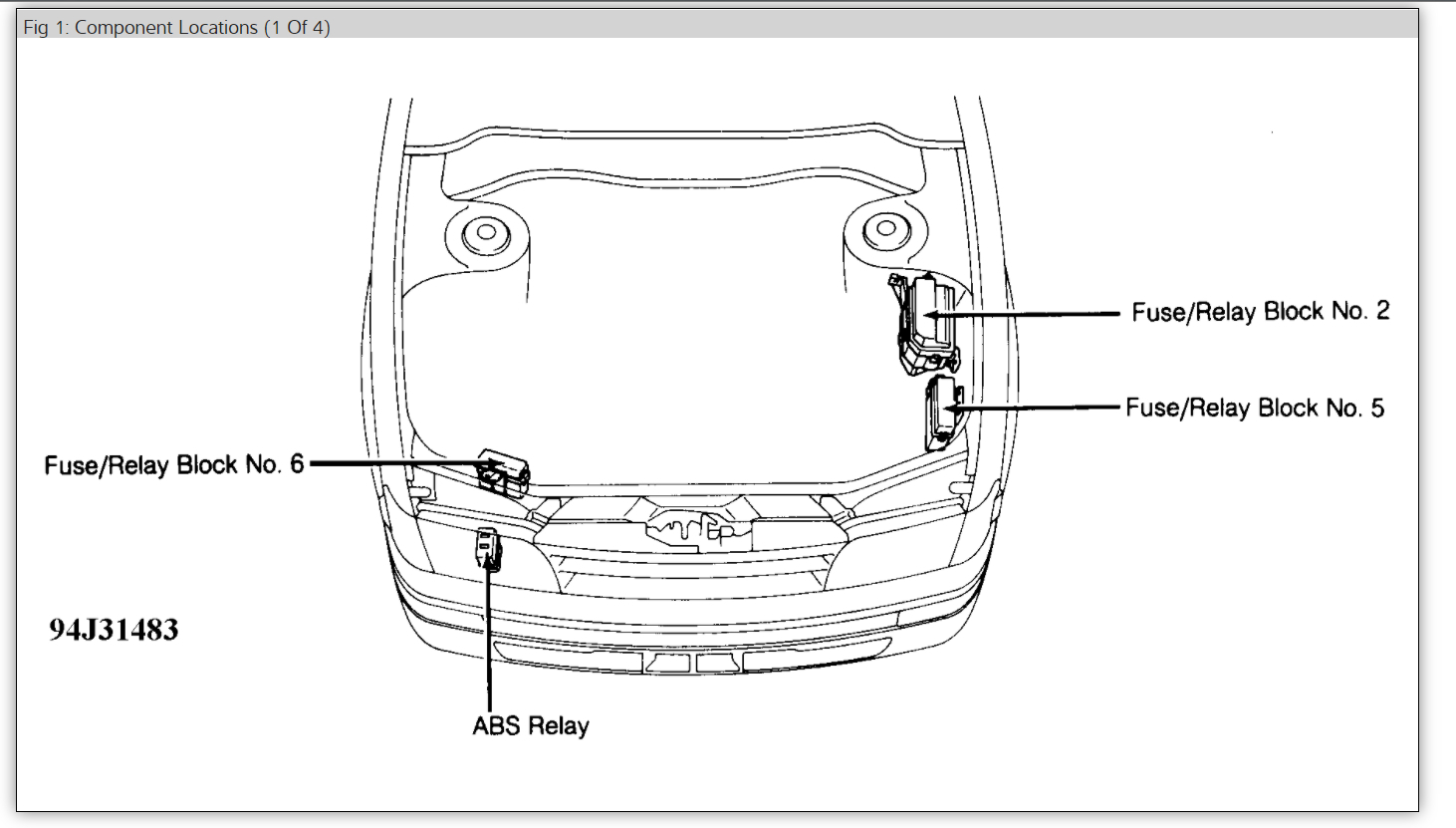

It could be a sensor causing the issue. I would disconnect the oxygen and engine coolant temperature sensors to see if it comes back to life. (try starting it) Next I would check the fuses/EFI relay that power the system. Here are guides to help:
and
I would try unplugging the fuel injector one at a time and try and start it as well. If one is shorted it will shut down the ECM
Here is a guide to help you run the codes:
