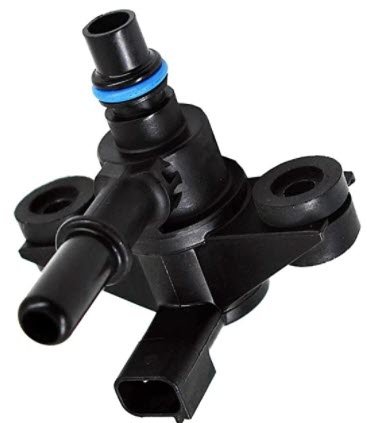

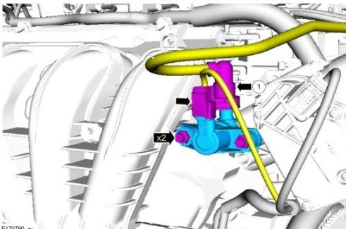

Evaporative system purge valve stuck open! I do at least three of these every week. The valve stays open and draws a constant vacuum on the tank, thus drawing in raw fuel to your engine instead of vapors at a higher RPM.
