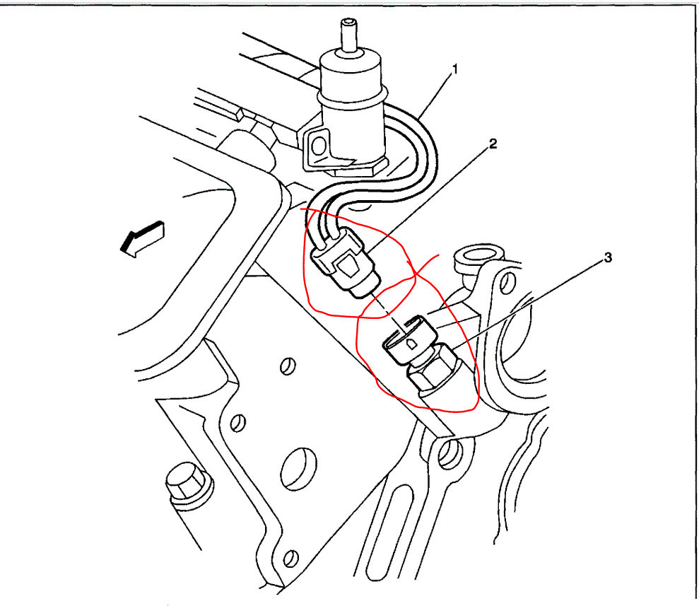

Temperature gauge goes up and down while driving. Then finally the engine will just shut down. Gauge showing hot. After inspecting under hood. Hoses are cool. Coolant not boiling in radiator, carefully open radiator and coolant is normal operating temperature and still full. After car sits for 15-30 minutes. it will start back up and run again for a little while until it does it again. Replaced radiator and still does it.
Jun 28, 2020 at 7:07 AM
  • 110,251 POSTS
Does the temperature gauge go into the hot range even though you feel it isn't actually overheating? If it does, that sounds like the coolant temperature sensor is bad or has a bad connection.
The sensor is on the front left of the intake manifold. Check to make sure the wiring to it is in good condition, not loose, and not damaged. I attached a picture to help you locate it. If the vehicle's computer things the engine is running too hot, it will go into a limp mode and shut down.
Also, there are other things that follow similar conditions. The crankshaft position sensor can cause the engine to stall when it warms up. This can happen when the sensor begins to fail, and once the sensor cools off, the engine will start again. Take a look through this link:
Let me know. Also, please confirm that I am understanding correctly that although the gauge in the vehicle indicates it's overheating, in reality, it isn't.
