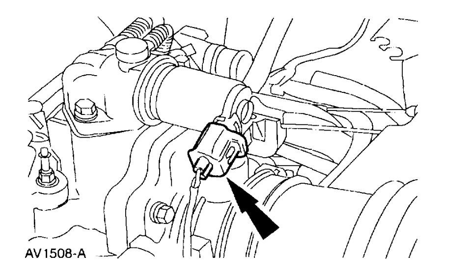

Hi
Think Idle Air Control Solenoid is at fault. Controls idle via ECM signal. Iac located on left side intake manifold try removing and cleaning with carb cleaner. Also cleanout passages.
Hope this helps
Thanks for donate
Oct 9, 2020 at 5:42 AM (Merged)
HEY TOM
That was going to be my next move,and your confermation helped me not look like a boob to my girl ! ( Thanks ) Did as suggested and cleaned tha MAP sensor also,,,so far so good Thanks again !!!

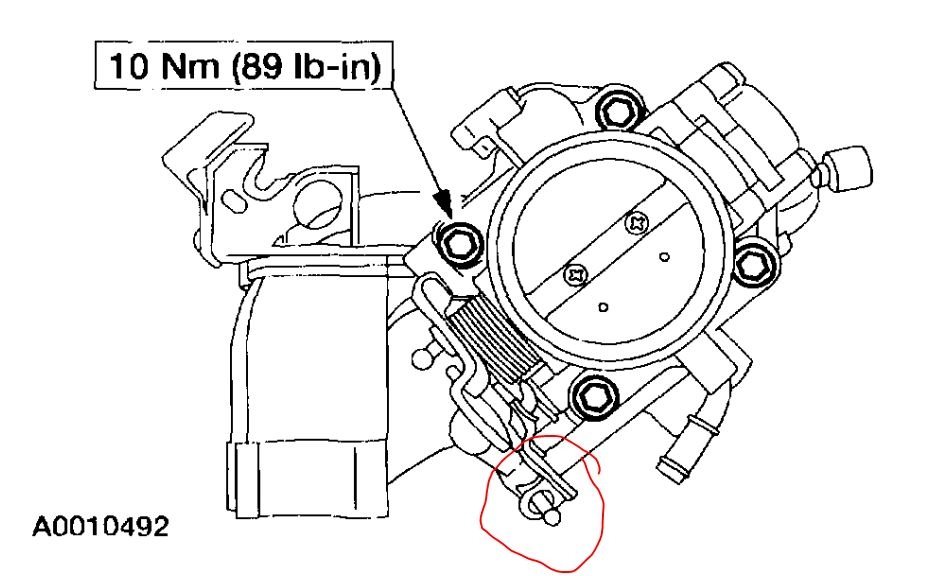

I would consider the idle air control valve. It is a very common failure. You cannot clean this valve as the area that sticks is not accessible for cleaning. It is a replacement only. I controls the idle speed.
https://www.2carpros.com/articles/how-to-replace-an-idle-speed-control-motor-iac
Also, the base idle on the throttle body needs to be set at 500 RPM in neutral.
Check these and let me know what you find.
