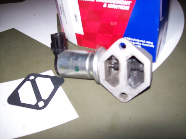

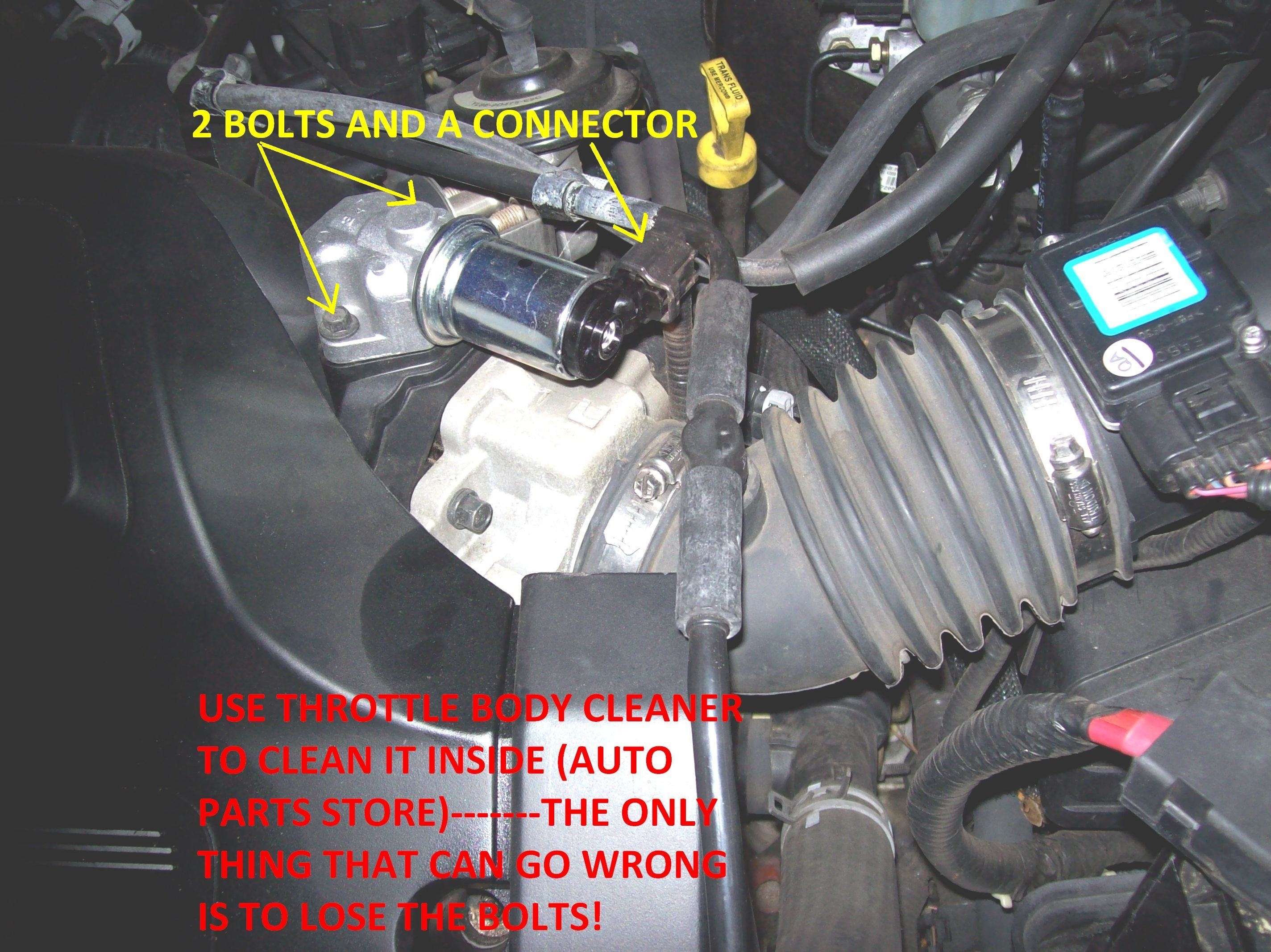

This will sorta guide you to what you have to do, it is really easy to do!
My wife's is on the top of the engine and has 2 bolts.
Our Escape would idle low, then it got to point it would die when you stopped. Revving + holding brake was only way to keep it running.
Took it to fellow R/C airplane pilot, he doubles as a S.C. State HWY DEPT mechanic.
When I got to his house, he was repairing a tractor. Told him my sob story. Escape was still barely running, I raised the hood.
He said, (and I quote)."It could be the Idle Air Control (IAC)", as he pointed to it, and emphasized it with a sharp rap using the wrench in his hand.
By golly it straightened right up, and ran darn good.
That was a 15/16 Craftsman wrench, box end, kinda a medium rap. LOL!
We removed and cleaned it, it may have gone on being Fine, for a lot longer. Since it was my wife's, I took no chances, with my Well-Being.
YES, I visited parts store and replaced it, figured it had 100,000 miles on it, and constantly was a moving part, replacement of this component, was just preventative maintenance in my eyes.
Hope this helps. Hope I am dead on! Cleaning would be free, and at least Maybe eliminate this factor out of the equation.
You can go on with yours (if it's working well now and replace it later, if you have the same feelings about it as I did.
I looked up a new one at Advance Auto Parts for your vehicle. There was one for about $79.00 if you do need one.
A few pictures of the wife's below, yours is very similar.
Please let us know how this goes.

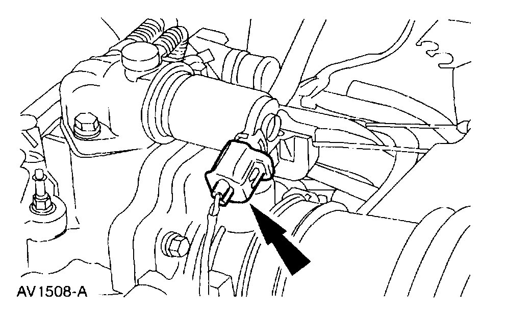

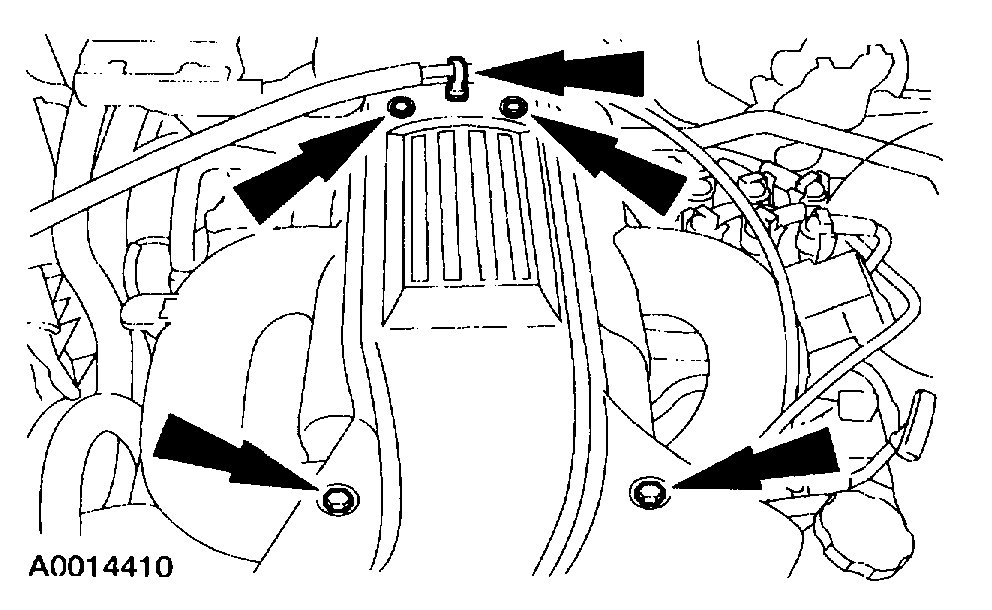

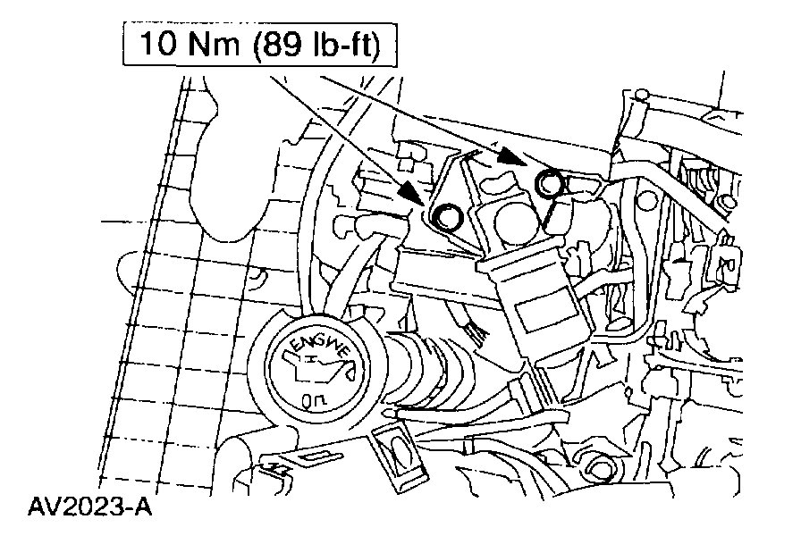

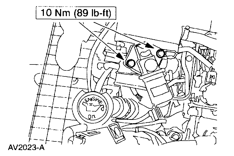

Here are the directions for replacement specific to your vehicle. The attached pictures correlate with the directions.
2000 Ford Truck Explorer 4WD V6-4.0L VIN E
Procedures
Vehicle Powertrain Management Fuel Delivery and Air Induction Idle Speed/Throttle Actuator - Electronic Service and Repair Procedures
PROCEDURES
REMOVAL
NOTE: The 5.0L is shown, the 4.0L SOHC and the 4.0L (push rod) engines are similar.
1. Disconnect the battery ground cable. For additional information, refer to Battery.
pic 1
2. Remove the accelerator control snow shield.
pic 2
3. Disconnect the idle air control (IAC) valve electrical connector.
pic 3
4. Remove the IAC valve and discard the gasket.
INSTALLATION
1. To install, reverse the removal procedure.
NOTE: Install a new IAC valve gasket.
