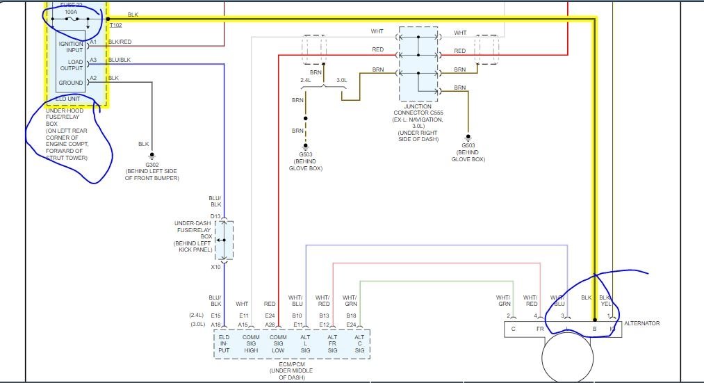

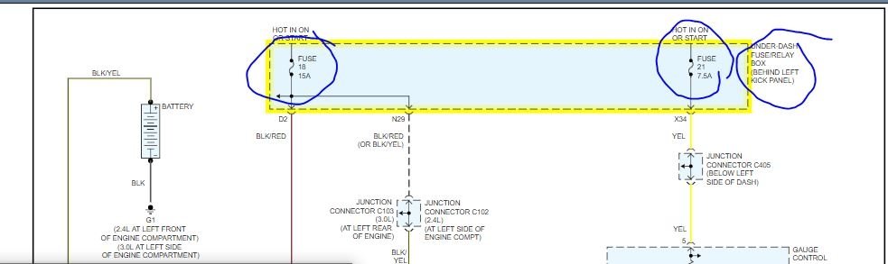

The alternator went out in the car, while I was replacing it I forgot to unplug the battery to the car and a spark went off while I was trying to undo a bolt on the alternator. The spark was not huge maybe the size of a penny to a nickel is diameter. I then unplugged the battery and continued to take out the alternator and put the new one in. When I hooked everything back up, had the new alternator in, and battery plugged in again. I went to start the car and it would not turn on. No lights, no beeping when car door opens with key in, nothing at all. I checked the fuses, battery and ignition ones were all okay. I am not sure what else to do or check. Any ideas?
Aug 6, 2018 at 5:28 AM
DANNY L
  • 5,648 POSTS
Hello,I am Danny.

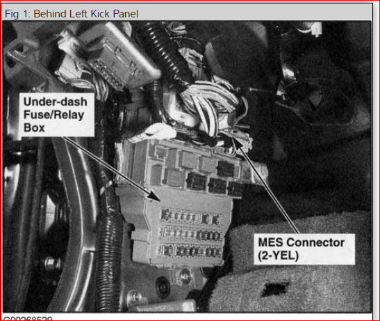

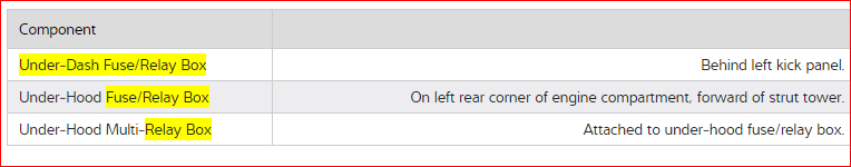

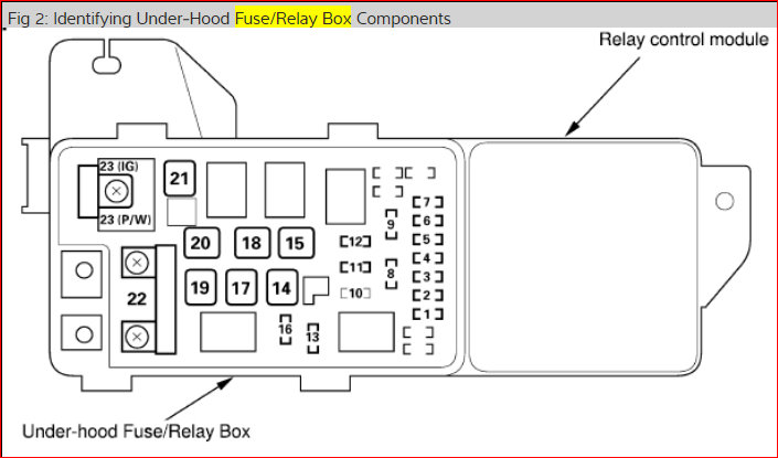

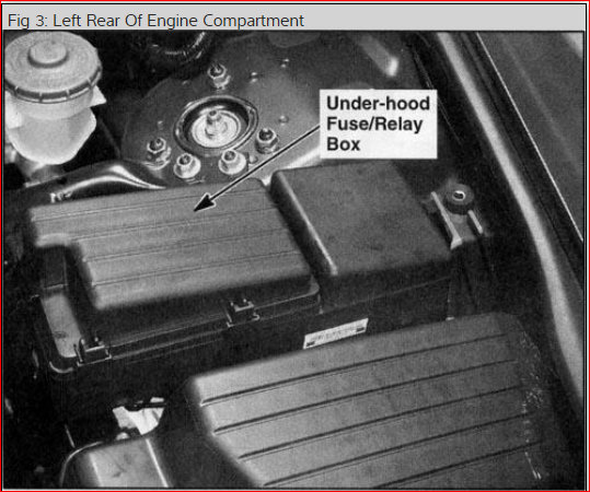

With that having happened I would say a fuse definitely popped. Just so you know there are three fuse/relay boxes on your car. Be should to check the fuses in all three. I have attached a picture of what they look like and their location. I have also attached a link showing how to check fuses. Hope this helps and feel free to ask any questions if needed. Thanks for using 2CarPros.
Danny-
and
Check out the diagrams (Below). Please let us know what you find. We are interested to see what it is.
