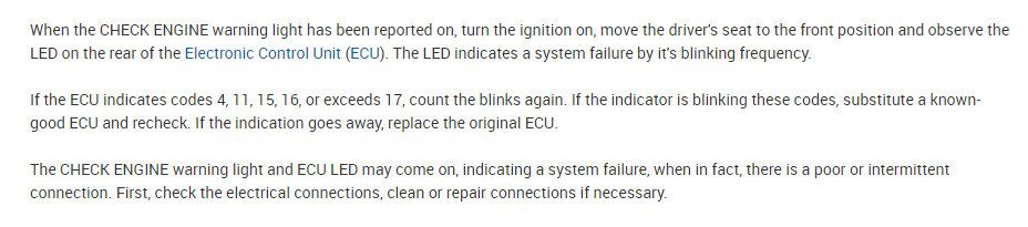

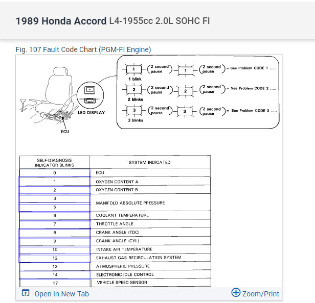

Have you checked to see if there are diagnostic trouble codes stored? I attached directions below for the retrieval of codes. Try this and let me know if you find anything.
Also, let me know if this car is fuel-injected or if it has a carburetor.
