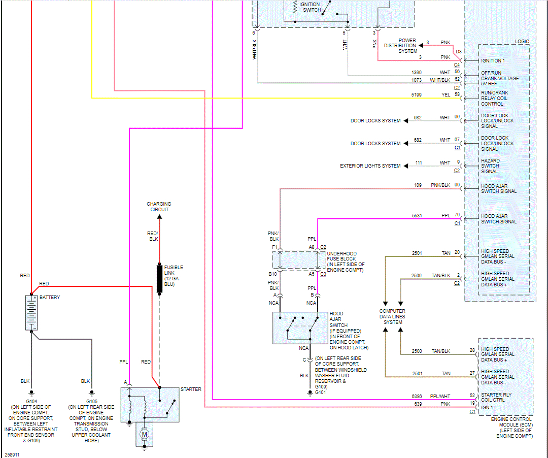

I put a new starter in my car listed above and it started one time but after that no more. Before I replaced it with a new one I put a used one in it and it did the same thing. What can be causing this?

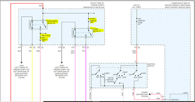

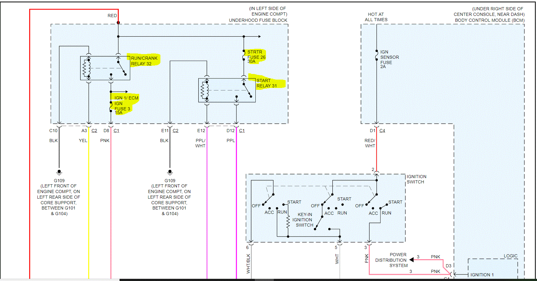

Since it started once, I doubt you have a blown fuse. However, that doesn't mean the starter fuse or ignition 1 fuse isn't loose, damaged, or corroded. So start there.
In the under hood fuse box, locate fuses 3 and 26. Inspect the fuse and its connection in the box. Also, confirm there is power to and from the fuse when it is plugged in.
If that checks good, locate the starter relay (31) and run/start relay (32) in the same box. If there are other relays with the same part number, switch them and see if it makes a difference. If there isn't, here is a link that explains how to test a relay.

I attached the wiring schematic for the starting system below. I had to cut the pic in half to make it readable for you, but I did overlap them so you can follow from one to the next.

Pics 1 and 2 are the wiring schematics. Pic 3 shows the fuse and relay locations in the box.

If the starter does nothing when you jump it, I need you to check to make sure the larger wire on the starter has 12v. It should have it at all times straight from the starter.
Do that before we move on. If there is 12v at the large wire on the starter, the fuses are good and have power to and from them, the relays are good, then we need to start by checking for power at the smaller purple wire at the starter. That wire needs to receive 12v only when the key is in the start position. You will need a helper to perform that test.
Have a helper turn the key to the start position while you check the purple wire for power at the starter itself. If you have constant12v at the larger wire and get 12v to the smaller purple wire with the key in the start position, the "new" starter is bad as well.
