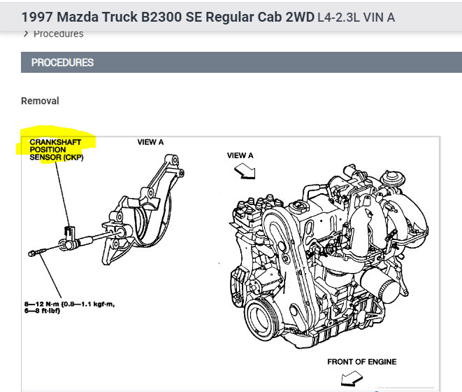

The water pump went on my vehicle, I replaced it. Now it won't start it has got it is getting fuel. I replaced the camshaft sensor in the distributor. I replaced the rotor button I plug the OBD reader in, but it won't connect. What could the problem be? Please help. checked I have checked the fuses they are all good.
Aug 12, 2023 at 8:14 PM
  • 110,244 POSTS
I'm not showing the B2600 for 1997. The only thing I'm finding is the 2300 or 4000. Please confirm for me.
As far as the condition, it sounds like there is an issue with the crankshaft position sensor. If you haven't already, check for spark at the plugs. If there isn't any, suspect the sensor. It may have been left disconnected or damaged by coolant.
I attached a pic below of the 2300 showing the sensor. Take a look at this link. You may find it of interest.

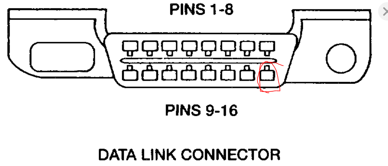

It is a 1997 model b2600i, the water pump went. I replaced the sensor in the I replace but it won't start. I don't know how to get the fault. Is there another sensor on the that could stop at starting? Could you help me and tell me what I can do to try and start? Thank you
Aug 18, 2023 at 12:08 AM
  • 110,244 POSTS
No problem. I would be happy to help.
We need to narrow down the possible causes. I'm not sure why both of my manuals are not showing this model, so bear with me.
You indicated it is getting fuel. I need you to try something. See if it starts if you use starting fluid. If it does and then stalls, we know it is fuel related. If there is no change, then I need you to check for spark at the plugs.
Here is a link that explains how to do it:
https://www.2carpros.com/articles/how-to-check-for-ignition-spark
Also, I need you to check connector pin 16 on the data link connector (DLC). That pin should have battery voltage. (See pic below)
I don't have a schematic for the 2600. Based on the schematic for the 2300, power to the DLC comes from the powertrain control module.
See pic below.
