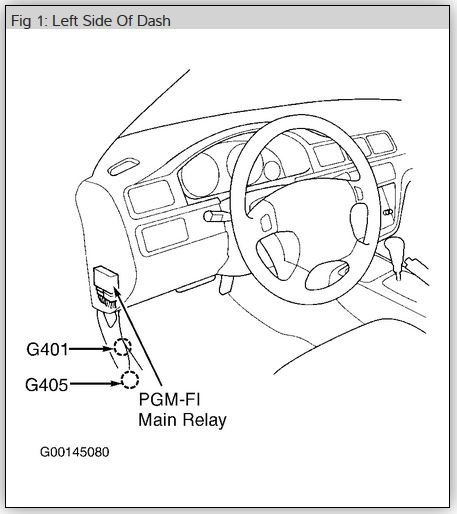

I was driving my car, it shut off and I could not start it back up again. Had to have it towed home and I cannot afford a mechanic to fix it. what I was wanting to know is where the fuel pump relay is located in the car? I want to try the cheapest thing first before I think it could my fuel pump.

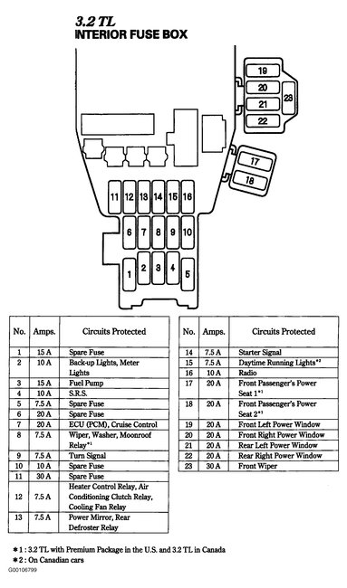

The first figure below is your under hood fuse box. The second one shows the location of the PGM-FI main relay. I cannot find any indication of another relay specifically for the pump.
