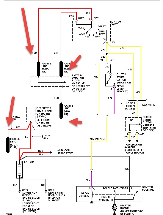

HMAC300
  • 48,601 POSTS
Check items in pic

HOMER1967
  • 875 POSTS
Is it an automatic or manual?Make sure that the ground cable is clean and tight, not just on the battery but on the block to. If it is an auto try to start it in neutral with your foot on the brake. It sounds like either a neutral safety switch, a bad ground or a seized motor. Can you turn the motor over by hand? Does it atleast make a clicking noise when you try to crank it?
