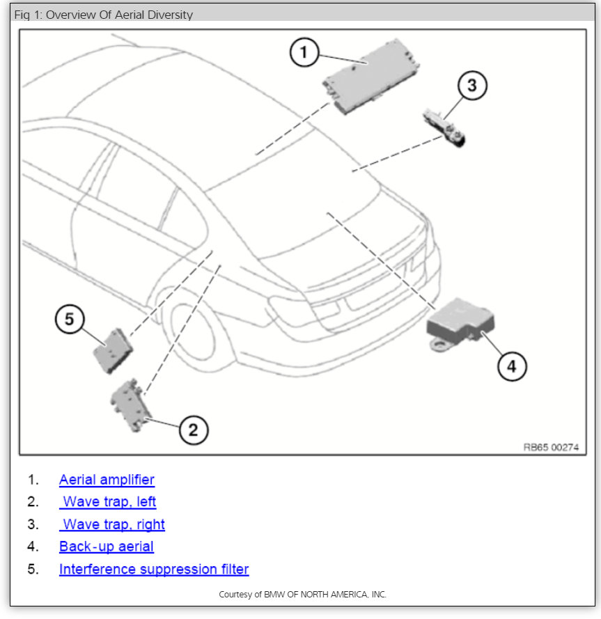

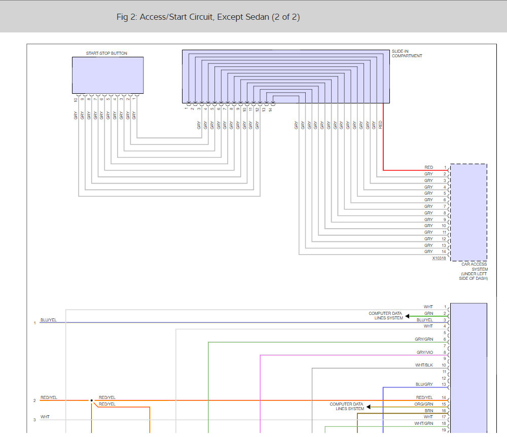

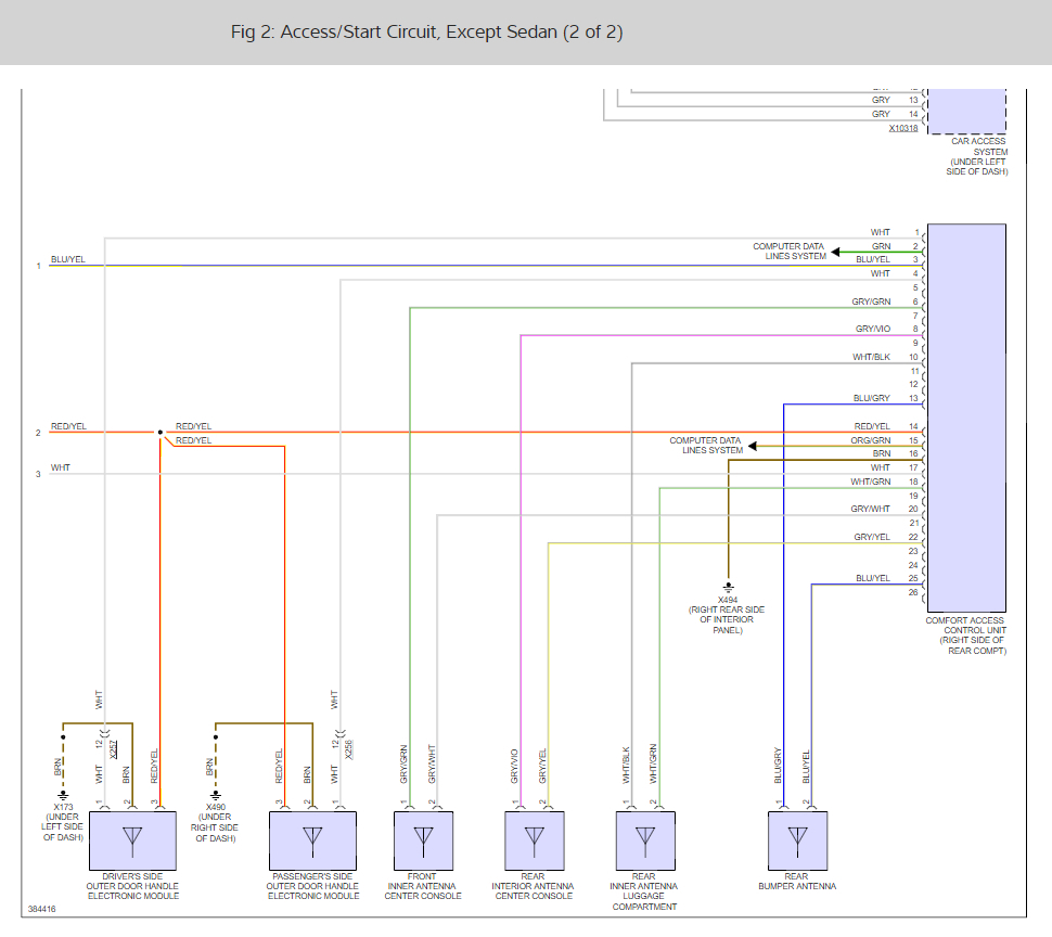

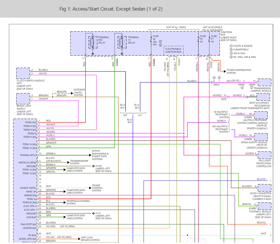

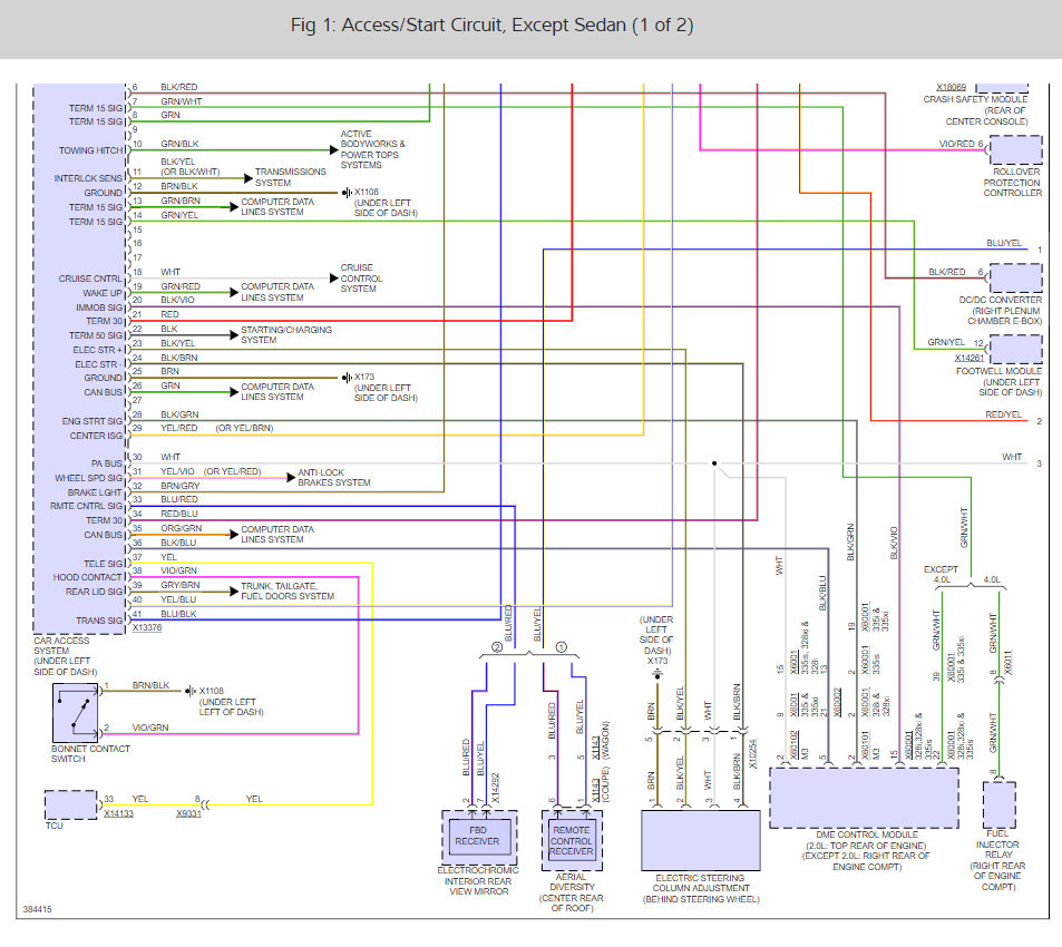

It sounds like to me the comfort access control module is going out and needs to be replaced. Here is a wiring diagram so you can see how the system works.
Here is the location as well, you will need to have the dealer program it for you.
