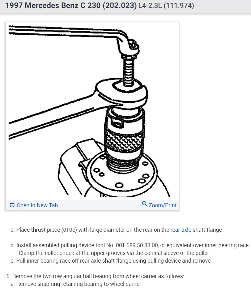

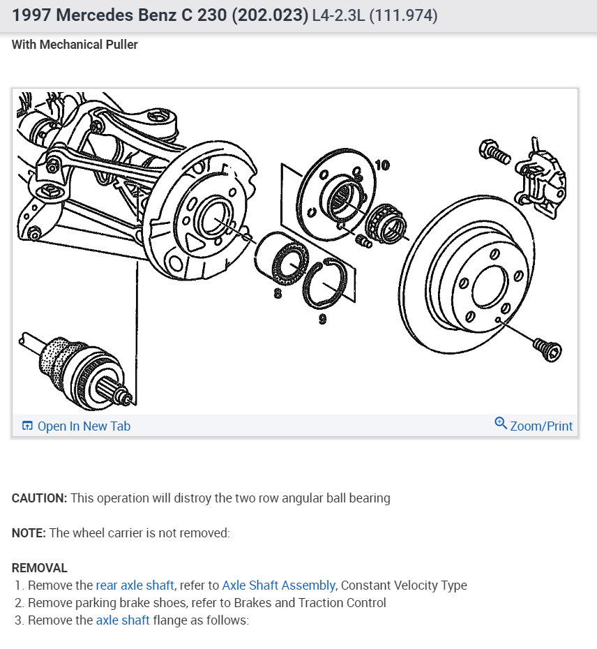

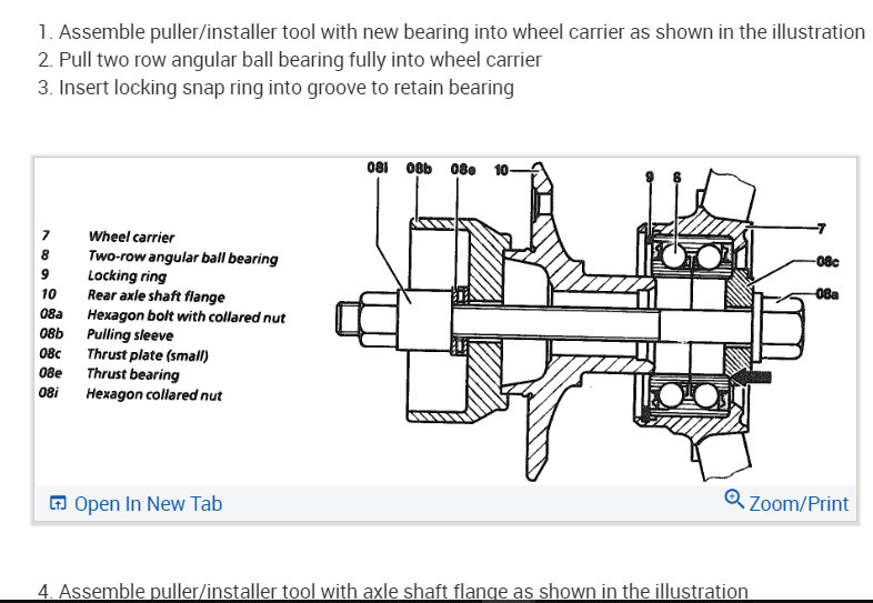

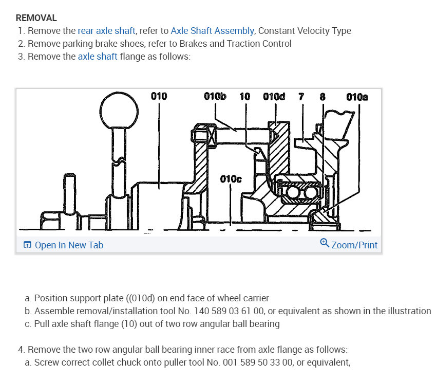

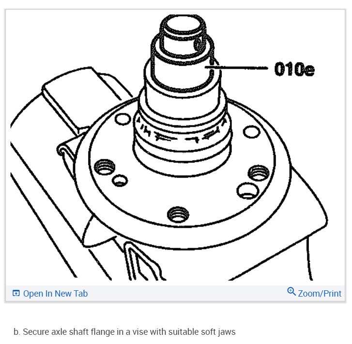

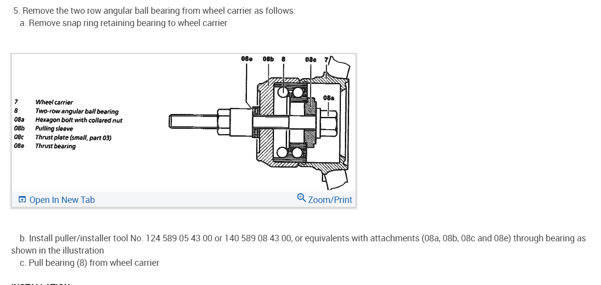

Yep, it sounds like a rear axle bearing is going out. Can you please shoot a quick video with your phone so we can hear the noise? That would be great. You can upload it here with your response.
Here are diagrams and a guide to help you see what it will be like to change it out:
https://www.2carpros.com/articles/how-to-replace-a-cv-axle-bearing
