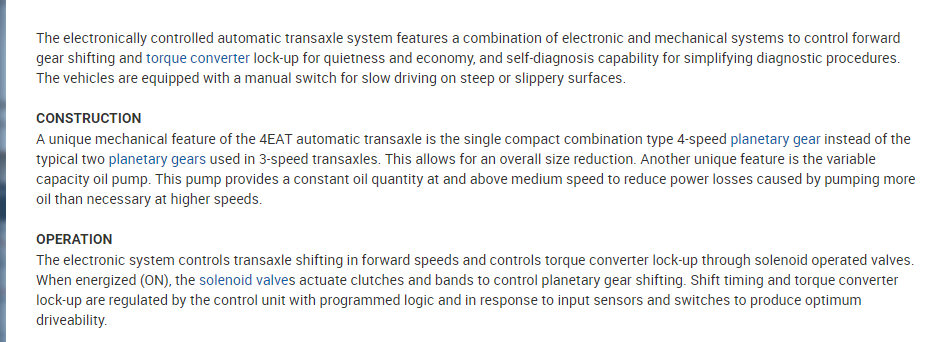

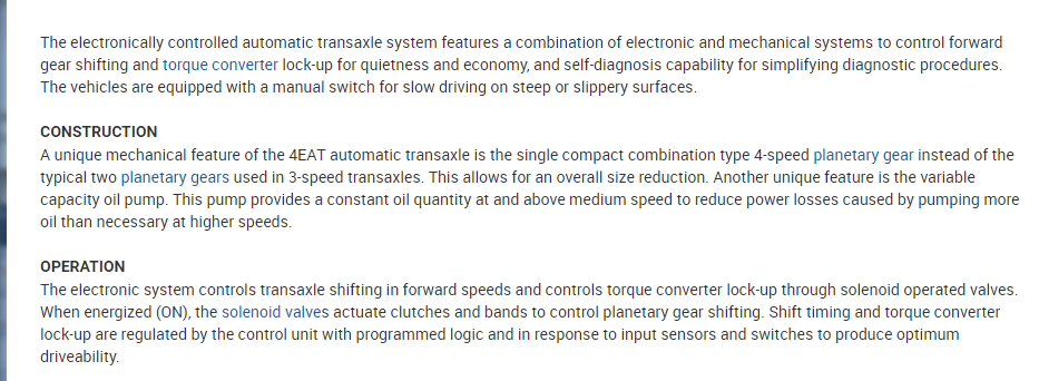

Just to be clear, you replaced the entire transmission and it still does the same thing? If that is the case then the shifter has to be the issue but it sounds like the manual valve is moving if the RPM is changing when shifting gears.
Do you know what transmission you have? Is it the 4EAT?

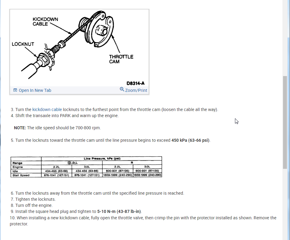

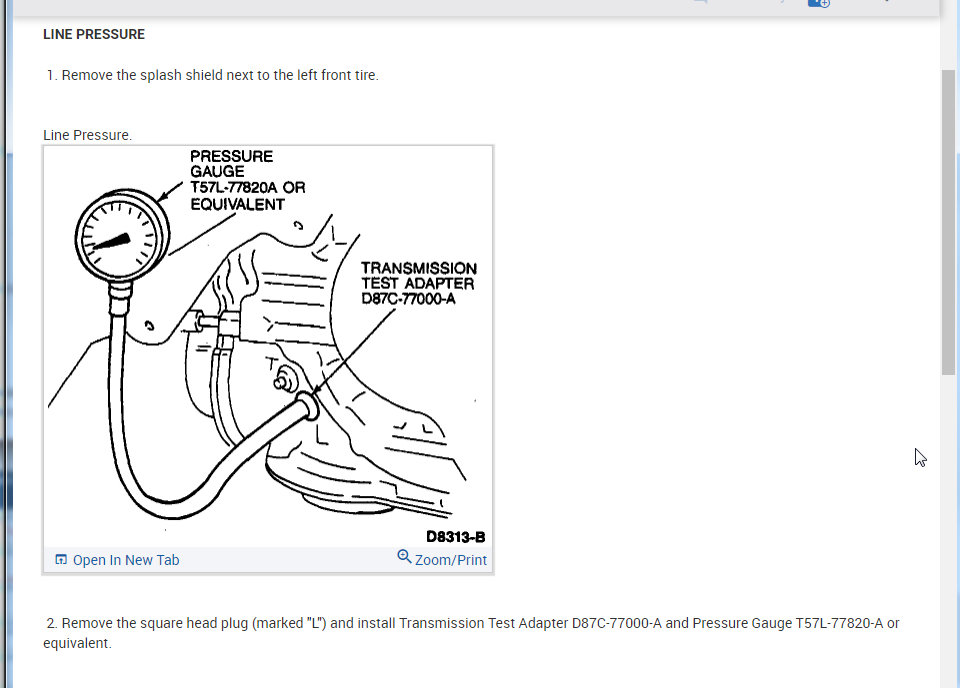

We need to check the line pressure and make sure this is correct as well. Was there anything that you transferred over from the other transmission?
I attached the info on this below for your review.
Let me know about this info and we can go from there. Thanks
