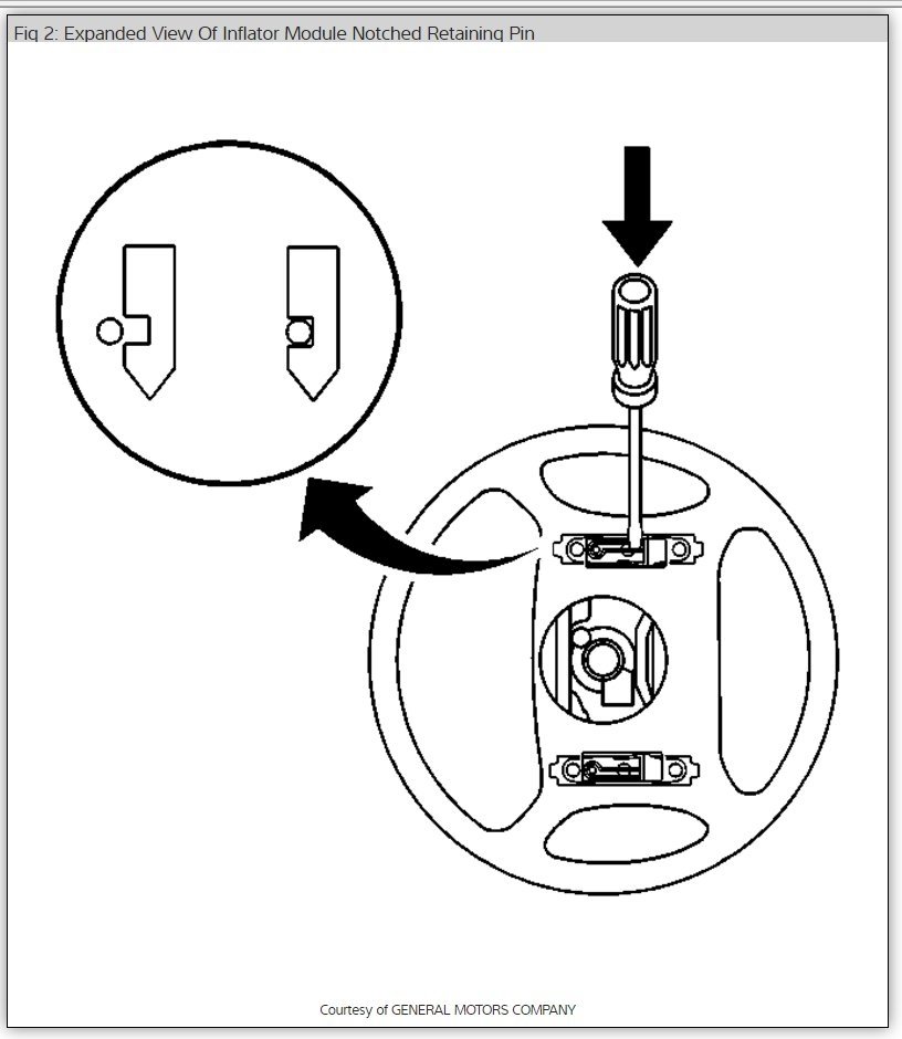

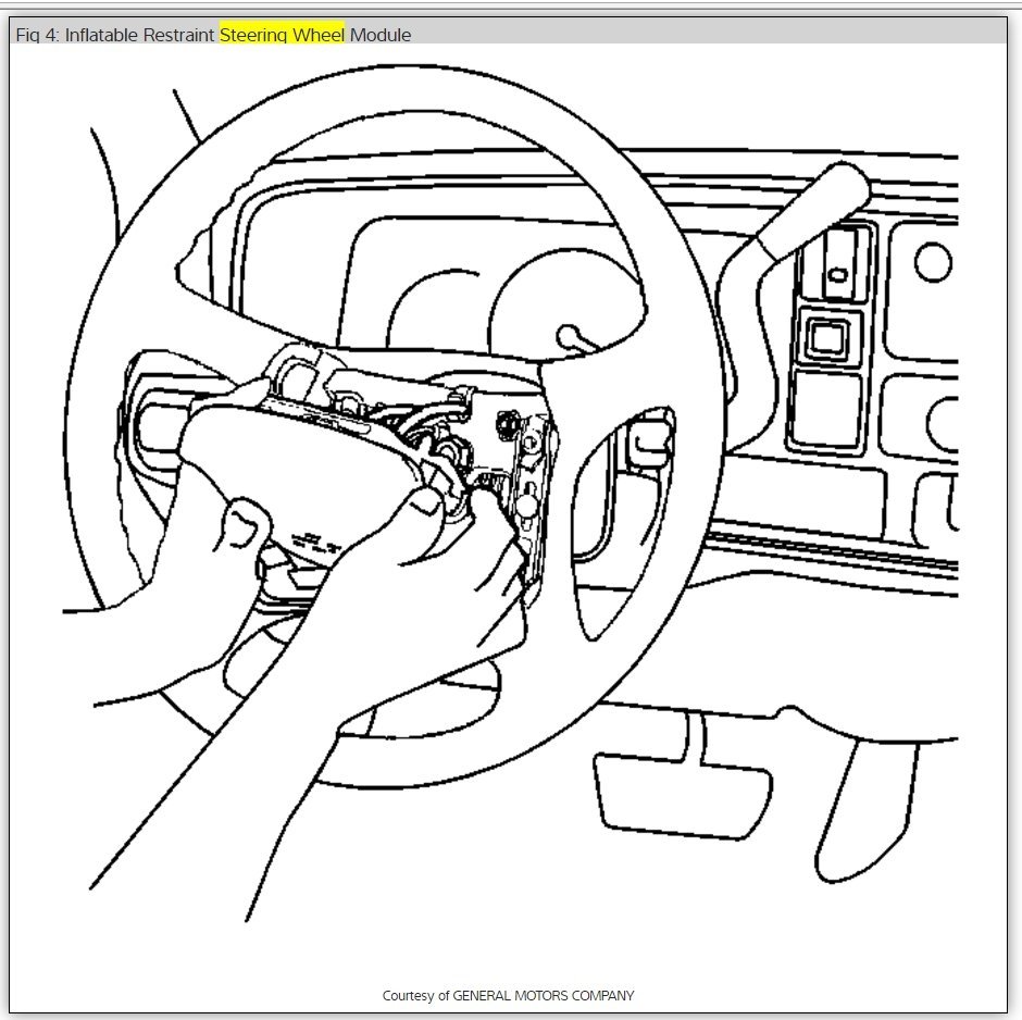

Security light flashing car does not turn.
Saturday, July 28th, 2018 AT 8:56 AM
KEN L
  • MASTER CERTIFIED MECHANIC
  • 48,363 POSTS

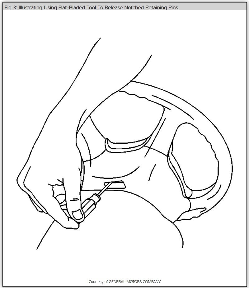

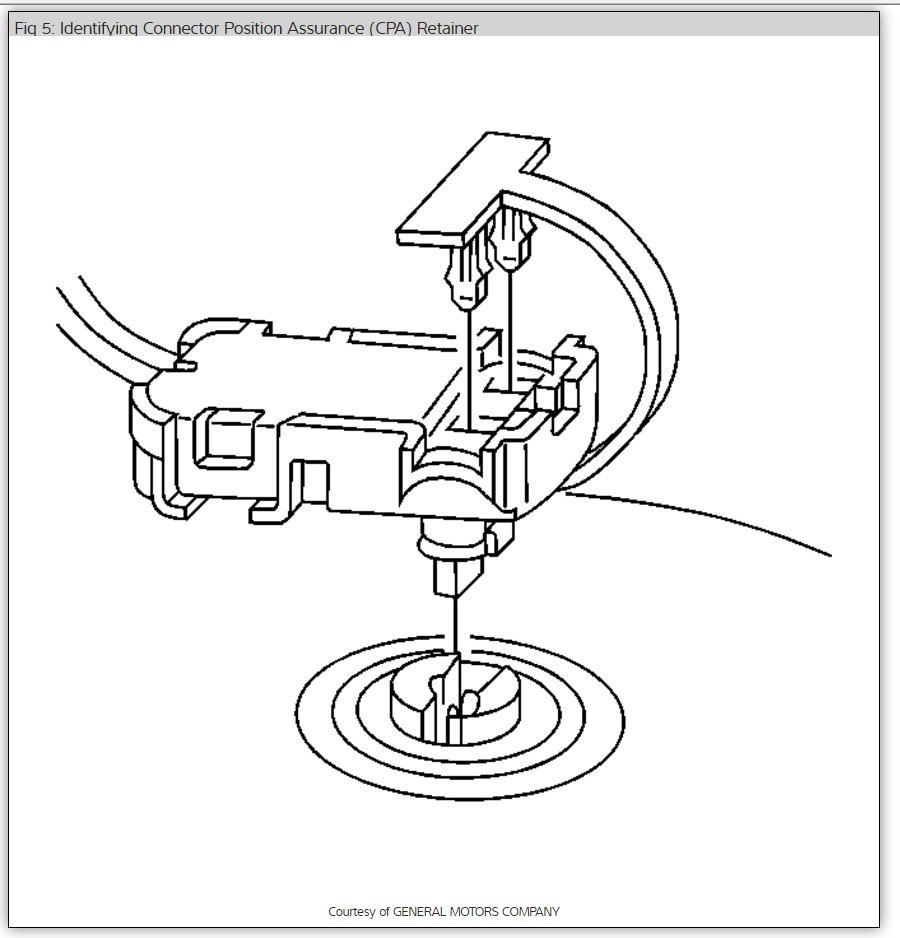

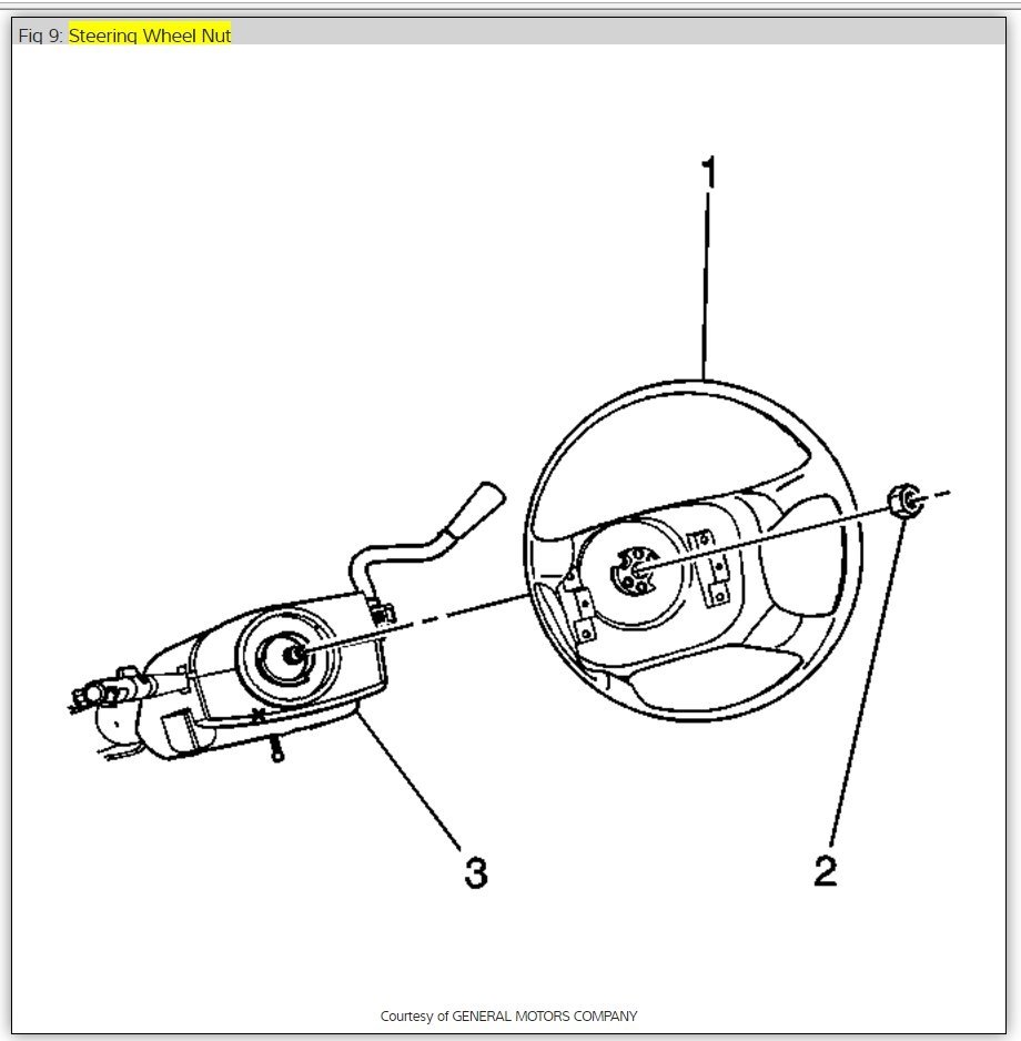

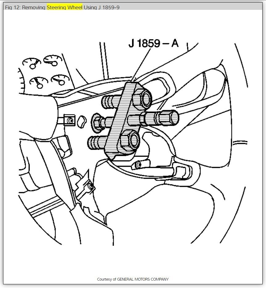

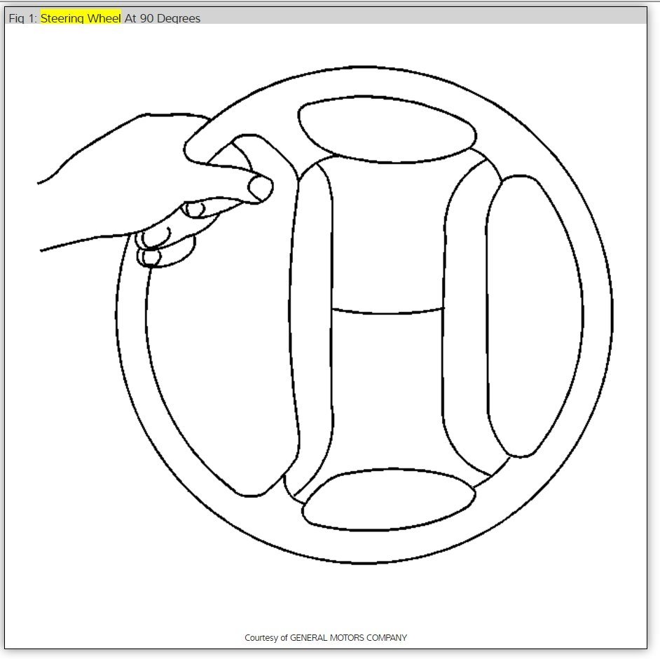

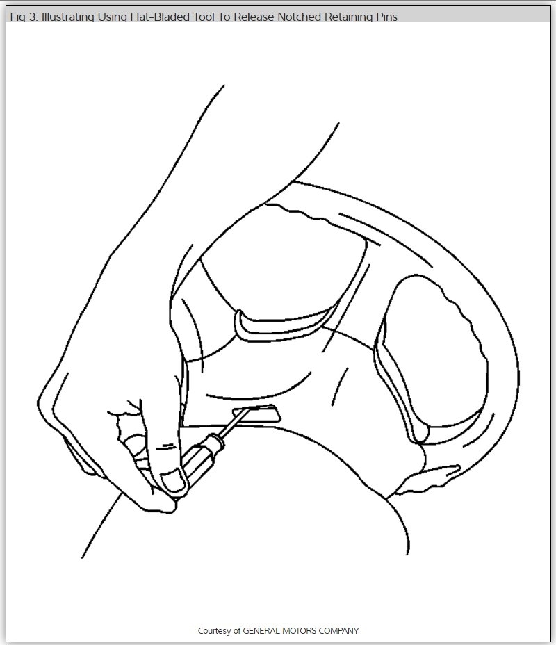

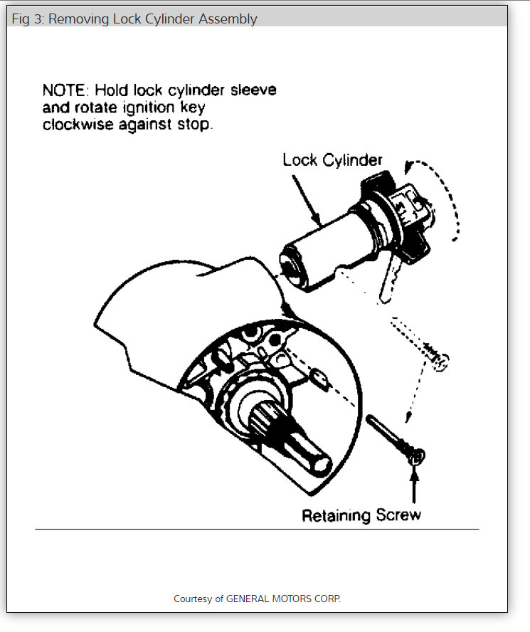

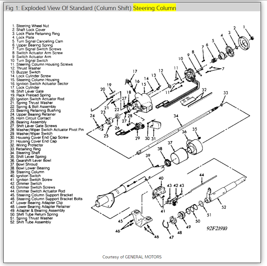

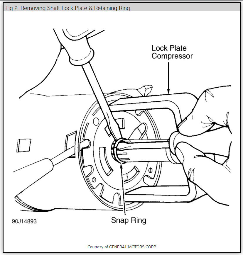

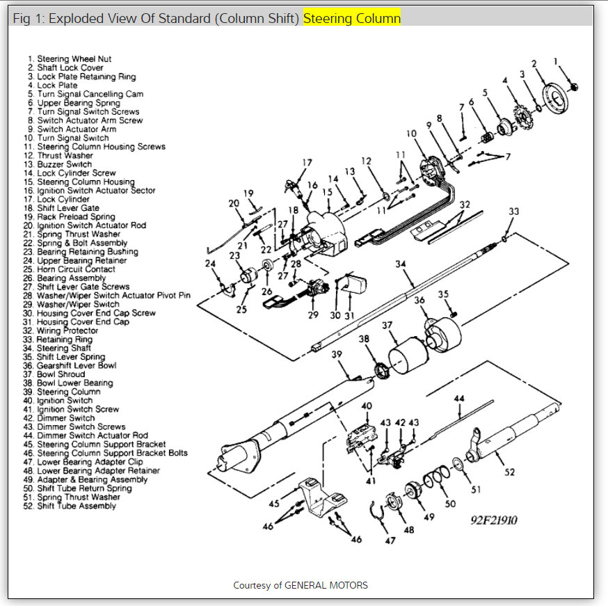

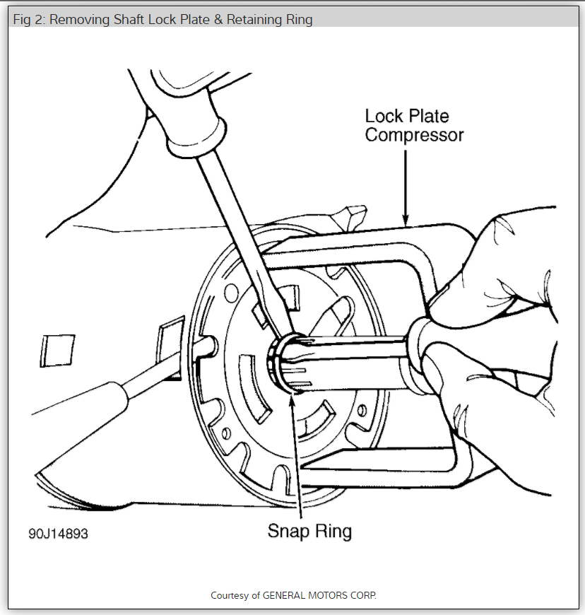

This happens when the small wires the connected to the ignition switch break which is common. Here are guides to help you see how to get to the wires so you can confirm the issue.
You will need to remove the steering wheel as well
