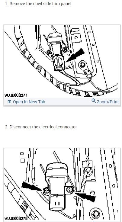

Car cranks but won't start without starter fluid. Runs fine after starting but after turning off and trying to turn on again, it won't start without starter fluid. We've replaced the fuel pump, fuel filter, fuel pressure sensor, spark plugs, fuel injectors, coils and intake gaskets.any ideas on what else it could be?

Did you also replace the fuel pump control module under the left rear seat? From your description it sounds like the pump isn't engaging to prime the system, but once the engine starts running and the ECU gets an oil pressure signal the pump starts working. You may also want to check if the inertia switch in the passenger cowl area has a problem. It can also shut off the pump to keep it from priming.
