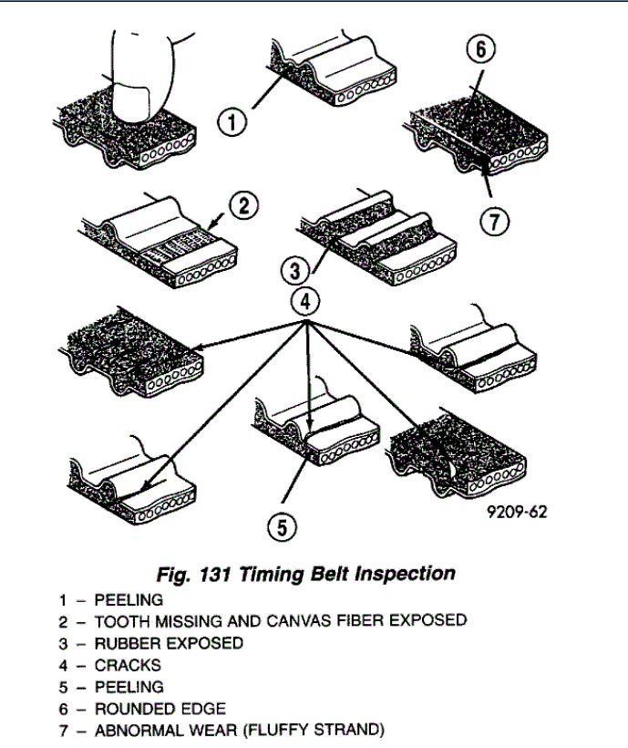

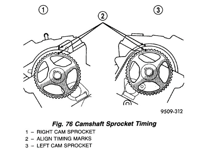

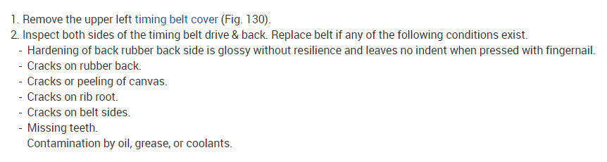

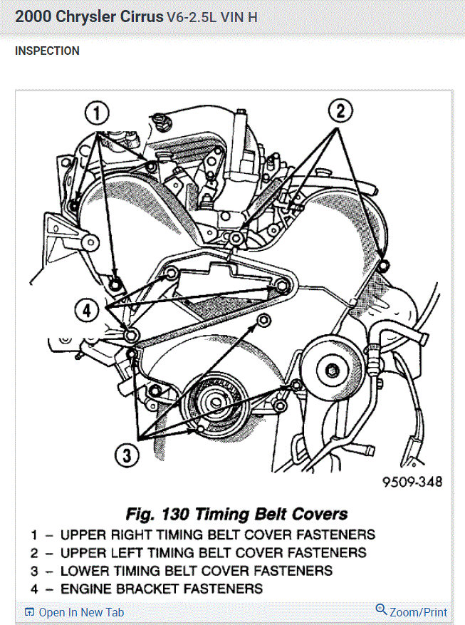

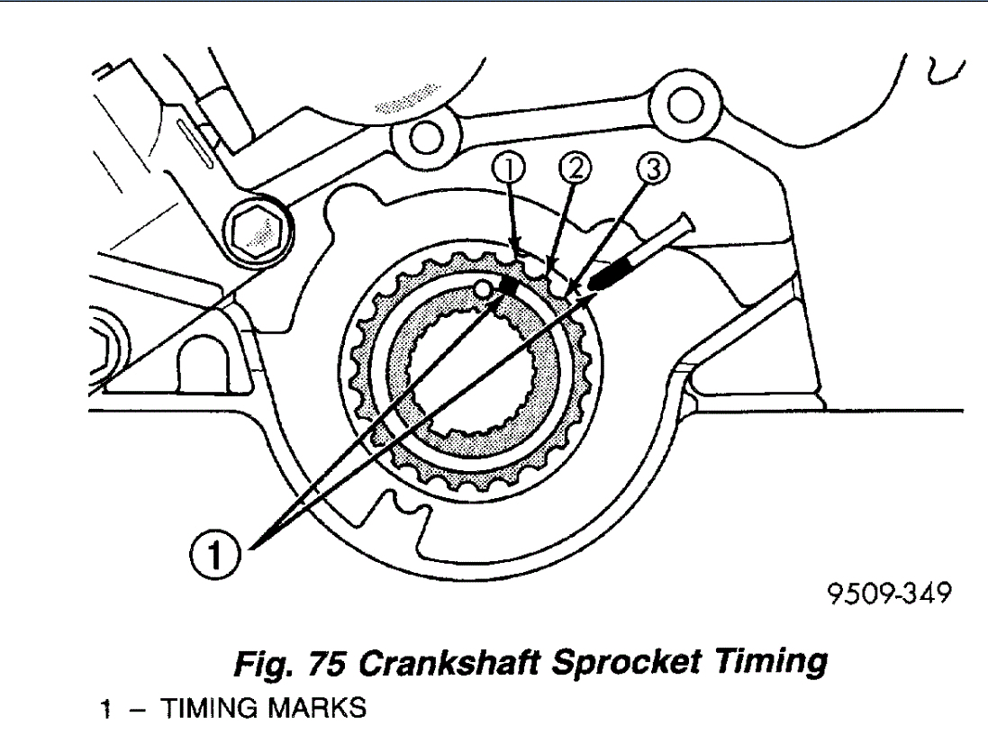

It was hard to hear, but it sounds like either the timing belt jumped or has broken. It sounds like it has no compression when cranking. Can you have a helper crank the engine while you record near the engine?

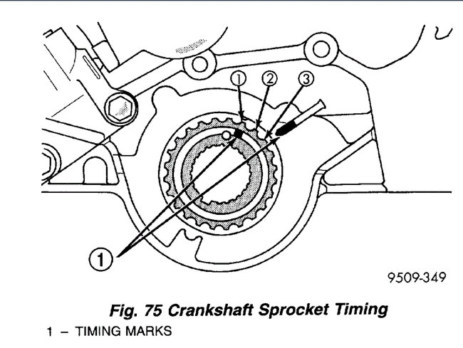

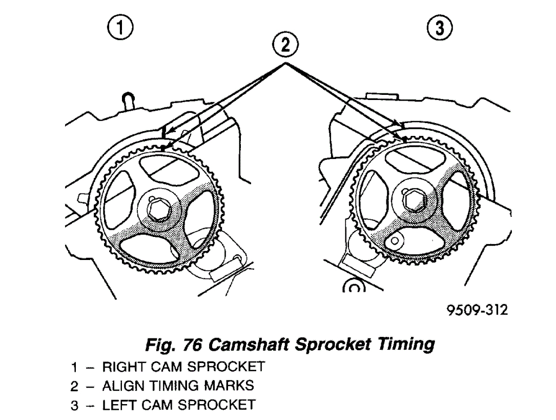

If you look below, pic 1 shows the timing mark locations for both cams and the crankshaft. The remaining pics are for inspecting the timing belt.
Note: The 2.5L V6 is an interference engine. If I am correct about timing being the issue, there is a good chance that internal engine damage occurred. We will cross that bridge when and if we get to it.
Let me know what you find or if you have other questions. Also, if you could get a better recording, it will help.

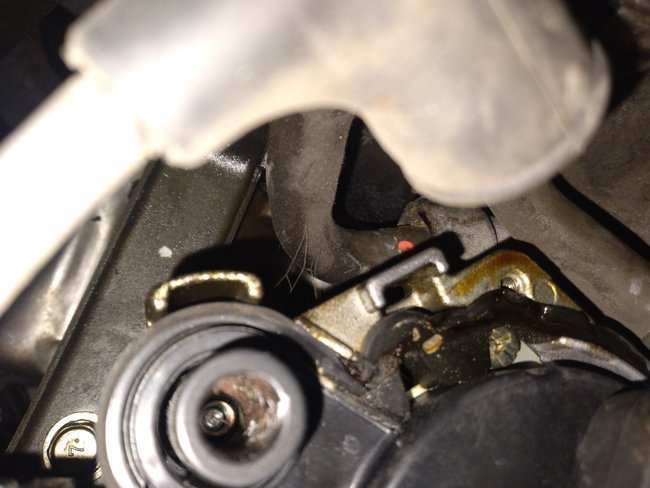

Timing marks seem to be correct/they line up with each other. I don't have anyone hear that can crank the motor while I record. I will upload a video when I can get help. How does timing jump? When my car lost power on the freeway when oil shot out, and I had no response from my gas pedal. Could it have jumped timing then?

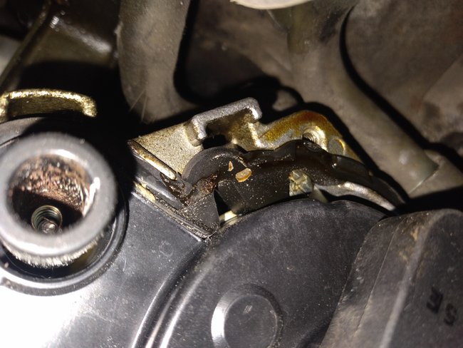

I removed my distributor cap to see if oil had gotten inside, it from the mishap on the freeway and I did see oil inside. The oil has been sitting in there for a couple of months. I hope I just found my problem. I sprayed it with electronic parts cleaner. About to hook everything back up and see if it fires up. Is there a way to test the distributor? I'm getting weak spark as of now. Don't want to buy a new distributor if it doesn't start and end up in the same boat.

Could not get any better pics. Sorry

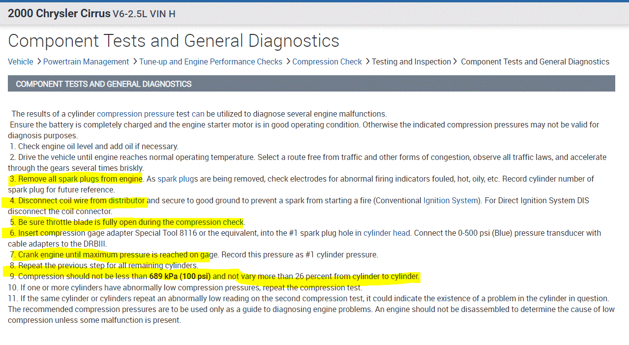

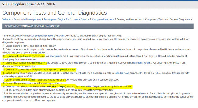

What I recommend is to do a compression test. It's possible that oil got on the belt and caused an issue. I would like to have a better recording to confirm, but I understand why at this time you can't get one.
Do me a favor. Perform a compression test on the engine. You will need a compression gauge, but most parts stores will lend you one free of charge. Also, here is a link that shows how to perform the test:
I attached info from the manual specific to this vehicle for testing. It includes the minimum pressure specs. It does say to run the engine until warm, but we can't do that in this case.
Let me know what you find. Also, I'm not trying to pull you away from what you are checking. What you mentioned makes good sense. However, to a trained ear, the timing sounds like the problem. (I could be wrong. I've been wrong before and will be again at some point) LOL But this is what I believe is the problem. The compression test will confirm it for me.
