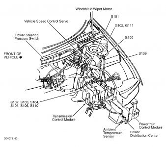

Although the symptoms are pointing to the fuel pump, I would still follow the basic diagnostic.
Backing up what my colleague is saying, you may also want to check your ASD relay under the hood. This relay powers the fuel pump and ignition system. It is inside your power distribution center under the hood.
https://www.2carpros.com/forum/automotive_pictures/55316_00cirrus_1.jpg
