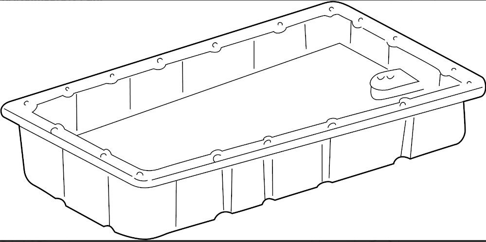

There are two pans that are under the truck one is the transmission fluid, and the other is the oil pan. Last time I did my own oil change and was not sober enough to change the oil and i apparently drained the wrong pan. Please help!
Jan 29, 2023 at 7:16 PM
  • 110,194 POSTS
As far as the pans are concerned, the transmission pan will be behind the engine oil pan. I was able to find pics of the pans.

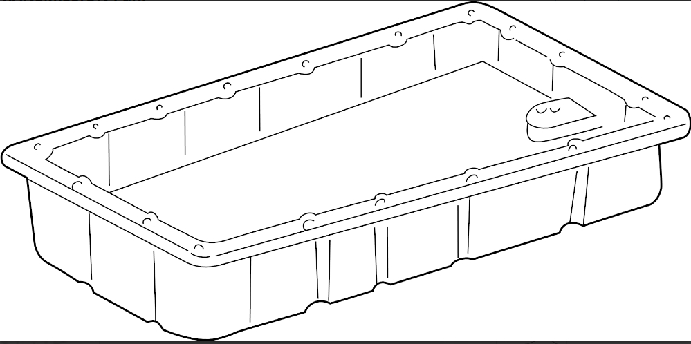

The transmission pan will be rectangular. See pic 1.

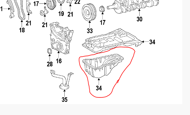

The engine oil pan is also rectangular, but it tapers up at the rear. See pic 2.
Let me know if this helps.

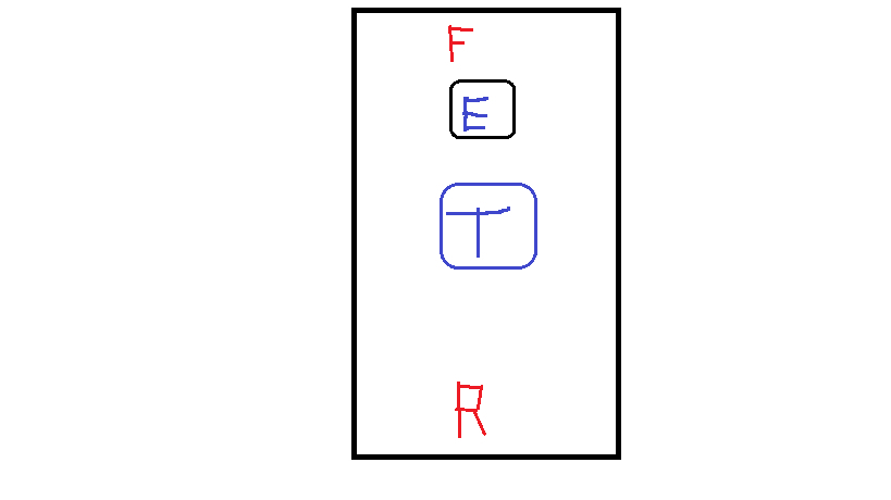

So, you’re saying the oil pan is more towards the rear of the truck? Or if need be I can take a picture of under the truck.
Feb 2, 2023 at 5:58 AM
  • 110,194 POSTS
Yes, you can send a pic. Also, and don't laugh, I tried to draw a pic of the location.
F= Front of vehicle
R= Rear of vehicle
E= Engine oil pan
T= Transmission pan
See generic pic below. LOL
