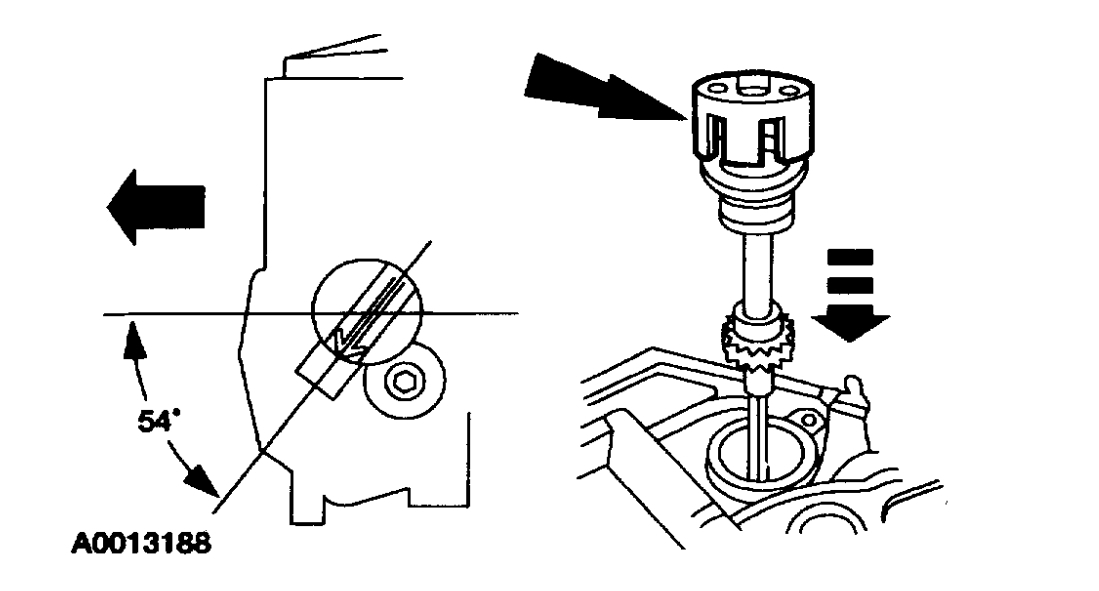

At a local Ford dealer, the mechanic removed the synchronizer to change the sensor. He did not mark it, now it runs worse than it did before. What is wrong with it?

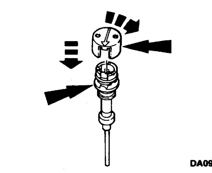

INSTALLATION
1. Install the Synchro Positioning Tool on the camshaft synchronizer by rotating the tool until it engages the notch in the camshaft synchronizer housing.
CAUTION: A Synchro Positioning Tool must be used during the installation of the replacement synchronizer assembly. Failure to follow this procedure will result in the fuel system being out of time with the engine, possibly causing engine damage.
2. Install the camshaft synchronizer housing assembly so the arrow on the Synchro Positioning Tool is 54 degrees from the centerline of the engine.
NOTE: During installation, the arrow on the synchronizer alignment tool will rotate clockwise as the gears engage.
