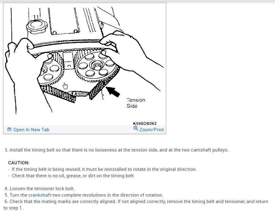

Does anyone know where I can buy the tool that holds the camshaft sprockets while replacing the timing belt? I can't seem to get the valve timing just right so I got starting issues. Either one or the other of the two gears seems be out a tooth. I can't hold both gears and put the belt on at the same time without one of the cam gears turning on me just enough to mess up timing. So I'm looking for the name of the tool and where I can buy it?

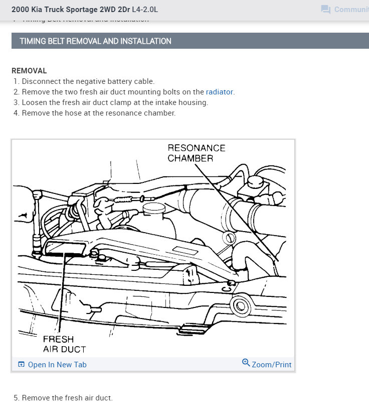

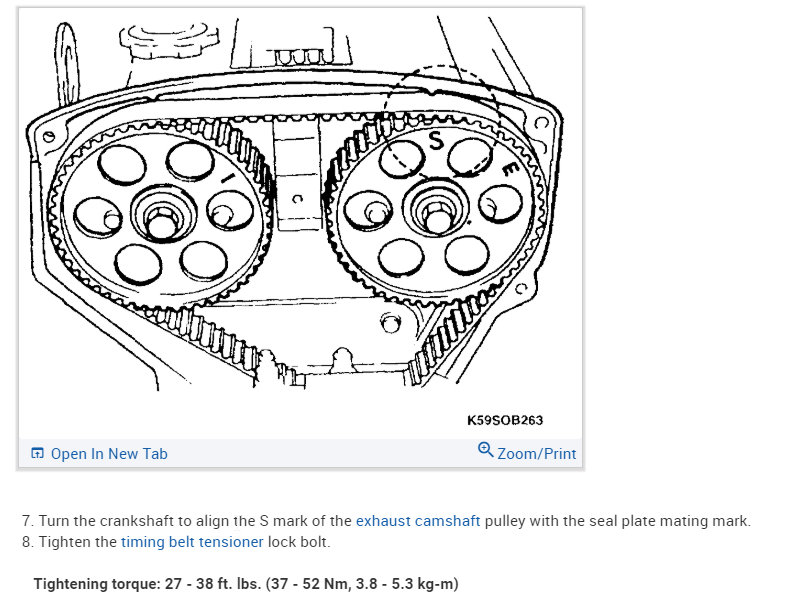

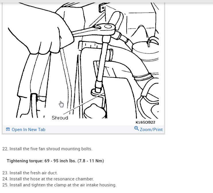

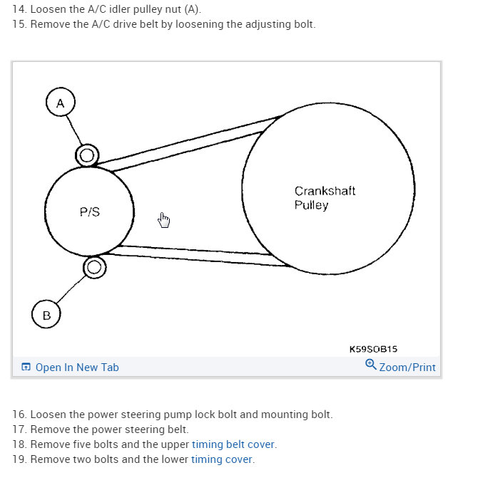

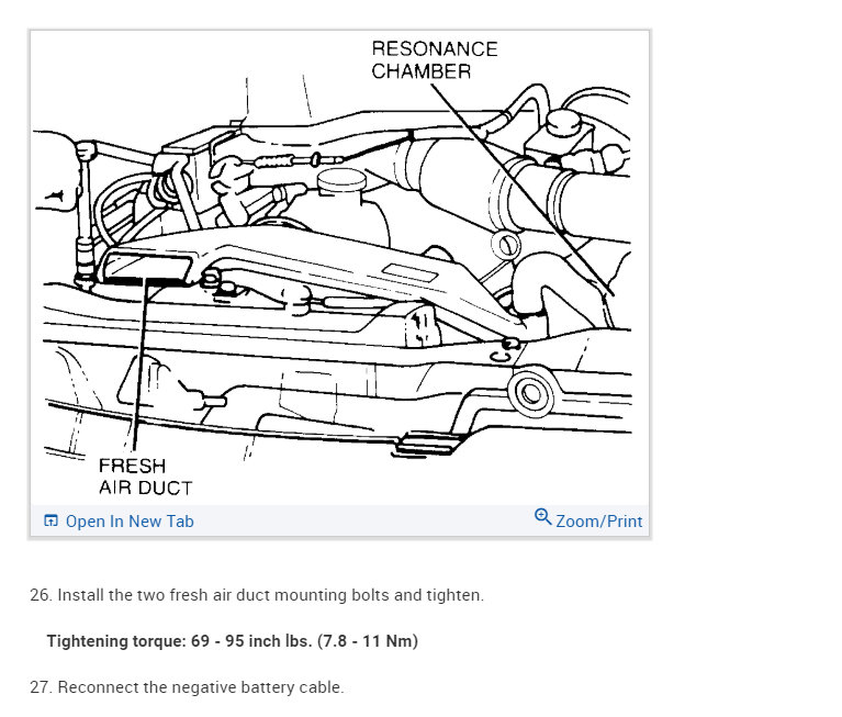

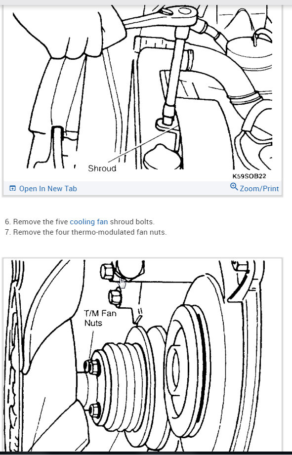

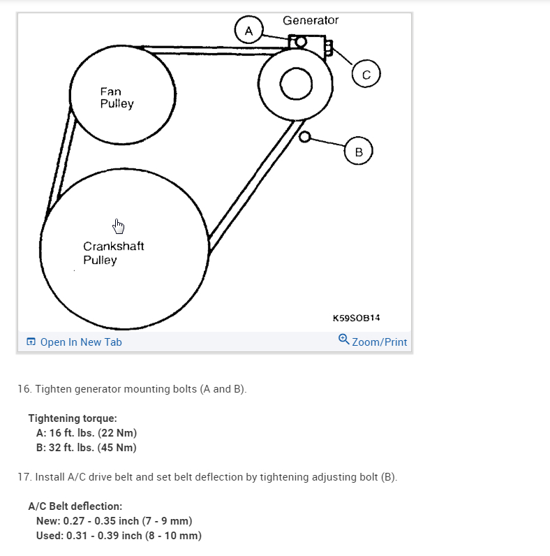

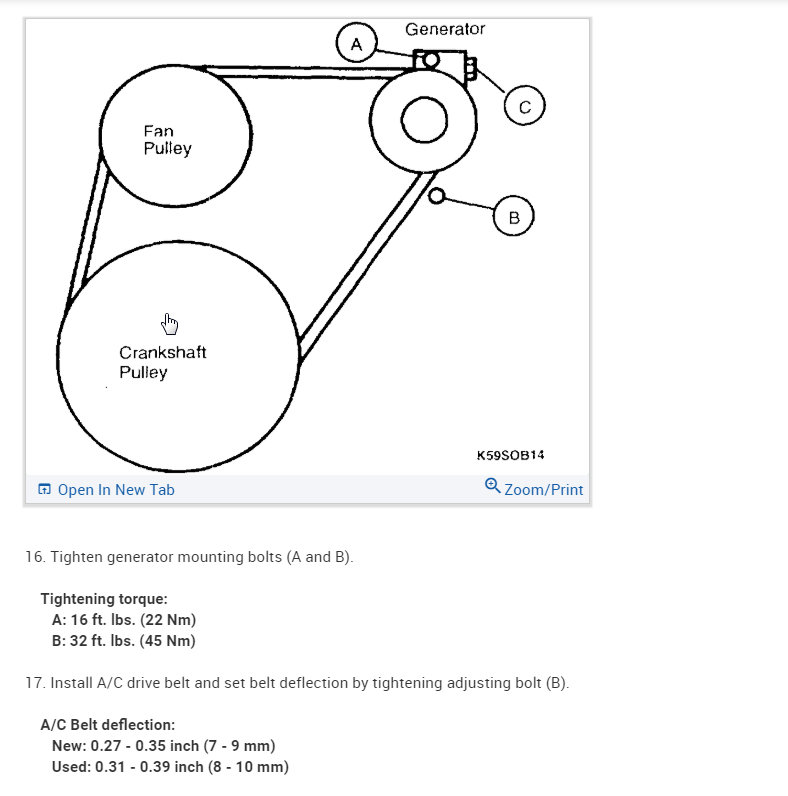

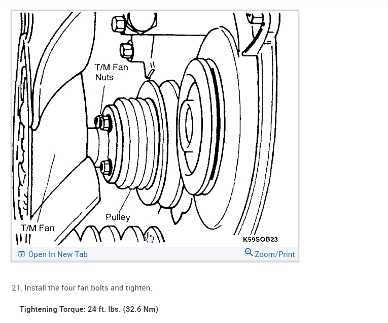

Hi JCLEMO,

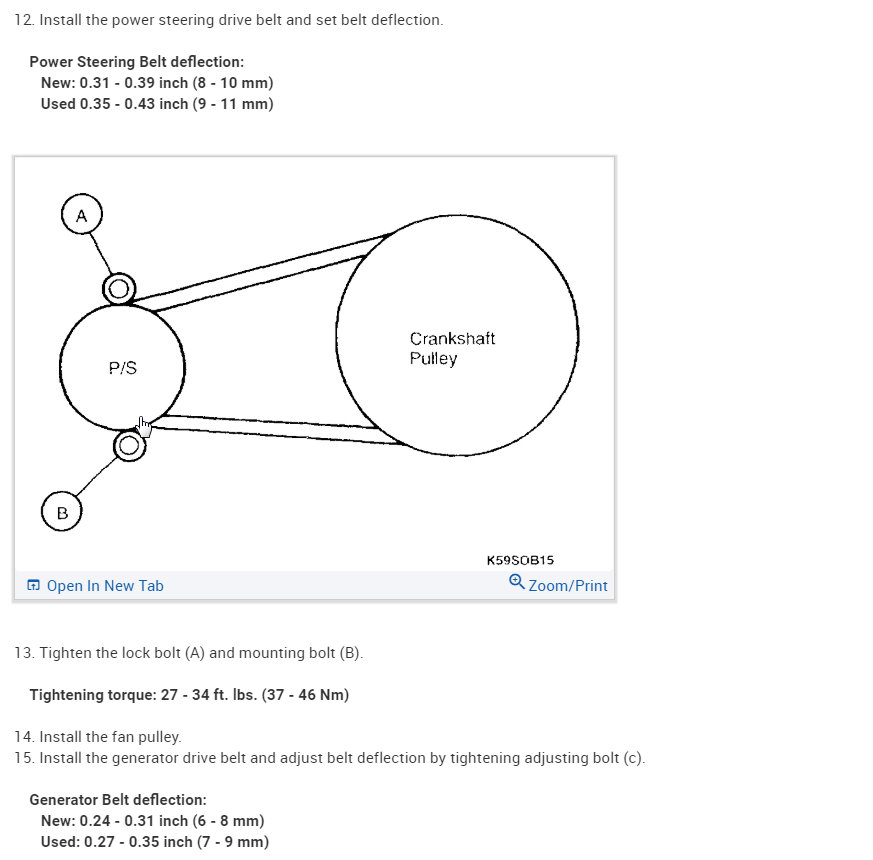

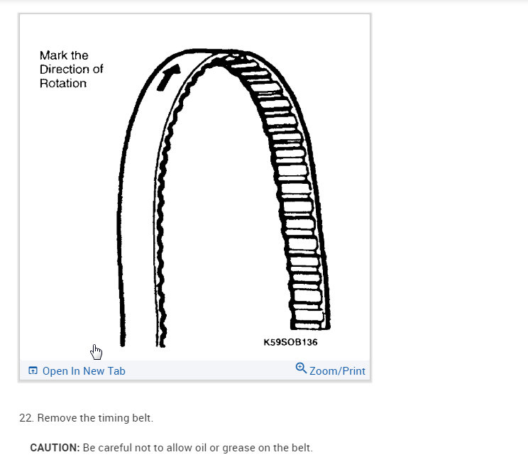

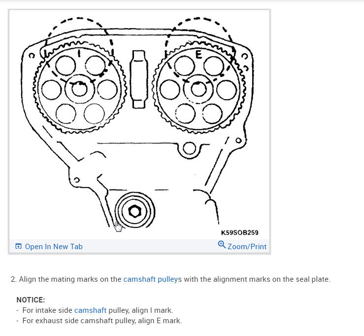

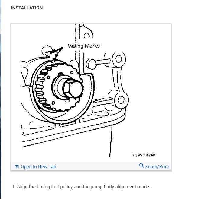

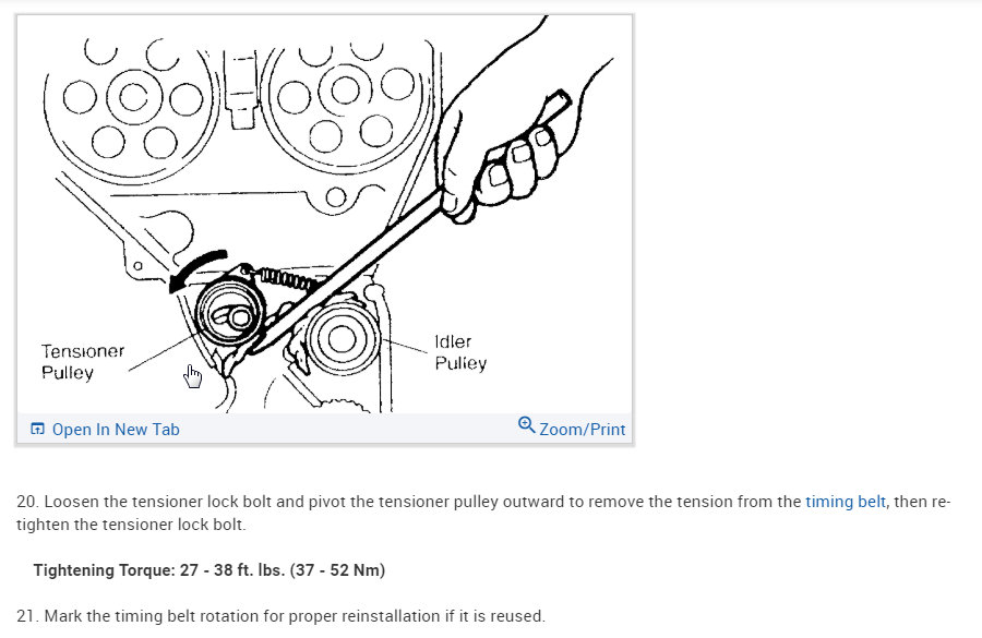

Normally, overhead cams have a holding tool but this one does not. I included the procedure. I suspect you are having an issue on Step 3 where it says to install the belt so that there is no looseness on the tension side. If this is not done then the cams will move.
Look over the process and let me know if you have questions. Thanks
Jun 29, 2019 at 11:12 AM

Which diagram should I be looking at? I've had this belt off and back on five times today and I don't see anyway of keeping these from moving if but just one tooth enough to mess things up.
Jun 29, 2019 at 11:22 AM
He posted the entire procedure for replacing the belt.
You have already done that procedure. The marks are the same as I posted on out other question.

That is because there is too much slack in the belt. With the tensioner installed. there should be no slack at all.

There's no slack in the belt now. but I'm still of a tooth off and every time I take the tension out of the belt and try to turn the cam back or forward a tooth it's not loose enough. so I take the whole belt back off and right back to square one. I'm going to Harbor Freight and try to find the right kind of tool to fit this thing I don't have a clue what I'm looking at. But have no help I mean physically help to hold a socket on it while I do the belt
Jun 29, 2019 at 11:46 AM
You can slide the belt forward of the gear and move it the tooth and slide it back on.

I got a question for you.
When bringing your cam gears upon the backing plate marks if you aren't very careful the gear will jump forward past the mark and you hear a loud click. Why is that? I'm guessing it's an indication the valve or valves have either opened or closed. And when your marks are aligned properly in what position are the valves under the cylinder? My son is coming all the way across the state from East coast today to hold the ratchet for me. I hated to ask him to do that but I live deep in the country pretty isolated so it's really my only option. I really hope this works and that this is the problem. It ran fine when I parked it and decided to change the belt. The bad thing is the belt looked fine but I didn't like the looks of the tensioner. Okay, thank you.
Jun 30, 2019 at 12:22 AM
Yes, the clicking is the movement of the valves. It will not do it when it is spot on alignment.

Hello Roy, I got the timing right finally, starting up like it should. what I had to do was loosen the belt enough to turn the crankshaft back to 12 o'clock position and that made the difference. But I've really got major issues now. I don't know how this happened but the car was at an idle and low and behold the belt jumped off. So I don't have to say anymore because you know the results. Heads re-manufactured is $800.00. Not going go there. do you have any idea what it cost to replace the valves that are bent ? Because the rest of the head should be fine being it didn't run hot. Thanks. JC
