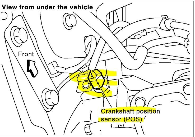

The sensor is located on the transmission bell housing, right where the engine and transmission connect. It is held in by one bolt and really isn't hard to replace.
If you want specific directions on testing it, I can provide them. Or, if you know someone that has a live data scanner, when it won't start, they can check for an RPM signal while cranking. If there is no signal, replace the sensor.
Here are the specifics on testing it. Also, pic 1 shows its location. I highlighted it.

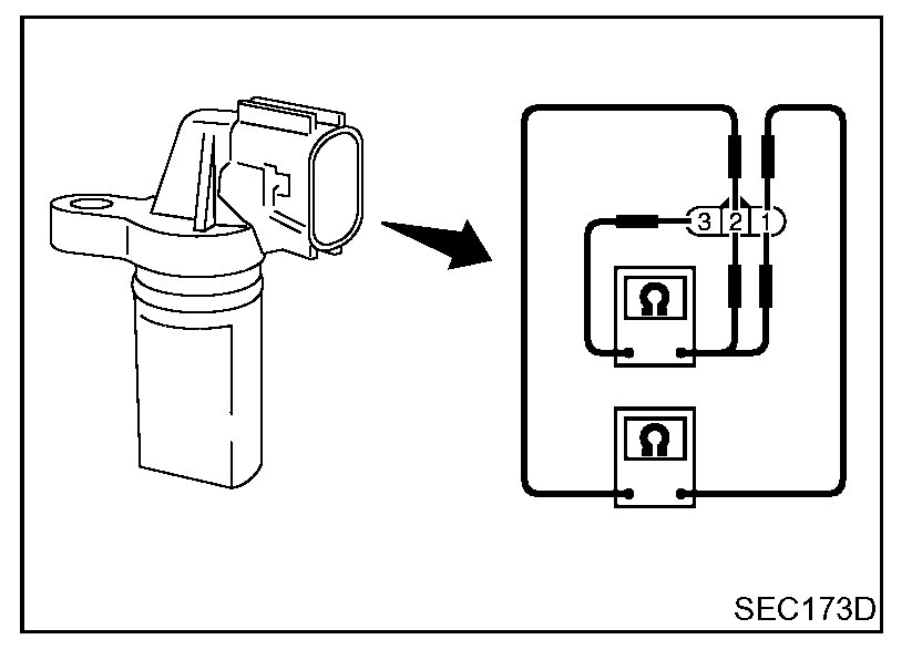

pic 2
1. Loosen the fixing bolt of the sensor.
2. Disconnect crankshaft position sensor (POS) harness connector.
3. Remove the sensor.

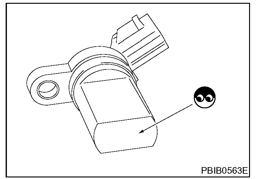

4. Visually check the sensor for chipping.

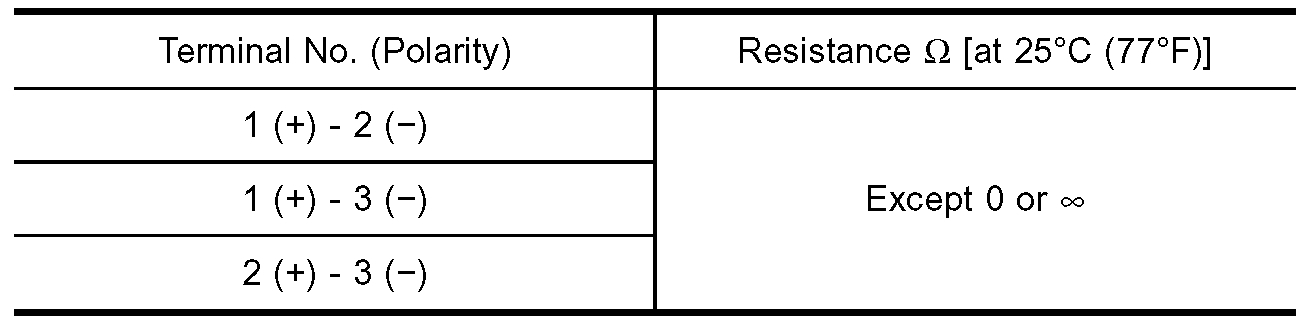

pic 3
pic 4

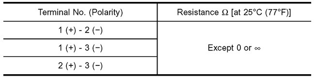

5. Check resistance as shown in the figure.
