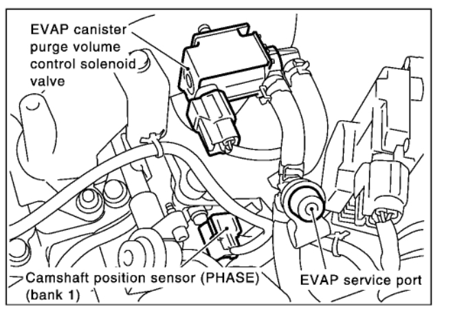

Can you send me a picture of the exact location please. Thanks.

The camshaft sensor is at the rear of the cylinder head. Here is a guide to help you see what you are in for when doing the job.
https://www.2carpros.com/articles/camshaft-angle-sensor-replacement
Here is the location for your car (below)

Where is the camshaft position sensor located on my 2003 Nissan Maxima SE.

your vehicle has 2 camshaft sensors. Bank 1 cam sensor is on rear of right cylinder head while bank 2 sensor is on rear of left cylinder head.

Is this a diy project for someone with minimal expertise I did it no problem
