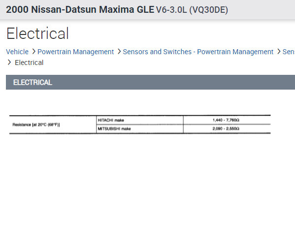

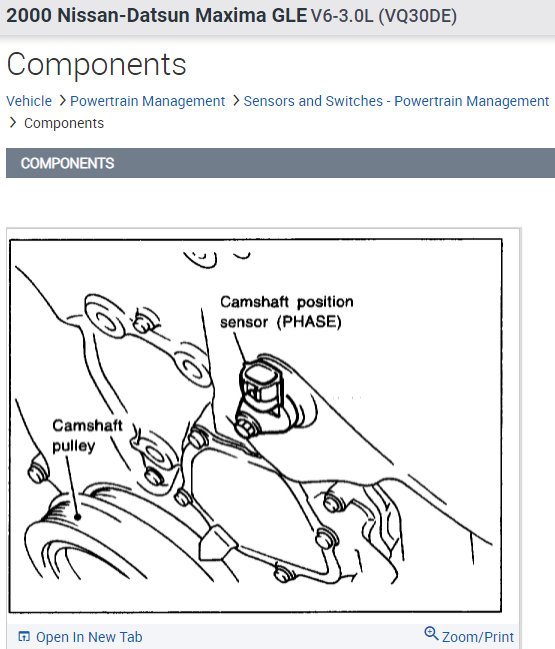

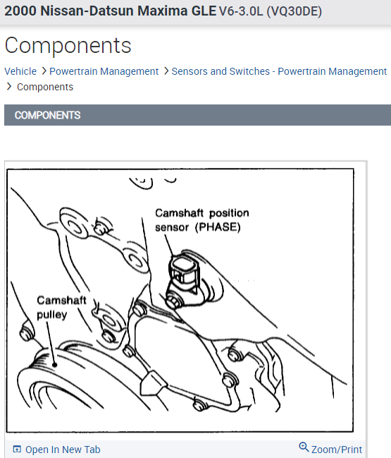

The car died and won't start. It doesn't seem to be getting any fire. I removed the cam position sensor and it checks shorted or zero ohms. Is that normal.
Aug 3, 2010 at 7:40 AM
SQM
  • 6,383 POSTS

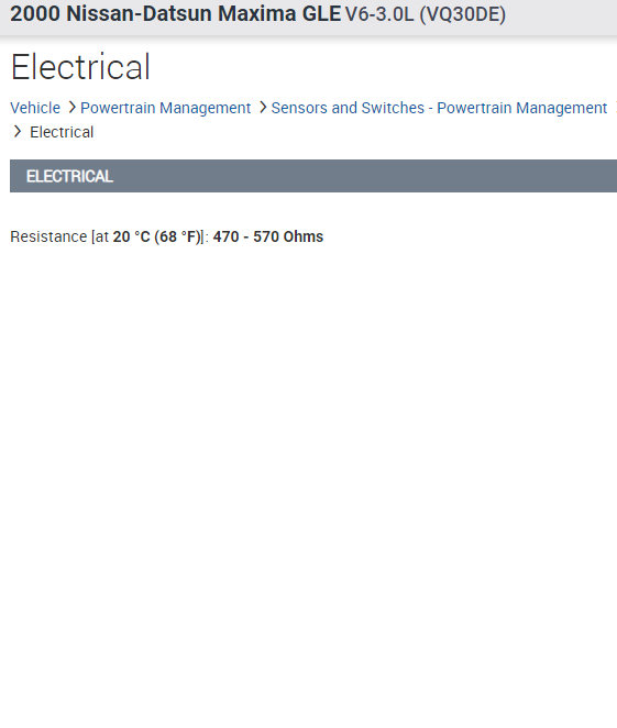

Depending on the brand of the sensor that is installed on your Maxima, the camshaft position sensor should have 1400-2000 ohm resistance.

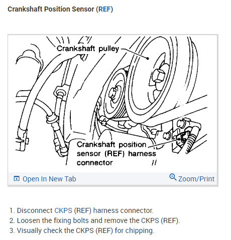

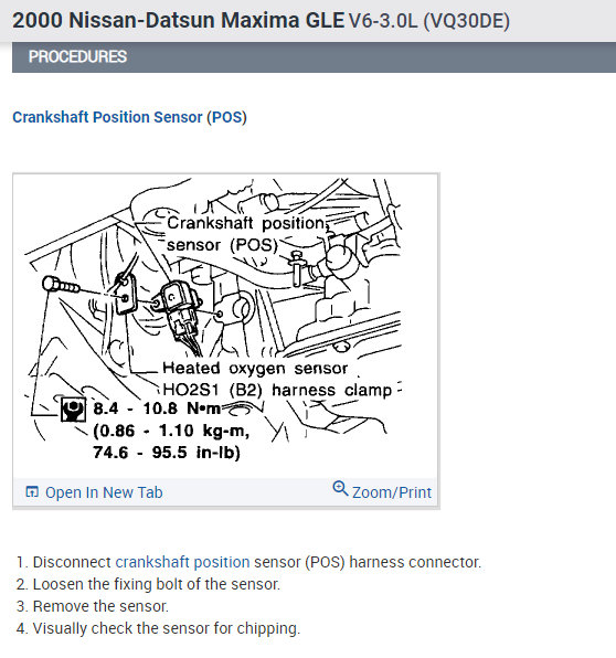

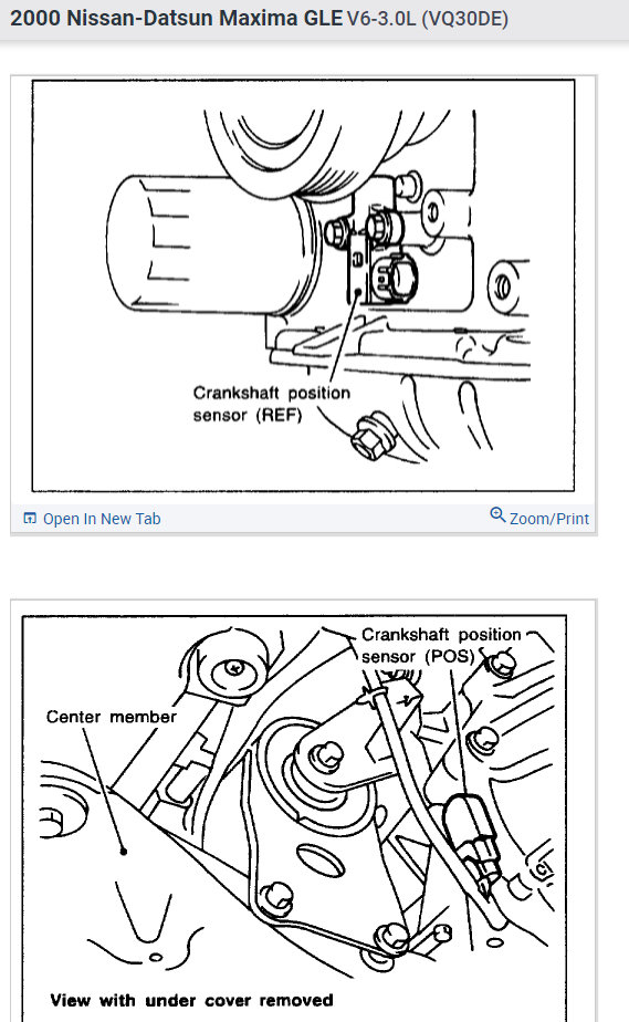

Keep in mind that typically on a no start situation it is more likely that the crank position sensor is the culprit.
https://www.2carpros.com/articles/how-a-crank-shaft-angle-sensor-works
