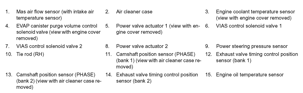

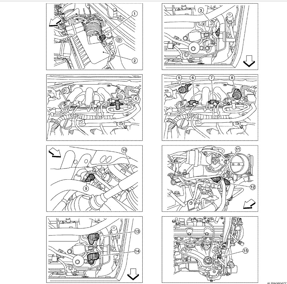

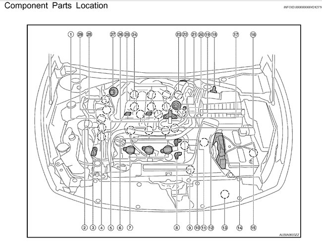

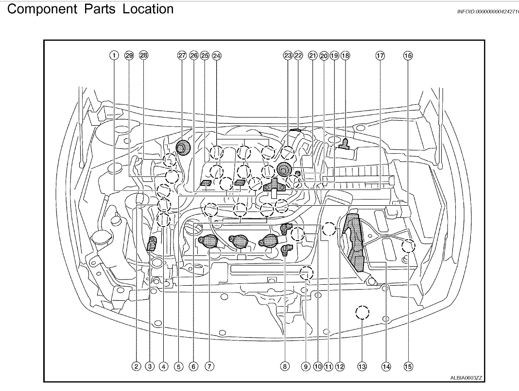

I want to know location of the camshaft sensors on car listed above SV model. Are they on the same side as the battery on? Could you send me picture of them on the car?
Apr 14, 2018 at 10:49 AM
STEVE W.
  • 15,357 POSTS
They are both on the drivers side of the engine, tucked under the air cleaner and intake. What is the code you are getting or the problem? If it is anything saying there is a timing or cam/crank problem it is not the sensors as it takes their signals to create those codes.
The timing chains and tensioners are common issues however. Those will set cam/crank codes all the time.
Apr 14, 2018 at 12:59 PM

  • 55,456 POSTS

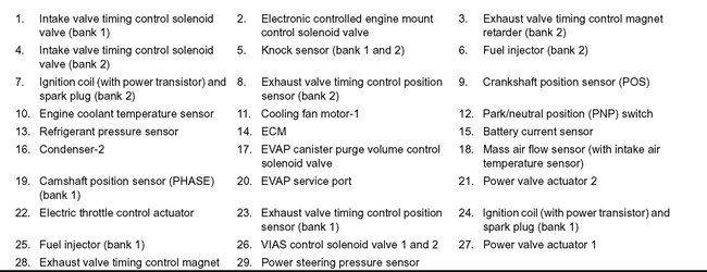

Here is a guide and the locations of the senors so you can change them out.
This will give you an idea of what you are in for when doing the job.
https://www.2carpros.com/articles/camshaft-angle-sensor-replacement

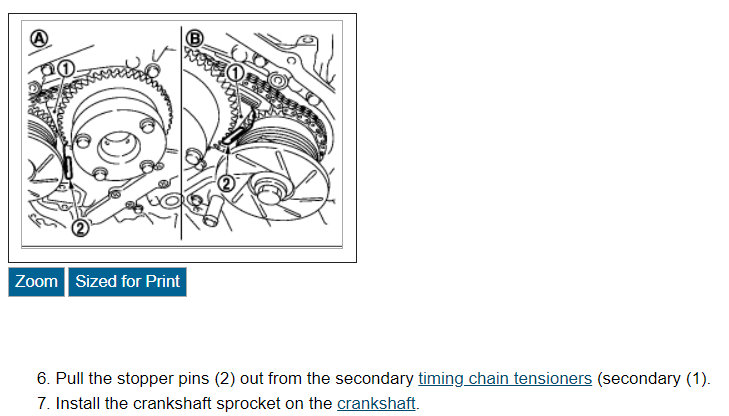

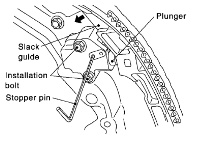

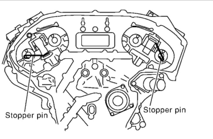

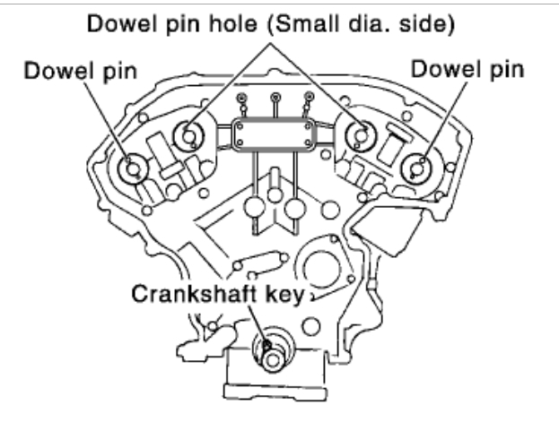

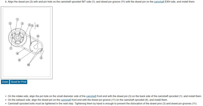

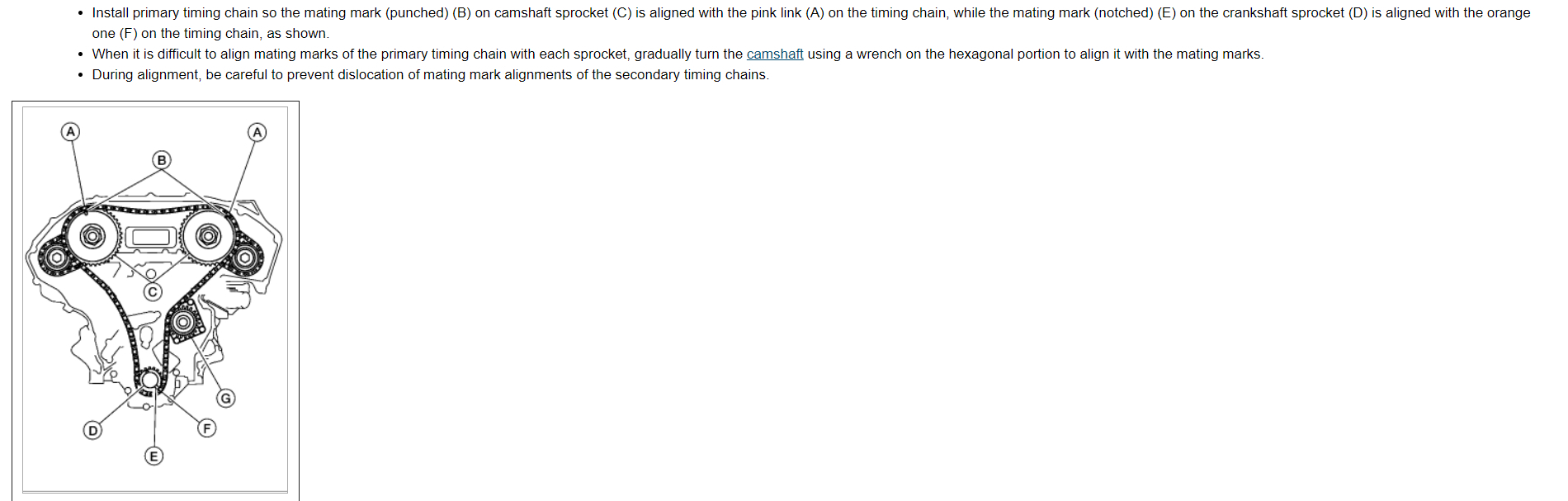

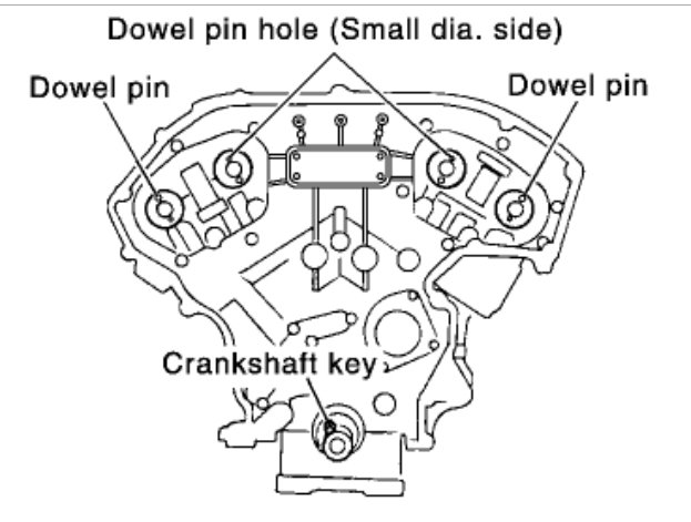

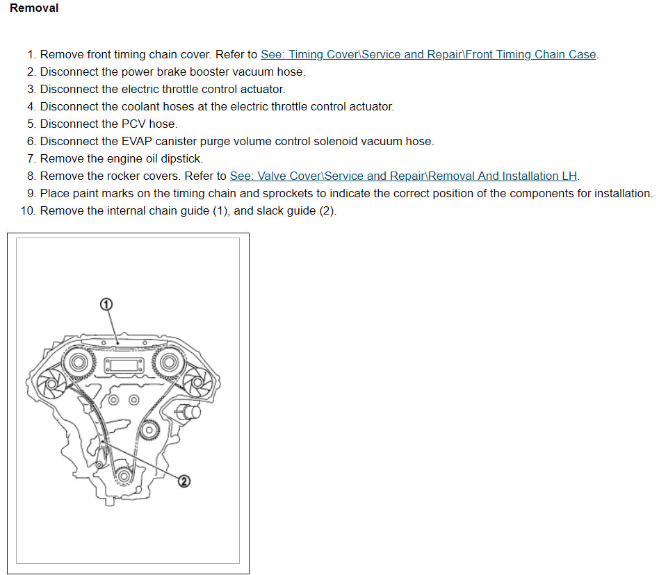

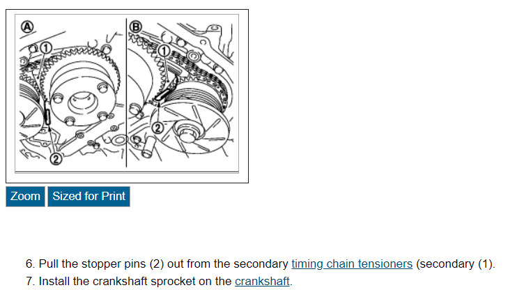

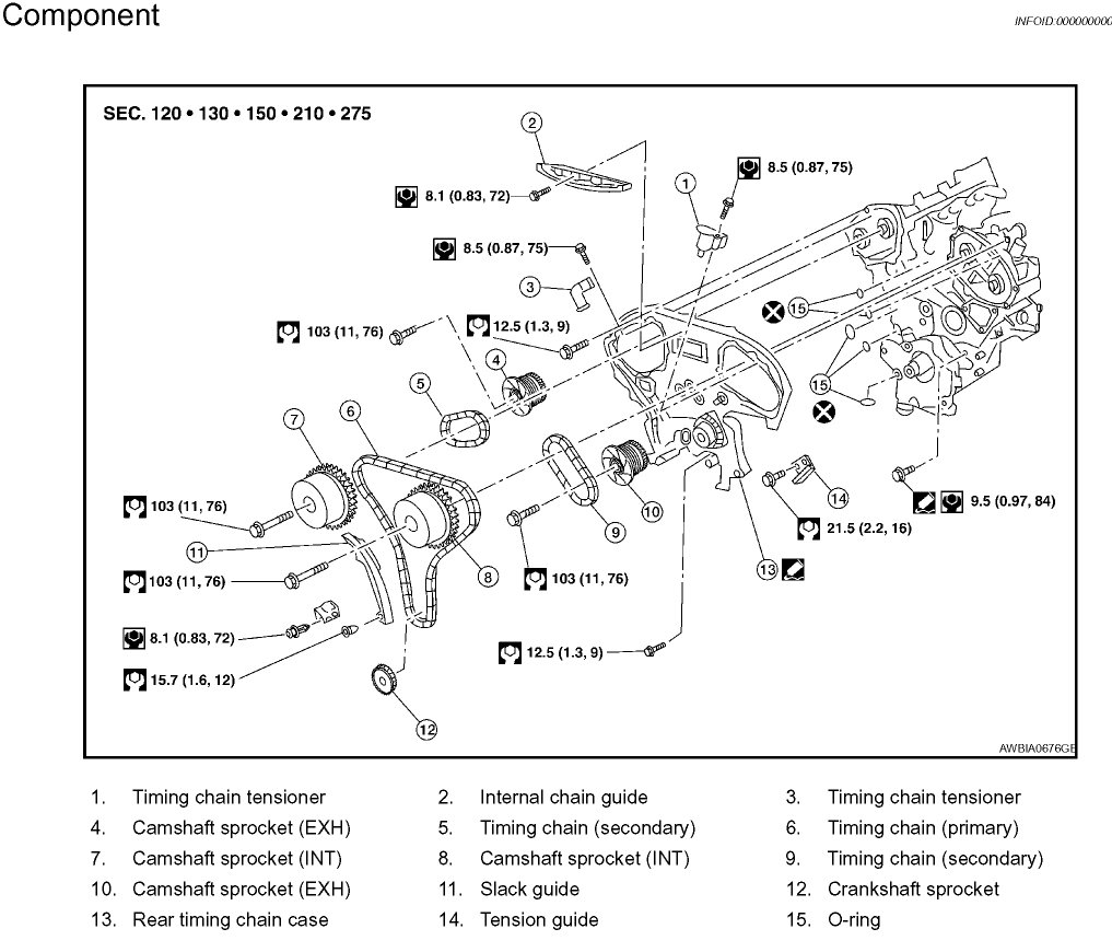

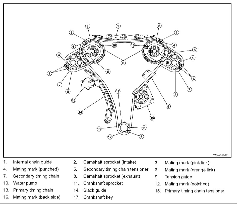

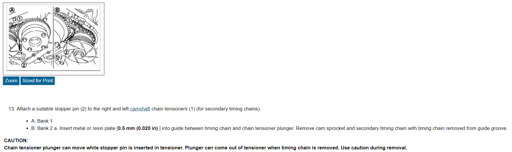

I took car to shop and had it put on machine. They said, "the timing chain is the reason for the camshaft sensor keeping coming and the knocking noise. So I need timing chains, tension-er's and the guides. But I did add some marvel mystery oil to oil and some of the noise got lower in sound.
Apr 24, 2018 at 5:39 PM

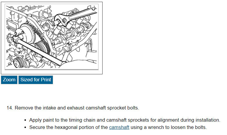

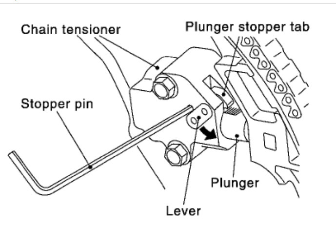

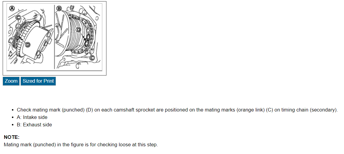

  • 55,456 POSTS

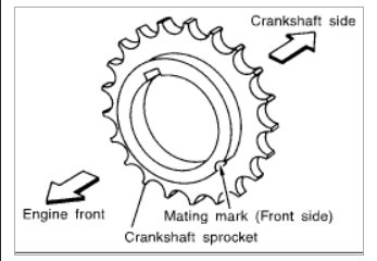

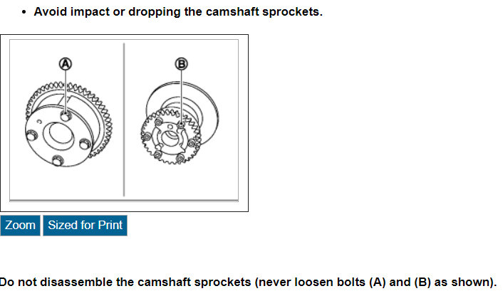

Yes, that can cause the problem, here are diagrams to help you see what you are in for when doing the job.
Apr 25, 2018 at 3:05 AM
STILLHOPING26
  • 33 POSTS
Just giving a little update. I decided to get a motor put in instead of getting the timing chains fixed. The motor has 40,000 on it.They said, it might be best. So do you know about how long it takes to change a motor out? Like the hours if you try to do it in a day?
