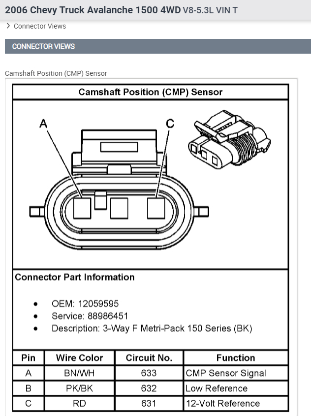

I replaced the camshaft position sensor, and the connector had some bare wires showing and they were twisted all together, so I replaced it with a new connector pig tail. So, my question is, what is the order of the wires from the connector to the sensor the wire colors are pink/black, red, and brown/white so which wire goes to which pin on the connector?

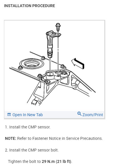

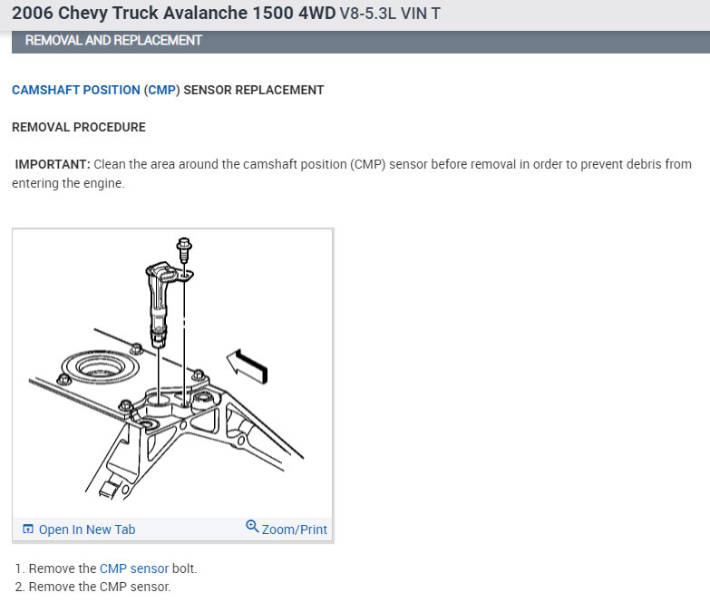

See attached for the pinout of the camshaft position sensor. It shows the color and position of the wires.
https://www.2carpros.com/articles/camshaft-angle-sensor-replacement
Let me know if you have any questions.
