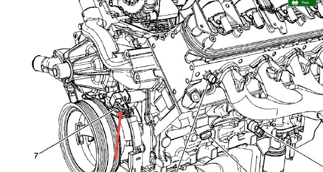

Coding P0011. Is the CMP on this engine located at upper rear of engine, passenger side, and only access is to remove the intake?

No it's on lower leh side of motor see pic

Thank you. I'd understood that location to be the Crankshaft position sensor.

No crank sensor runs off of crank by the starter
