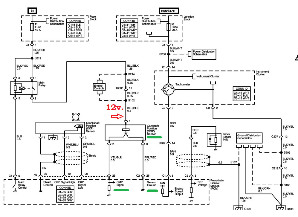

Just replaced the camshaft position sensor, now the truck runs worse, stalled two times, and was bucking picking up speed on highway, don't know what to check next. Going to put the old part back in for now, ran better with the old one. Any advice is greatly appreciated.

Hello, what engine codes were you getting, do you remember the exact number? It's possible you got a bad part, it has been happening a lot, or it could have been a circuit code and a wiring issue.

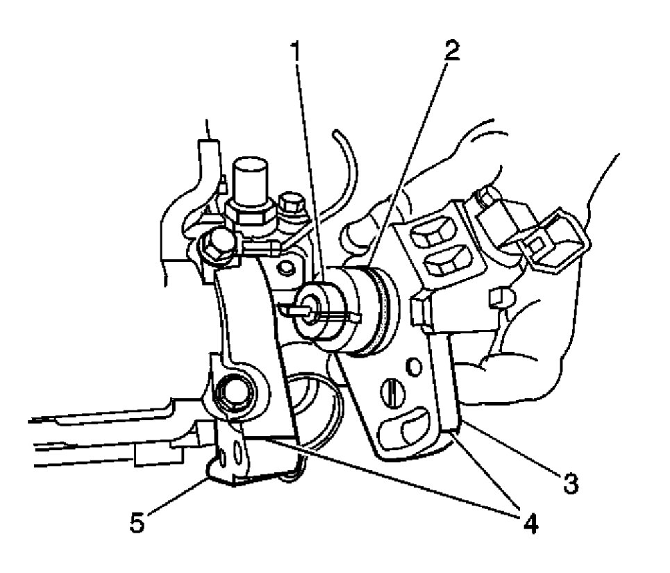

Is this the type of cam sensor you replaced? With an adjustable hold down bolt?

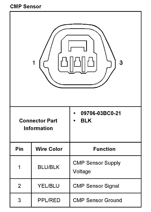

Here is the OEM wiring diagram for the camshaft position sensor. It is a hall effect type sensor, so it will have a 12v feed, a signal wire (going to ECM) and a sensor ground (also going to ECM). Also added is the connector pinout for the sensor. The Ignition timing is adjustable on this model according to service information, but to set base timing a scan tool is needed to turn On Fixed Spark parameter (meaning put the engine into base timing). And then adjust with a timing light to 5 degrees. I'm not sure why they don't have a manual way of setting base timing.

I replaced the sensor that goes into the one pictured above, the plastic one with the electrical connection, was just trying to see if it was the reason for the P0300 code I keep getting, random multiple misfires.
