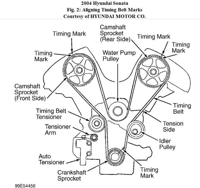

How does one go about setting the camshaft timing for a bank one and a bank 2?
Jan 13, 2018 at 12:56 AM
KHLOW2008
  • 41,812 POSTS
There are marks on the camshaft and crankshaft pulleys for you to note while installing the belt. Attached diagram gives and idea what it is about.

Hi leniepooh1,
The only possible reasons for the valves to be bent would be improper installation of the timing belts. this would result in the pistons hitting the valves causing them to bent.
Here are the timing belt marks so you can double check them
https://www.2carpros.com/diagrams/hyundai/sonata/2004
Let the mechanic knows that the problem is his to handle. There is a possibility he is not versed in this engine and the tension of the timing belt was not correctly adjusted. This can cause the timing belt to skip and cause the damage.

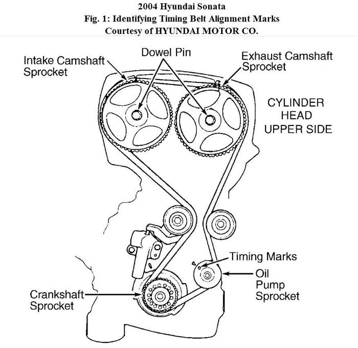

i replaced belt,i need information on timing marks.
Oct 27, 2020 at 9:08 AM (Merged)
KHLOW2008
  • 41,812 POSTS
I do not know which engine you have so here are 2 diagrams.
For 2.4, there is an additional balancer belt which has to be timed correctly.

i put a new timing belt and related parts in my 2004 sonata 2.4l motor, it starts but has a fludder sound with no power. i could not remove plug on side of motor. so i could not check the balance shaft position, however i did not remove the sprocket.does this still have to be done,
MHPAUTOS
  • 31,937 POSTS
You should ensure that balance shaft timing is correct and re check valve timing, was the belt changed for what reason, if it failed or you turned the engine with the belt off, you will have bent valves as it is an interferance engine.
