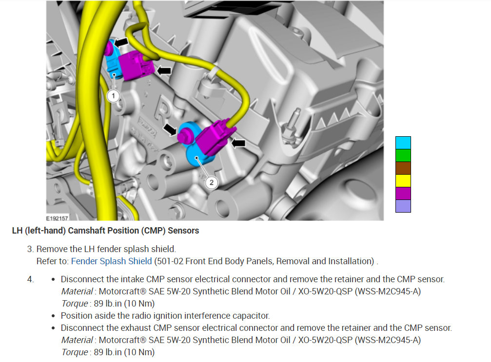

Cam position bank A number 1 sensor, how can I access it?
2016 FORD F-150
73,000 MILES • 5.0L • V8 • 4WD • AUTOMATIC
BBAHAM
I'm familiar with the location but I see two sensors located in the back near the firewall. Which one is the one I'm looking for? I'm questioning whether to go from the top or bottom. If the top, how can I do this safely and without damaging anything under the hood. If the bottom, how can I access this visible yet hard to reach space.
Feb 28, 2021 at 8:55 AM
  • 55,303 POSTS

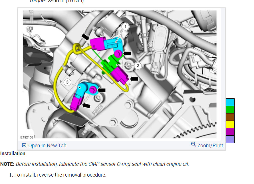

Bank 1 sensor is on the passenger's side toward the intake manifold. Here is a guide to help you step by step with instructions in the diagrams below to show you how on your car:
https://www.2carpros.com/articles/camshaft-angle-sensor-replacement
Mar 1, 2021 at 10:53 AM
