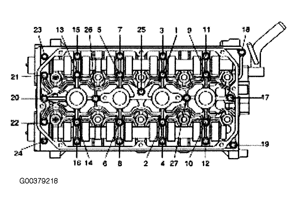

STEVE W.
  • 15,276 POSTS
Here is the camshaft hold down bolt torque specs and a video on how to use a torque wrench correctly 8.3 - 10.5 lb ft in the sequence shown.
https://youtu.be/juOClONIWeY
Thursday, February 2nd, 2017 AT 7:27 PM

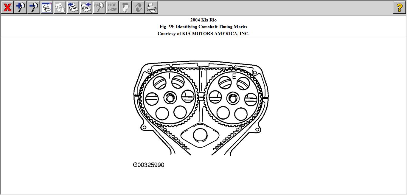

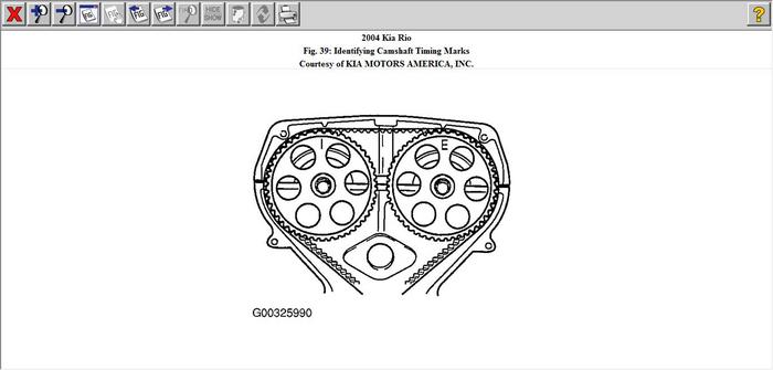

Cam positions for a kia rio 2004. I had my belt bust and bended all sixteen valves so I took it to the machine shop but they moved my cams around and I need to find out how to position them.
+1
Monday, February 11th, 2019 AT 7:02 PM (Merged)
  • 75,992 POSTS
Put the engine no.1 piston on its compression stroke/TDC-then align the cams-
+1
CORDON7071
Ok thanks but I need to know exactly to position the cams before placing the pulleys, here's the thing I took my heads to the machine shop so they moved my cams around and I don't want to place my heads back on the block and end up bending my valves again so I need the hole
8 miles in info here if you can help me.

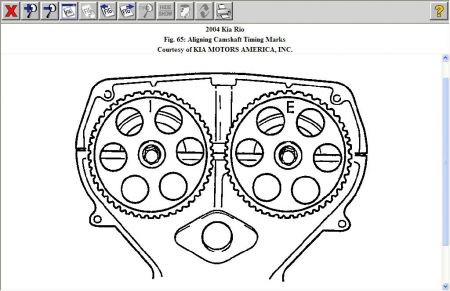

DEBSKUNK
  • 2004 KIA RIO
Engine Mechanical problem
2004 Kia Rio 4 cyl Front Wheel Drive Automatic
is the knock pin on cam at 12 oclock or 6 when installing cam pulley
+1
  • 75,992 POSTS
https://www.2carpros.com/forum/automotive_pictures/12900_cam_8.jpg

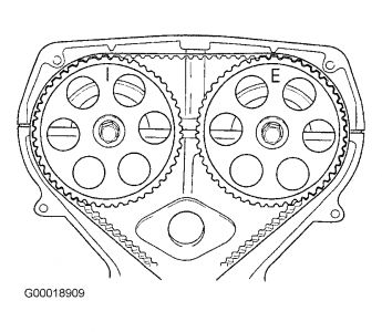

TALKSALOT2841
  • 2004 KIA RIO
2004 Kia Rio
On a 2004 Kia Reo 1.6 double cam, where do you set the exhaust cam?
+1
MHPAUTOS
  • 31,937 POSTS
Hi there,
Thank you for the donation,
See pic for cam alignment.
https://www.2carpros.com/forum/automotive_pictures/61395_Graphic_kia_1.jpg
mark (mhpautos)
+1
MHPAUTOS
  • 31,937 POSTS
The can gear will only fit on the cam in one position, I think that you will see that the dowel pin or key way will point up, just place the gear on and orientate the cam to the correct position using the timing mark (at 12 O'clock)
Mark
