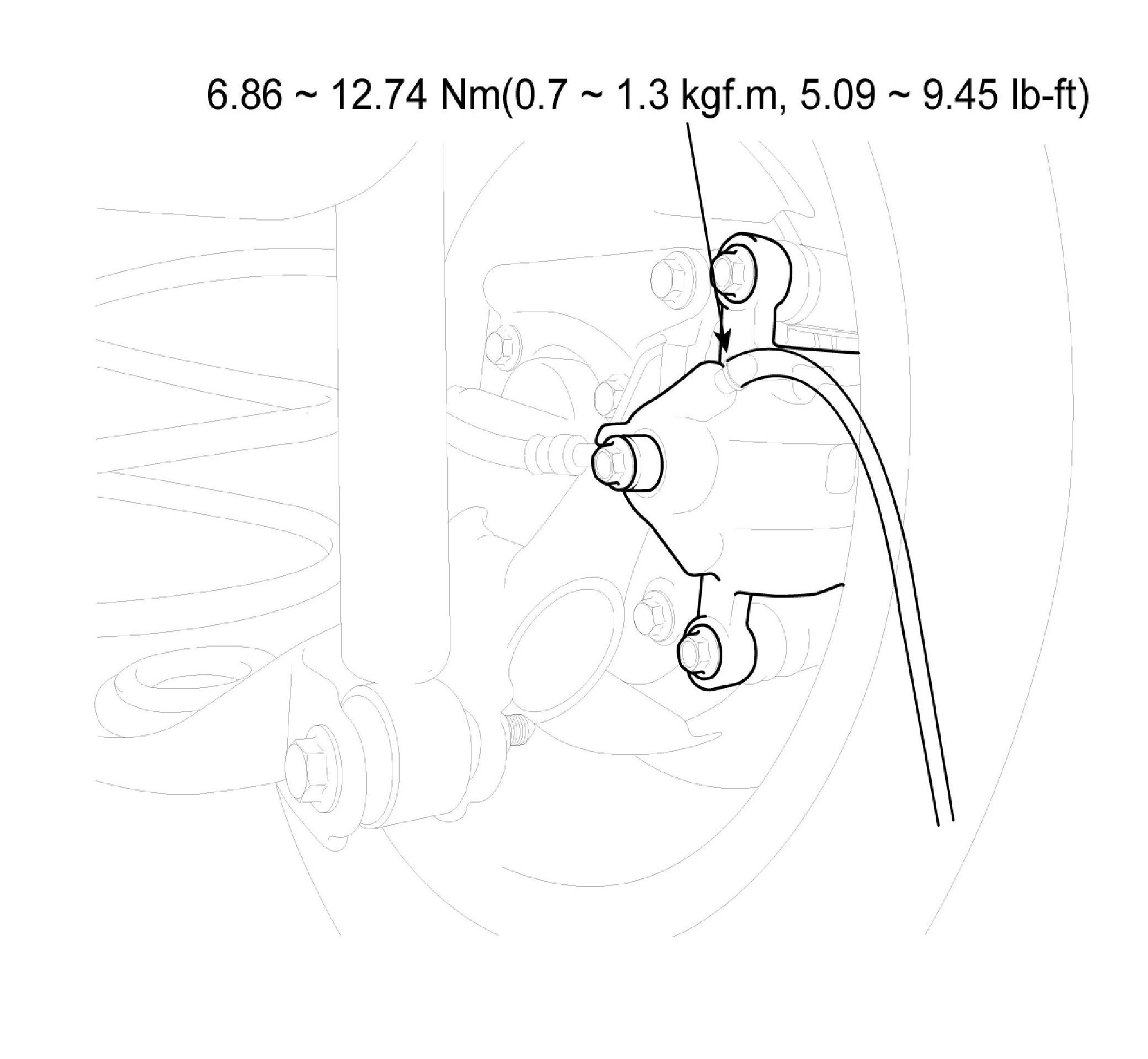

Disc brake jammed up again and again. if i release bleeder valve then it got free, but after one brake pedal it again got jammed up.
Dec 14, 2016 at 11:12 PM
  • 110,194 POSTS
You need to replace the rubber brake hose that is attached to the caliper. Over time, they deteriorate inside. When it happens, you can force fluid through them to actuate the brake, but when you release the brake pedal, there isn't enough force for the fluid to return. AS a result, the brake stays locked. Here is a video to help you step by step with instructions in the diagrams below to show you how on your car:

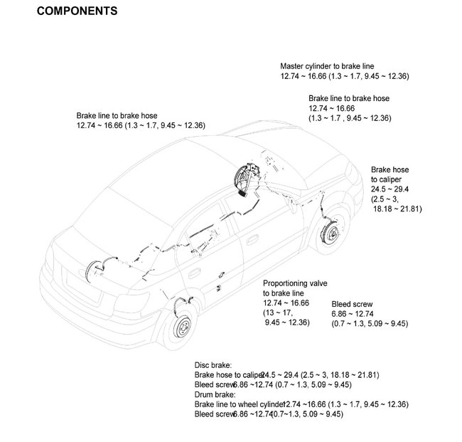

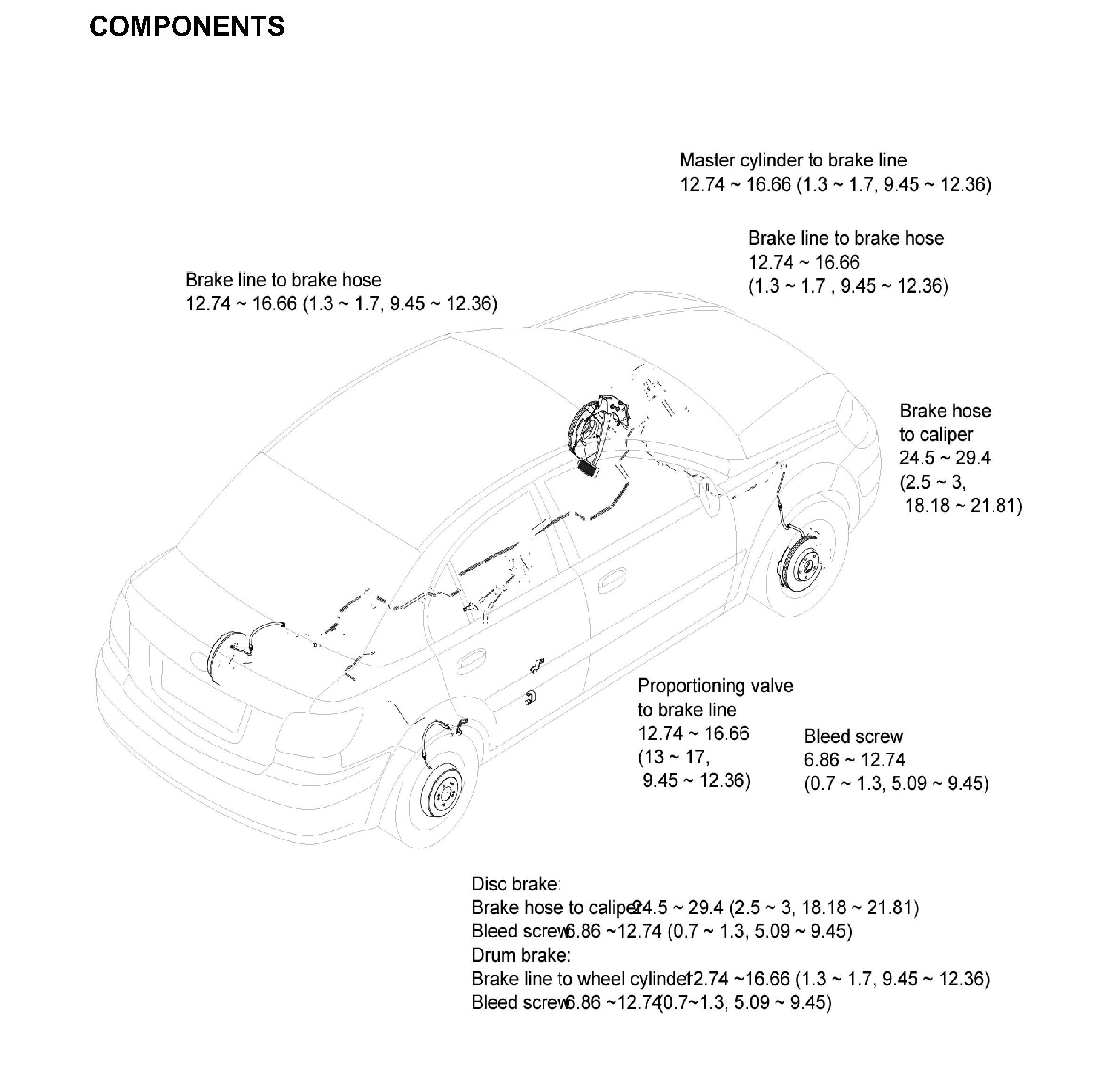

REMOVAL AND REPLACEMENT
COMPONENTS
COMPONENTS

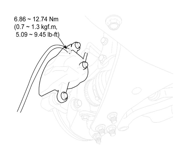

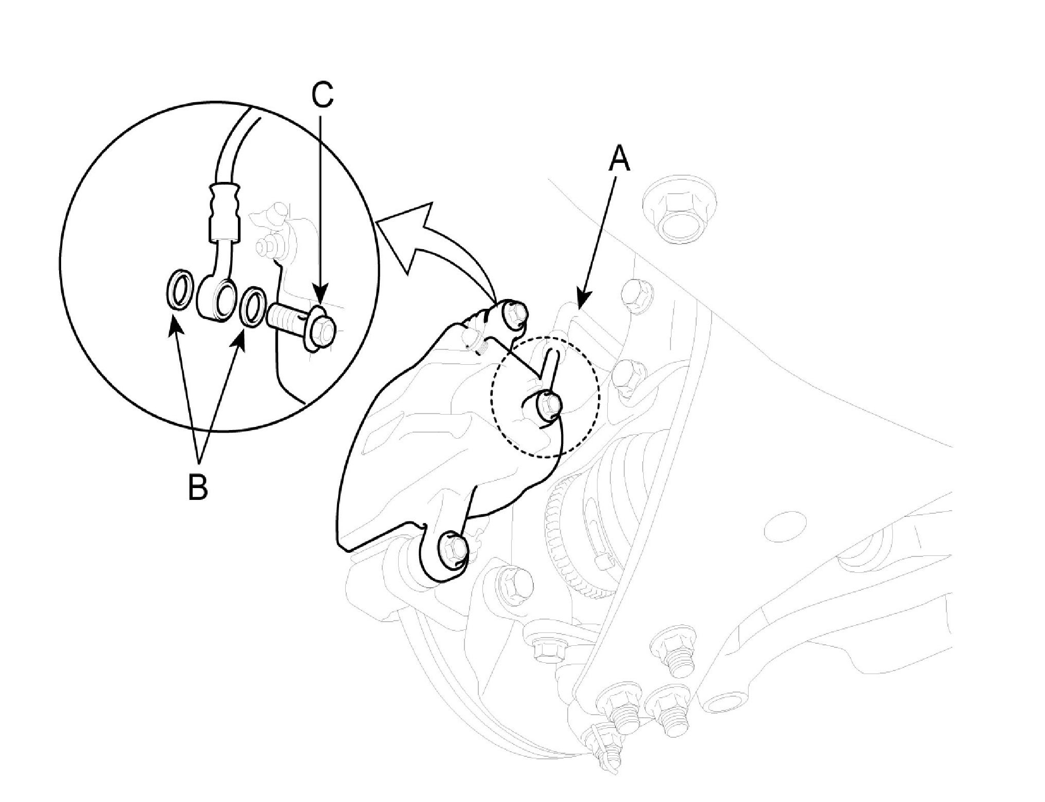

1. Install a brake hose (A) on the caliper with tightening brake hose bolt (C) and washer (B).

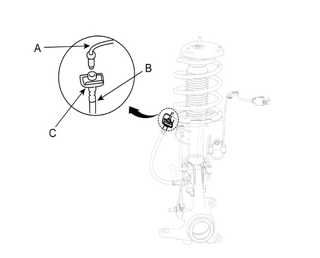

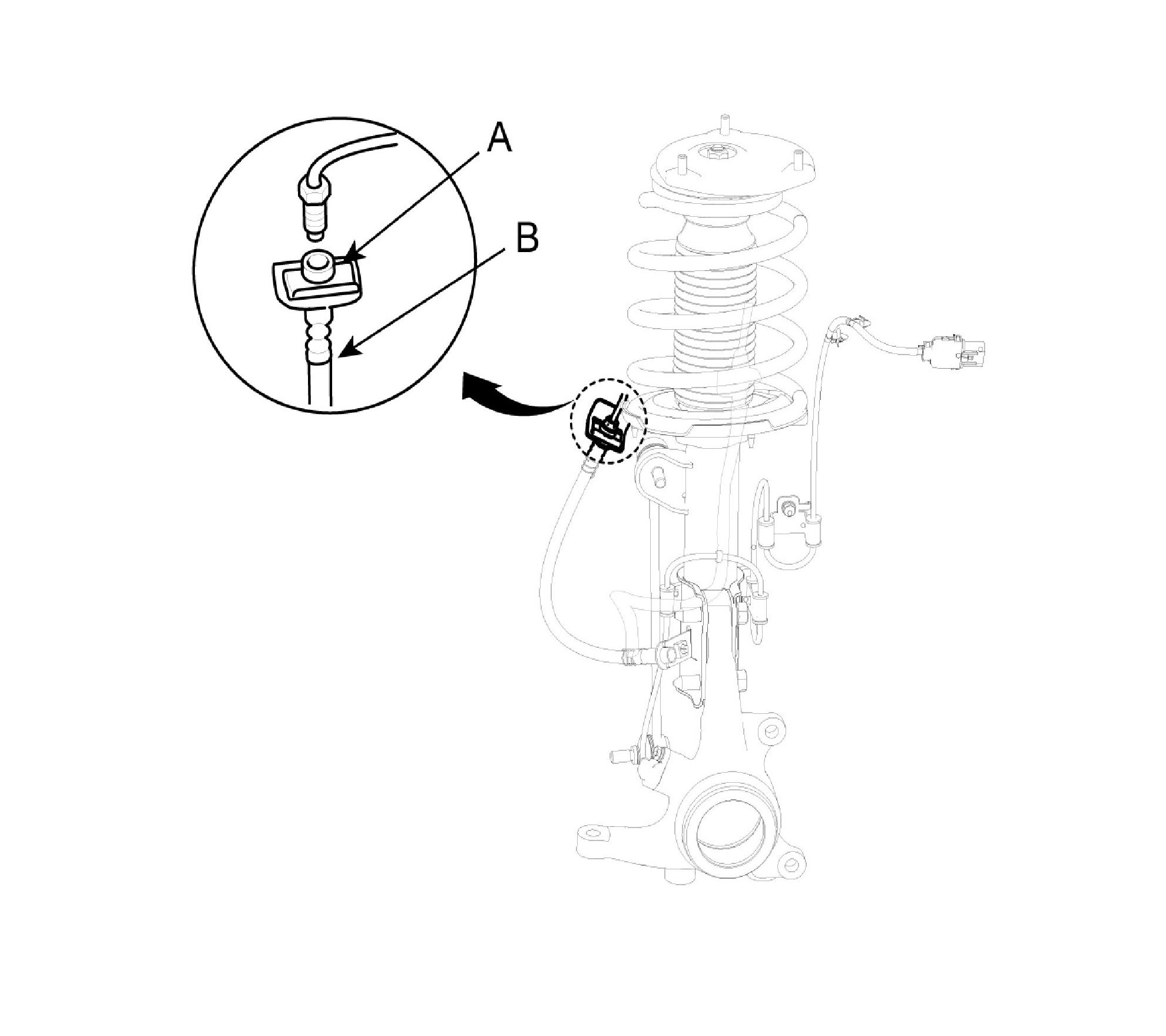

2. Install the brake hose clip (C) to the brake hose bracket (B), then install the brake hose (A).

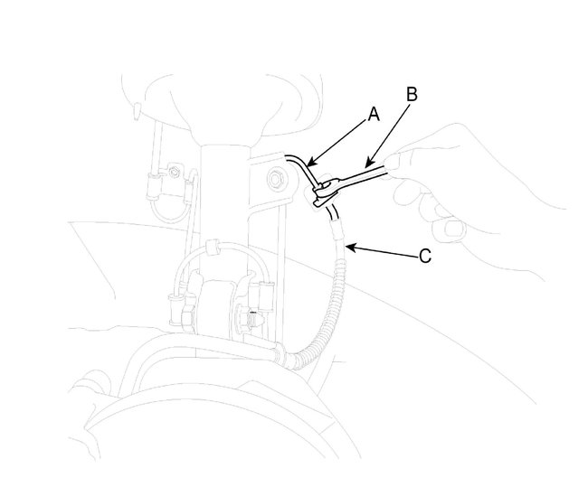

REMOVAL

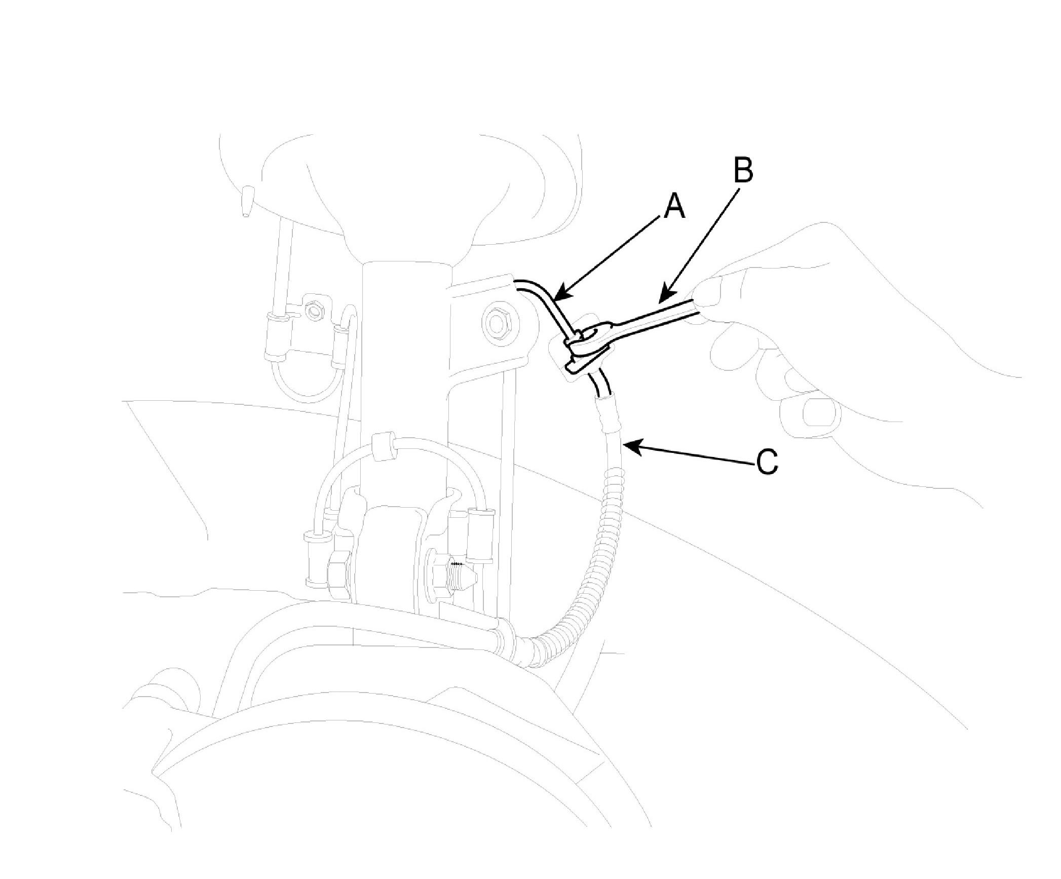

1. Disconnect the brake hose (C) from the brake line (A) using a flare-nut wrench (B).

2. Remove the brake hose clip (A), and then remove the brake hose (B).

3. Remove the connector bolt from the caliper, and disconnect the brake hose from the caliper.

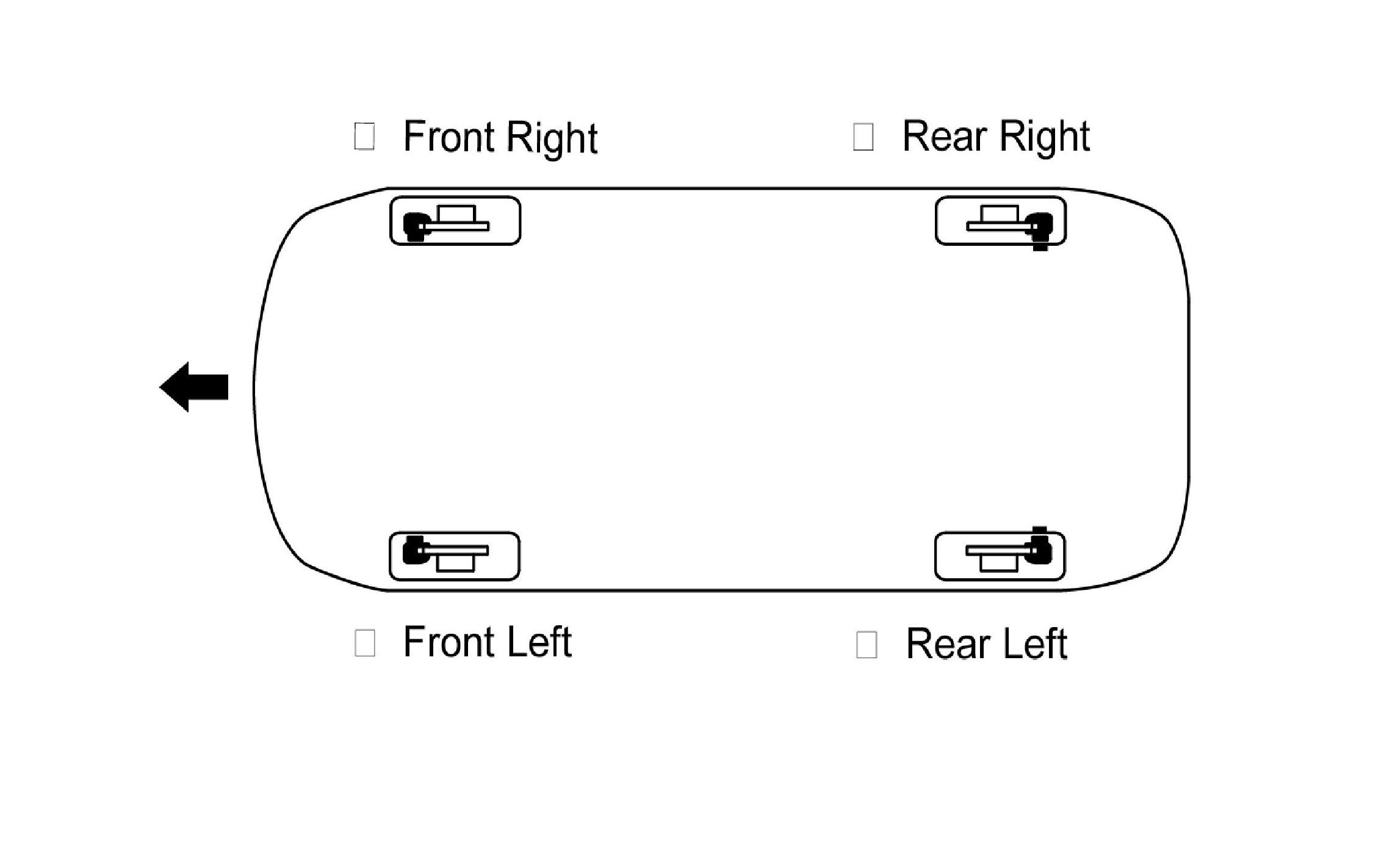

3. Loosen the right-rear brake bleed screw to allow air to escape from the system. Then tighten the bleed screw securely.

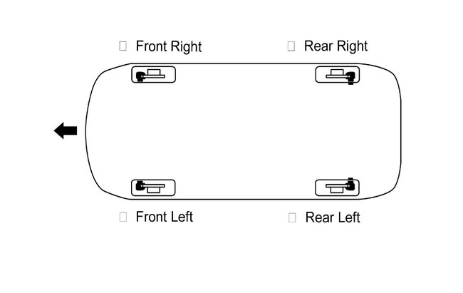

4. Repeat the procedure for each wheel in the sequence shown below until air bubbles no longer appear in the fluid.

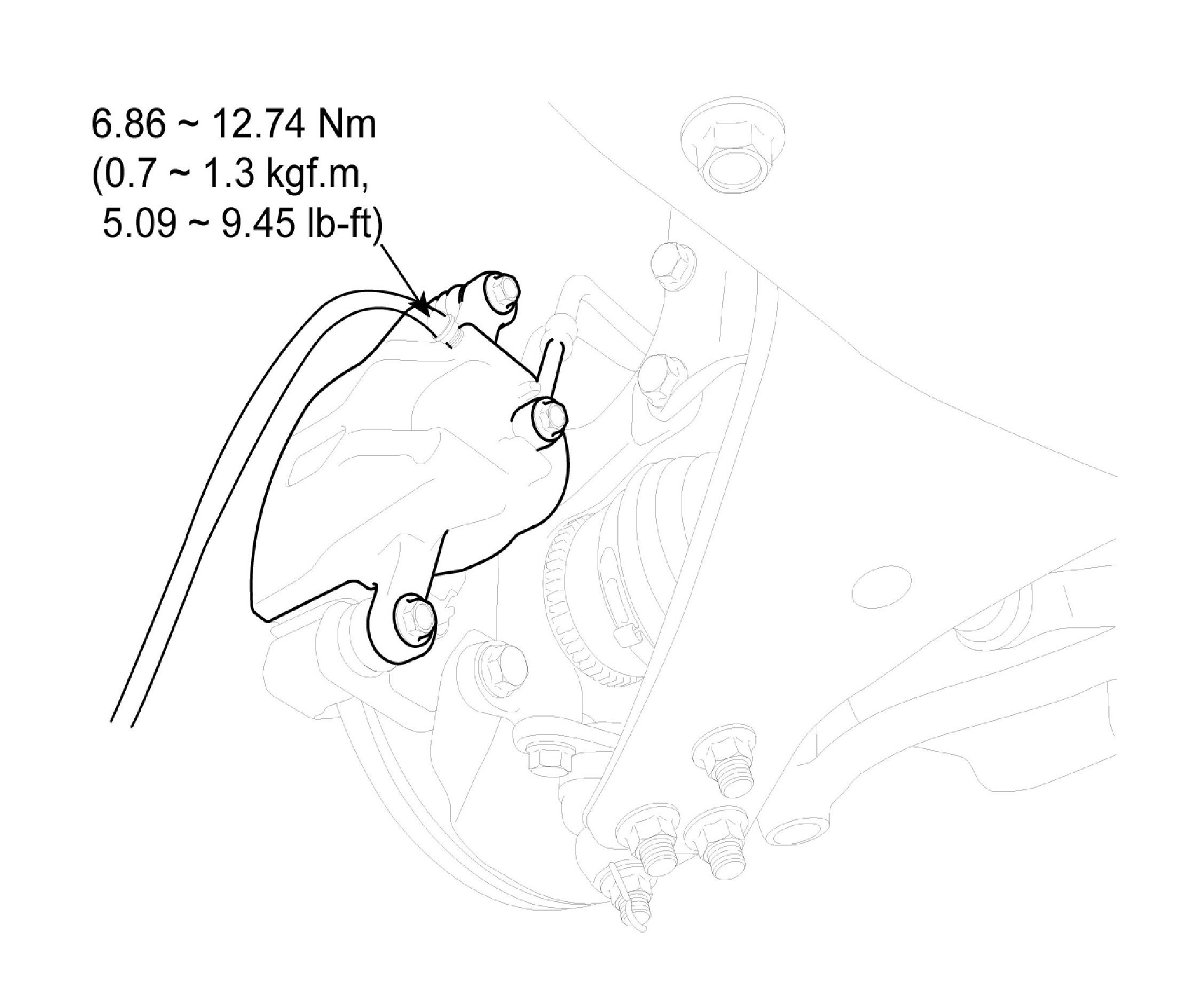

Front disc brake
