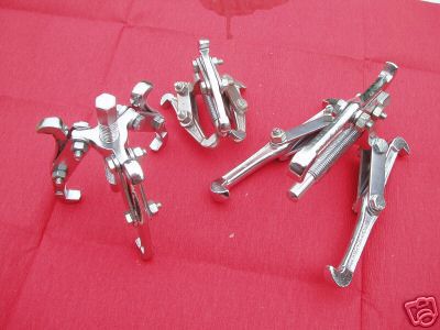

hi guys can u help me ?i took my wheels off today then took 4 bolts out the hub thing that covers the front of the brake disc the dics is now loose but won't come off because it looks like i need to take the split pin and axle nut off if i do that is there any wheel bearings in there i might damage and do i need any special tools to get that metal hub thing off so i can swap brake discs over to new ones [img:779d9eef64]http://www.2carpros.com/forum/automotive_pictures/175622_BA08321961_1.jpg[/img:779d9eef64]

yes there is a special tool to press off the hub. usually the parts store has loaner tools that you can use if you leave them a deposit. it bolts to the wheel studs and pushes on the axle after you take off the big nut. hope this helps

hi there do you not mean a hub puller that pulls the hub off and and it pushes against the centre of the axle ??is there wheel bearings on that part m8 ? all the tools i have is below but i dunno if thats what u mean i need lol

the puller looks similar but instead of 3 jaws it has three holes that bolt up to the wheel studs. yes there is a bearing there but the hub will press out of it. and yes you push on the axle.

[quote:40736753f9="mastertechtim"]the puller looks similar but instead of 3 jaws it has three holes that bolt up to the wheel studs. yes there is a bearing there but the hub will press out of it. and yes you push on the axle.[/quote:40736753f9]
lol u have me lost does it bolt up to wheel studs while the wheels is still on the car m8 ?

would this work draper 100mm - 115mm universal hub puller but its only a 2 hole one m8
