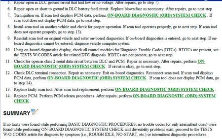

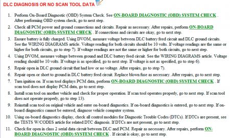

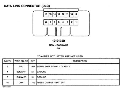

Pin # Description 4 Ground 2 serial data signal class 2 5 Ground 16 Power check for power at pin 16!
https://images.2carpros.com/forum/automotive_pictures/62217_DLC97_copy_1.jpg
https://images.2carpros.com/forum/automotive_pictures/62217_30961_mitchell_2_33.jpg

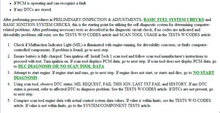

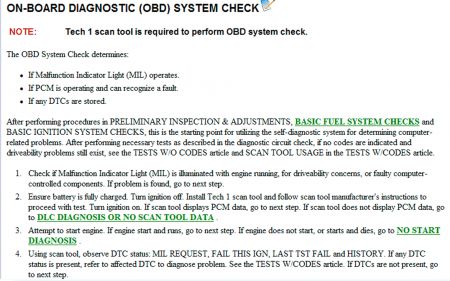

Her's a bit of testing ingo..
https://images.2carpros.com/forum/automotive_pictures/62217_Diag_copy_1.jpg
https://images.2carpros.com/forum/automotive_pictures/62217_Diag1_copy_1.jpg
https://images.2carpros.com/forum/automotive_pictures/62217_Diag2_copy_1.jpg
https://images.2carpros.com/forum/automotive_pictures/62217_Diag3_copy_1.jpg
You should be able to go to a good part store and by a remanufactered one. Try unplugging and replugging the connector first! Remove negative Battery cable first!
