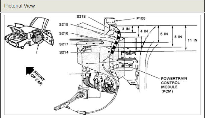

Engine Performance problem V8 Front Wheel Drive Automatic 100000 miles
I checked the computer dianogstic using the dianogstic control by pushing the off switch and the heat setter to scan for codes on a 1993 Cadillac Seville. The codes in which came up were P052 History, I052 History, No ACP, NO SIR and PCM. What does all this mean and how can I fix the problems.

I would start by checking all of the fuses by following this guide because it sounds like none of the computers are powering up.
If all the fuses are good I would think the ECM is bad and needs to be replaced.

I checked all of the fuses so I did what you said and replaced the ECM with a used unit and the car started with no issue, thanks for your help I love this site.
