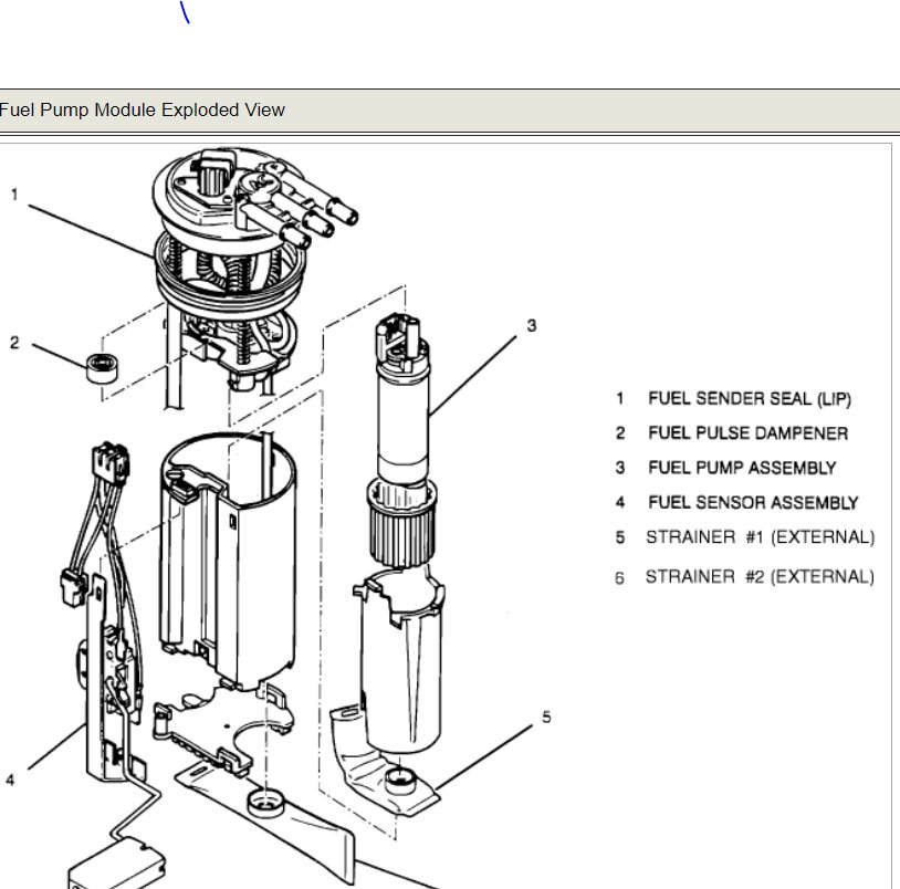

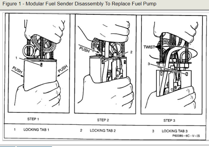

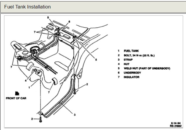

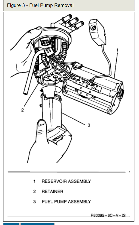

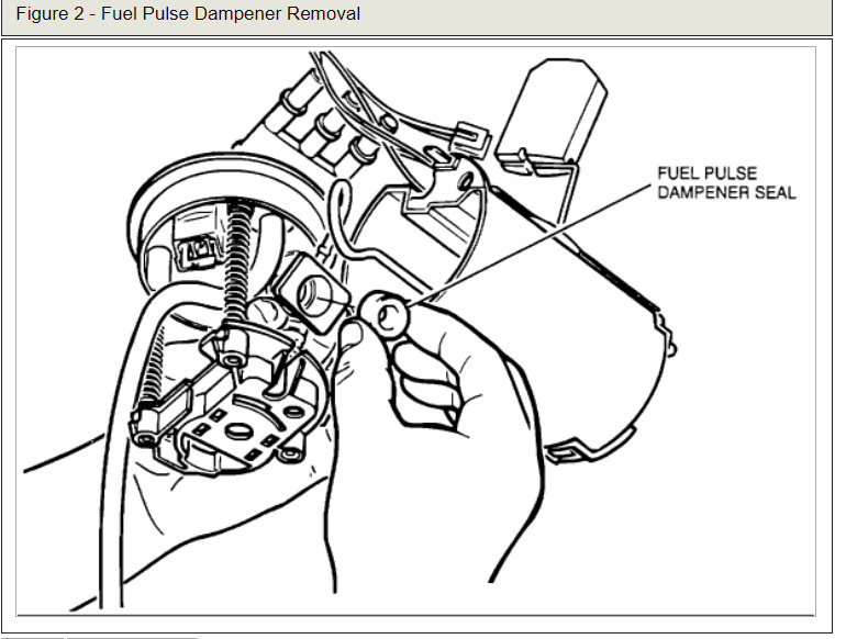

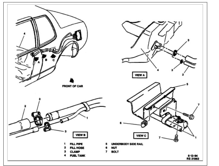

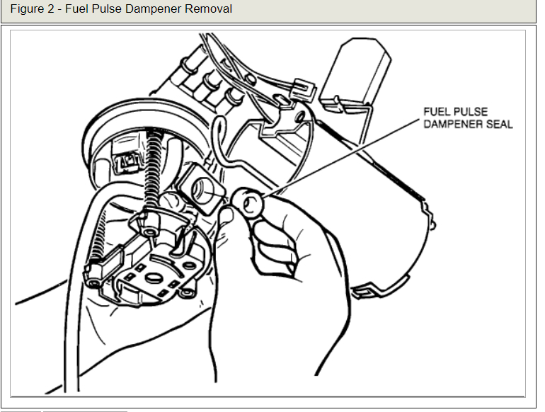

We have seen this problem before and replacing the fuel pump fixes it. Here is a guide to help you see what you are in for when doing the job a diagrams to help you see what it will be like on your car. You can get the pump from Amazon.
https://www.2carpros.com/articles/how-to-replace-an-electric-fuel-pump
