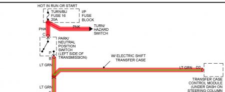

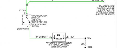

After the vehicle has been placed in the park position, the vehicle cannot be shifted out of park without several attempts to force the shifter in a downward movement.
Where is the automatic shift lockcontrol solenoid and what does it look like and is it simple to replace?
