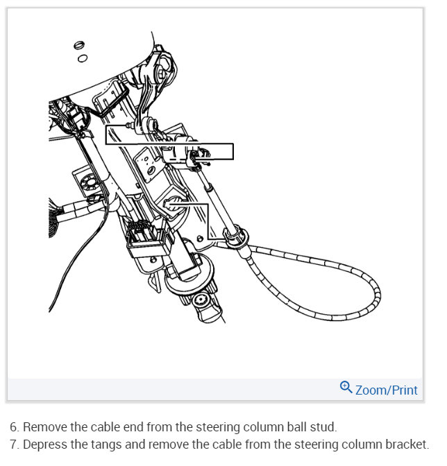

My daughter is in Ohio with her children. Her car will not go into Park! Please help.
Apr 17, 2010 at 11:00 AM
FACTORYJACK
Experienced Mechanic
4,159 POSTS

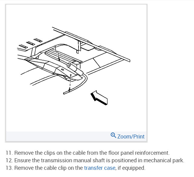

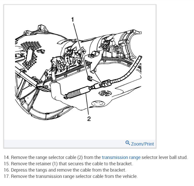

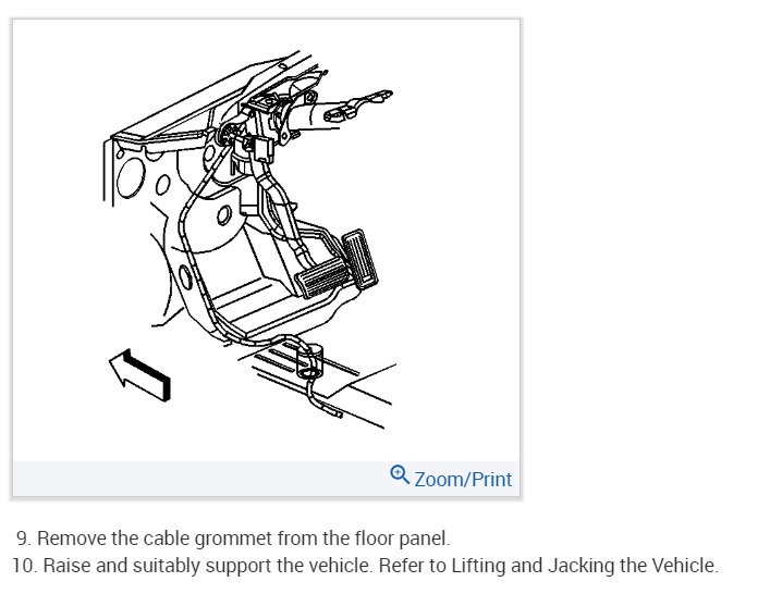

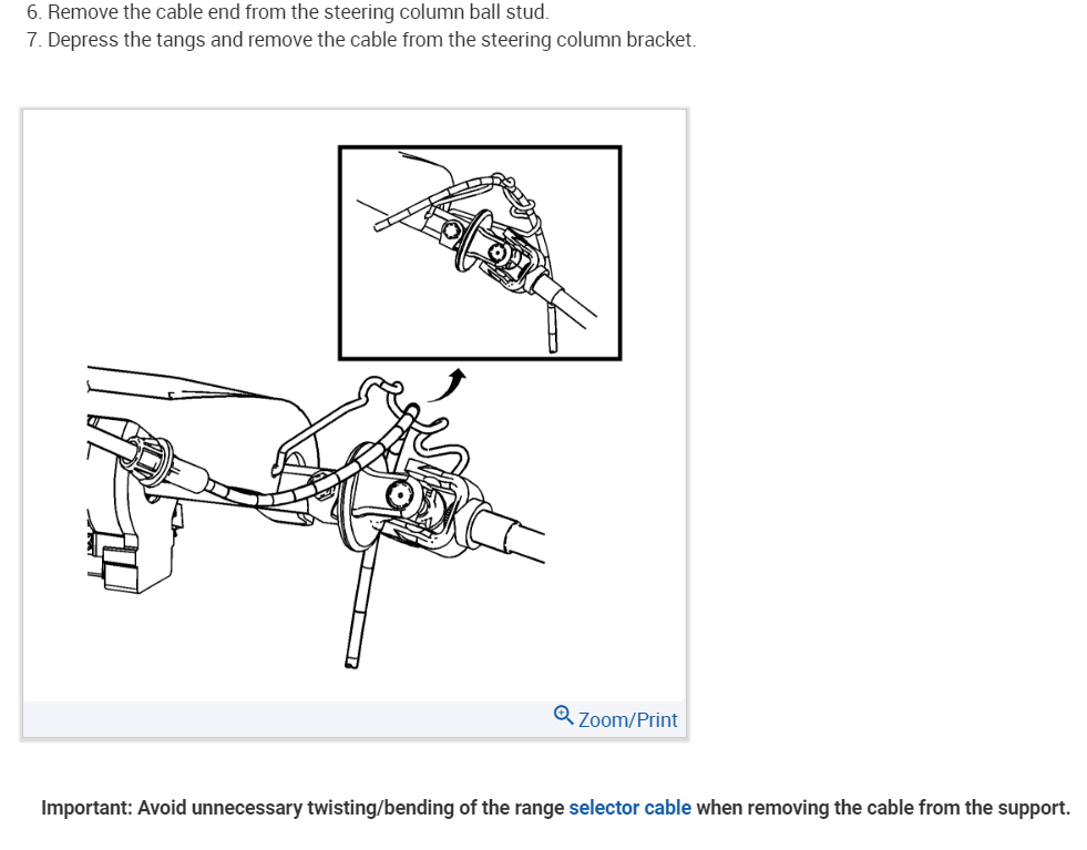

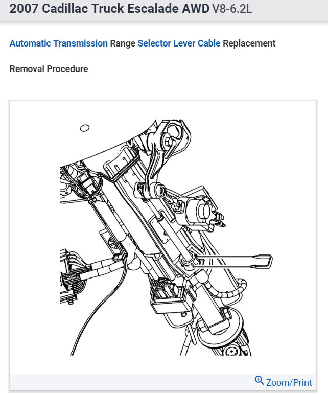

This happens when the shifter cable breaks internally and needs to be replaced here is a guide to help you see what you are in for when doing the job.
PN# 19177019 $51.17
