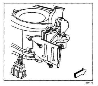

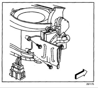

I am in the middle of replacing a blower motor on a 2002 cadillac deville it is a 1st design. I have the old one out, which did not come easy, I am have serious trouble getting the new one in due to the tight space, I can not seem to figure out the trick to getting this in without damaging it. Please Help!!
Jan 12, 2010 at 11:31 PM
  • 75,992 POSTS
REMOVAL PROCEDURE
https://images.2carpros.com/forum/automotive_pictures/12900_blower1_8.jpg
1.Remove the right side sound insulator. 2.Pull back the carpet near the blower motor. 3.Remove the IP compartment. 4.Remove the dash integration module from the bracket. 5.Remove the two rear dash integration module bracket fasteners. 6.Reposition the dash integration module bracket in order to remove the blower motor.
https://images.2carpros.com/forum/automotive_pictures/12900_blower2_9.jpg

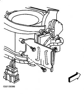

7.Disconnect the electrical connector (2) from the blower motor. 8.Remove the blower motor retaining fasteners (1). 9.Rotate and remove the blower motor from the vehicle. INSTALLATION PROCEDURE
https://images.2carpros.com/forum/automotive_pictures/12900_blower3_3.jpg

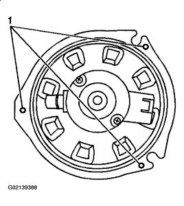

*Rotate the blower motor in order to install the blower motor into the housing. 1.Install the blower motor into the blower motor housing. 2.Ensure that the blower motor gasket is properly aligned. NOTE: Refer to Fastener Notice in Service Precautions. 3.Install the blower motor retaining screws (1). Tighten Tighten the screws to 1.4 N.m (12 lb in ). 4.Connect the electrical connector (2) to the blower motor.
https://images.2carpros.com/forum/automotive_pictures/12900_blower4_1.jpg
5.Reposition the dash integration module bracket to its original position. 6.Install the 2 rear dash integration module bracket fasteners. 7.Install the dash integration module. 8.Install the IP compartment. 9.Reposition the carpet. 10.Install the right side sound insulator.

No matter how I twist or angle to get it in it seams impossible. Is there a good way you could describe how to do that.

Does anyone have a magic formula for removing the blower motor? I know where it is and have access to it but I cannot get the thing out. What does it take to get the thing out ?

Remove insulation, glove box and DIM module and bracket that will give room for blower to come out.

I have done all that but it will not come out. I rotated it as much as I could which is about 10 degrees but it will not come out. Do you have to remove the rubber covered insulation under floor carpet? It seems to be binding on that rubber covered insulation.

Yes carpet must be pulled back sorry left that step out

I have the carpet pulled back and it still does not rotate enough to get it out. It hangs up on the rubber covered insulation under the carpet. This rubber covered insulation extends up the firewall. Does this black rubber covered insulation have to be removed? How many degrees does it have to be rotated and in what direction?

No rotate to move frame away from fire wall blower cage will hang up so tip motor away from firewall while rotating

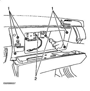

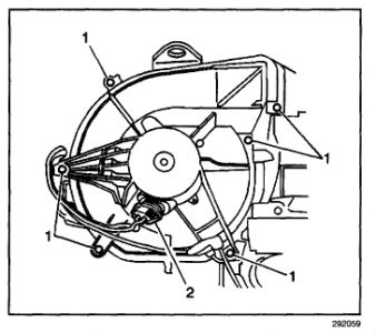

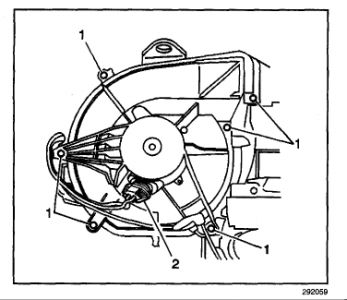

Found some pics that may help seems in 2003 GM made change and added removal of glove box
https://images.2carpros.com/forum/automotive_pictures/198357_Grafic_4_28.jpg
https://images.2carpros.com/forum/automotive_pictures/198357_Graphic_429.jpg
https://images.2carpros.com/forum/automotive_pictures/198357_Grafic_3_117.jpg

Yes, it was a major PITA but I got it out and the new one in. Only have to remove the silencer panel but I pulled glove box as well. The trick was I had to cut some of the rubber insulation away on the back end. I used a utility knife. That is where it was hanging up. Once I did that I was able to squeeze it into place. The screw in the back is a pain as well. New one on amazon was $75.00. Plan on spending a good hour or two and a sore back afterwards.

2001 Deville, I have the original blower motor out but can’t figure out the angle to get the new one in. Anyone have any advice?

As stated in previous responses, I would pull back the carpet and the insulation on the floor. That should give you enough room to install the motor housing.
