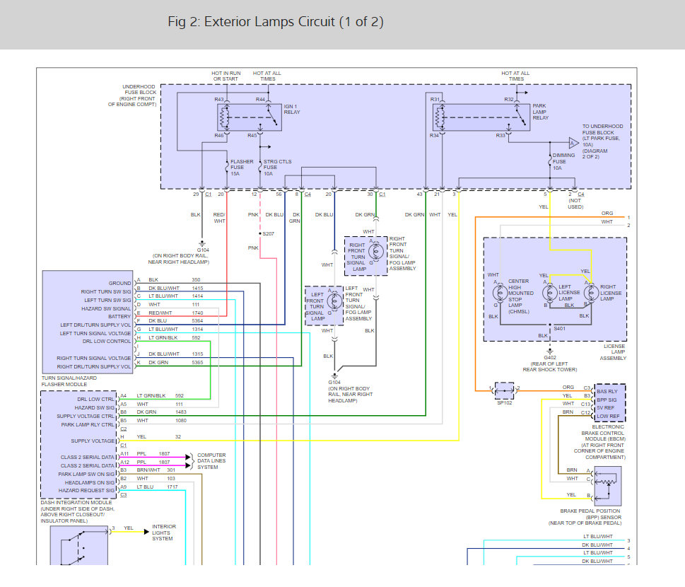

Left & right brake lights don't work. Center light does. Bulbs and fuses check out OK, what else could be the problem? The turn signal lights are actually the yellow light below the red section of the tail lamp. They work just fine. When the driving lights are on the tail lamps light one of the two filaments. The 3rd light also works. Any other thoughts?
Thanks, Kevin
Sep 29, 2008 at 1:58 PM
2CARPRO JACK
  • 11,533 POSTS

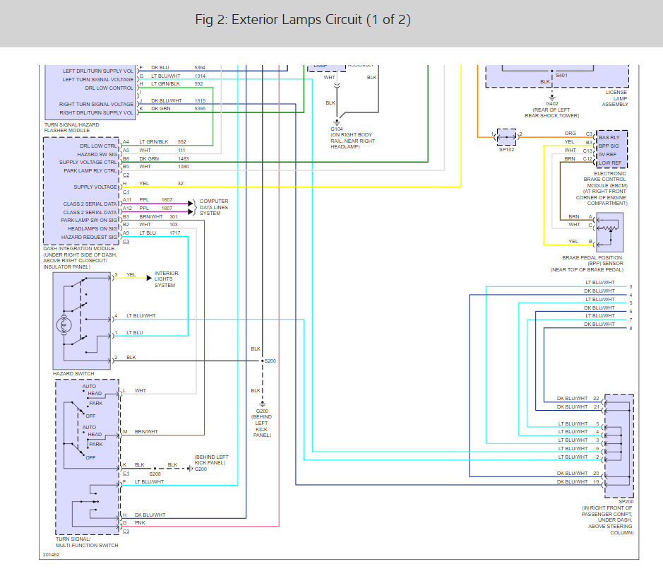

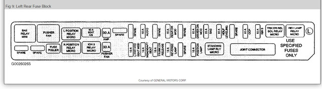

It looks like the brake lights go through the ABS controller here is the wiring diagram so you can look how the system works. The BAS relay could be out as well here is a guide to help you test the relay
and to check the BAS fuse 15 amp in the rear of the car
Check out the diagrams (Below) Please let us know what you find. We are interested to see what it is.

With the car started and the driving lights on, there is no power to the white wires that enter the light sockets...
Sep 29, 2008 at 4:22 PM
2CARPRO JACK
  • 11,533 POSTS
Need to check with someone pressing on brake pedal. It sounds like the module is bad here is a guide to help you see what you are in for when doing the job.
https://www.2carpros.com/articles/how-to-replace-a-abs-controller
Cheers
Sep 29, 2008 at 4:40 PM
KYARBOUGH
Yep that was it I found the power was going in but not coming out. I got the part on Amazon for $149.99 put it on myself. Thanks for the tip I love this site.

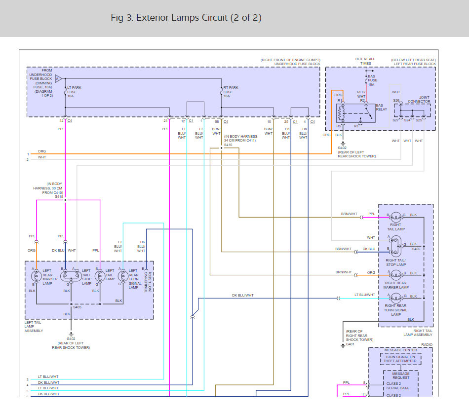

THB, is your high mount working as well? Looking at my schematic from GM service information, the white wire comes from the BAS relay and hits a splice pack(or joint connector), that is part of the rear LH fuse block under the seat cushion. From this joint connector, the three powers for the lights exit. The only possible way that both rear bulbs don't brake, but the high mount does, is if there is a fault with that joint connector, C410 for left light AND C411 right both pins b, or the individual right and left sockets. The left and high mount share ground G402, and the right uses G401. If nothing works, then yes, it could be the BCM.

2 boxes under rear seat checked..all relays, fuses, everything checks good.

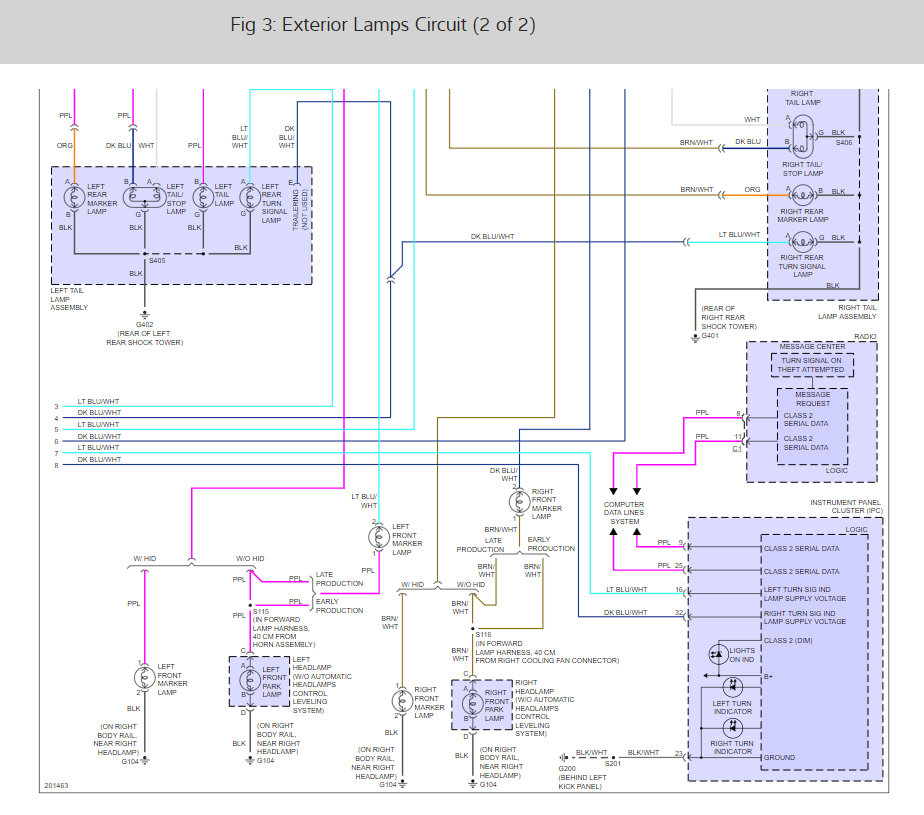

Look at the schematic I have included. If the high mount works, it verifies that the switch, relay, and at least one ground are good. You say the bulbs 'checked' good. Was this check done by just looking at the filaments? Often times it is not the filament that is open. Before you spend much more time pulling your hair out, try some known good bulbs. You may be surprised. If bulbs still don't correct the concern, then look for power getting to the sockets, as well as ground. If you have power, ground, and known good bulbs still provide no stoplamps, you have faulty sockets. Two sockets to be failed, would be rare. Two bulbs failed is more probable. The only module in play is the ABS module(EBCM). If there was a problem there, causing no BAS relay activity, you would have no brake lights at all, and more than likely no cruise. I'm betting you have two bad bulbs.

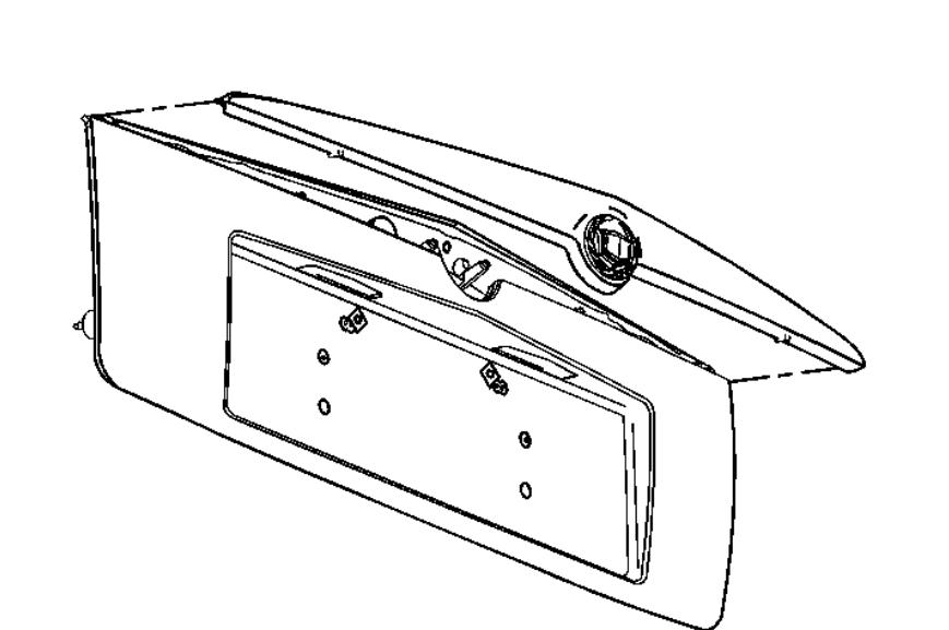

check fuses underhood for headlights and check bulbs for third light. the pic shows the part that has to be removed to gain access to light bulbs.

Thanks for the schematic.
Bulbs checked out = new bulbs were installed.
A new switch has been ordered and we'll see if that corrects the problem.
The cruise control does work at the moment...whether or not it's "touchy", I don't know. The wife says it feels the same to her but I'm not able to check that at the moment.
I will be forwarding the attached schematic to the Body shop...it may help when they change the switch.
